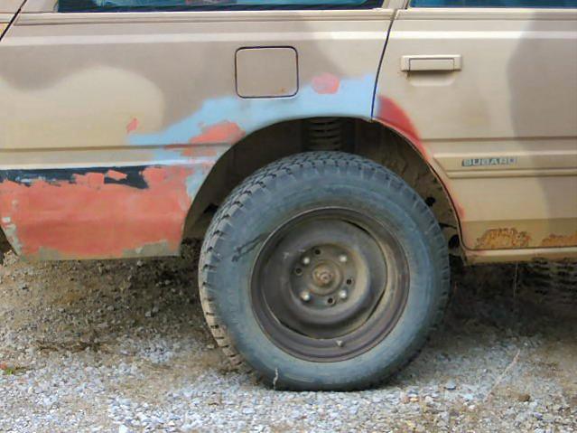

i trimmed just about an inch to get 215 60 15 /s under . without a lift, the shocks were on the highest peg
[ATTACH][/ATTACH]
