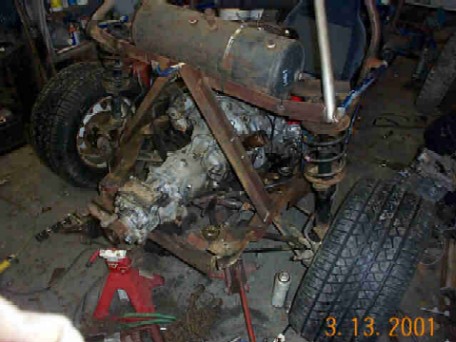

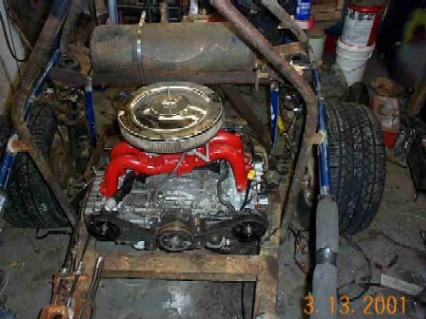

January 26, 200422 yr I made something like that, only difference is i used a built ej25 making 200+hp mated to an EA 5 speed 4x4 trans. It lasted about a summer of insane abuse before it pounded the rod bearings to hell. Now the cart is powered by a WEAK 118hp fuel injected EJ18. It wont pull wheelies in second anymore:D
January 26, 200422 yr Author thanks for the help. Mine is going to look something like that. Did you make the front suspension rigid or not?

January 27, 200422 yr Ya thats what i used, the complete shifter assembly and cables out of a little econ box car. You will also need some creative linkages:D
January 27, 200422 yr you have too much time on your hands country boy... what was done to the EJ25 to squeeze 200 out of it?
January 27, 200422 yr Phase I EJ25 block with smaller chamber EJ22 heads, P&P, Phase II ej25 head gaskets. Compression around 12:1 Carter 4bbl jetted for the 2.5l also custom advance in the distributor. No rev limiter. I would say around 200hp, no way to tell for sure but it was fast.
