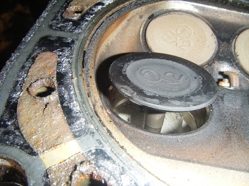

July 22, 200916 yr First some background, 97 Legacy w/2.2. Last year I swapped in a 2.2 out of 96 from the junkyard. Last week she stopped running and I found out that the bottom idler bearing were shot and the cam belt was way off. I got another idler, timing belt and went to set the timing. I could line up the passenger cam at 12:00, but I couldn't get the crank and driver's side cam to line up, there was a definite contact that was preventing the cam from turning to 12 when the drivers cam was at 12. I assumed there was a valve sticking, so I decide to swap in a set of heads I had at home. Once I get the heads off, I can tell that there was contact with the intake valves and the pistons. I get the "new" heads on and they act the same way. I still can't get the crank and the cam to both line up at 12:00. Some pics; While I had the heads off I confirmed that the front pistons were at TDC while the crank mark was at 12:00. More pics can be found here; Why can I not line up everything properly?? Any thoughts? I didn't think to measure while the heads were off, should the pistons be flush with the cylinder walls?

July 22, 200916 yr Author Dave is quite well versed in subarus, it is highly unlikely he is using the wrong marks. Not sure what the deal is. You swapped heads but retained cams? Is it possible something is wrong with the cam itself? Doesn't make sense but I don't know what else to make of this. If it's only appearing to be one piston/cylinder then I'd begin to expect somethign other than the block...heads replaced....so i'm tempted to look at the cams, though I can't suggest what to look for. Maybe you have another cam you can throw in it to test? Timing belt is the right one? No I swapped the entire heads. Including the cam wheels. There are marks on all 4 pistons. With the heads off the valves don't appear bent, they open and close evenly. I'm wondering if the engine that I swapped in had the block shaved or different pistons put in?? If so they would have had to have the timing set differently?? I know it seems odd, but I don't have any other ideas? Edited July 22, 200916 yr by Hocrest

July 26, 200916 yr Author OK, I'm an idiot... This post; Are you using the correct mark on the Crank pulley? The Keyway should be straight down at TDC, and the little mark on the ear on the cran k pulley. and a review of the Haynes manual instead of the FSM showed that I need to line it up to the dot on the crank pulley and not the arrow... I've done the timing many more times on the SVX than I have on the Legacy, and on the EG33, you use the arrow... Reviewing this thread now, I did see another post about using the dot and not the arrow... Thanks for all the help.
