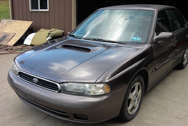

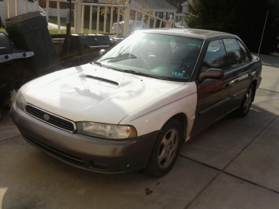

i ended up doing a light sand and clear coat over the fender and hood, thanks guys. ended up using NAPA auto paint mixed in an aerosol can and then an actual 2 stage clear coat i bought from an online place. you mix it onsite and spray it aerosol style. if i'm lucky the two stage i think should last for awhile and not have to worry about it. it's a daily driver we just beat around in and i don't care much about it. glad i've hit three deer with it and none of the other soobs that i like.
drove it today. doesn't match, is far from perfect but does the trick, WAAAY better than two tone brown and white, i don't care what my cars look like but that's not what i'm after either. :lol:
hit a deer, replaced fender and hood. before and after pic's attached.

Posted 19 October 2010 - 12:44 PM
Looks pretty doggone good, Gary. Nice job!

thanks, i appreciated the help from here and subaruxt.com, this is the kind of stuff i dislike and am not good at. and there's tons of varying info on the internet. i figured this might help the next guy like me that wants to try this. it was easier than i thought in some ways, but time consuming too, the prep work. i think i'll do my own rust repair and small stuff but in the future will probably have more paint work done by someone else than me. good learning experience.
one recommendation - don't spray without a shirt on....well at least not if your chest and back have hair, it falls right on the paint. :lol: :lol:
