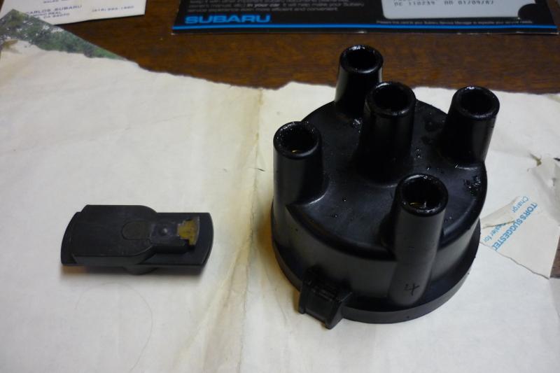

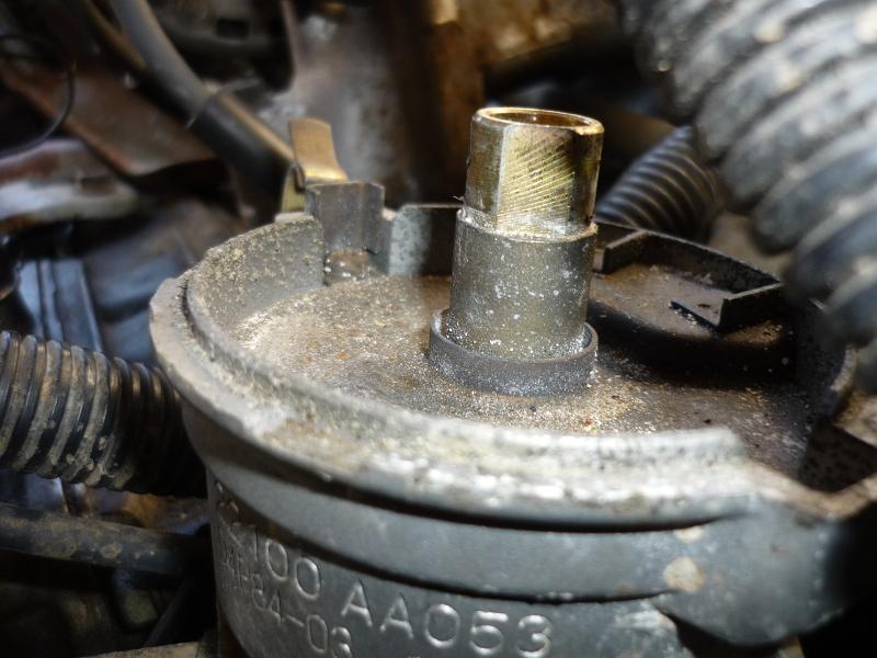

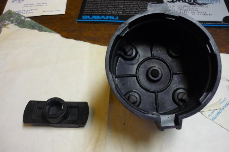

From what I can tell, it's the original motor, I found just about every receipt since 87 in the glovebox and can't find any info indicating otherwise...
But there is nothing that indicates SPFI, except that all engine components and electrical wiring look to be original. Well, minus the AC and power steering which I removed...
http://en.wikibooks....cation_Numbers_(VIN_codes)/Subaru/VIN_Codes
JF2 - fuji Heavy industries MPV
A - DL/GL/GL-10/Leone/Loyale/Alcyone XT/XT6
N - 85-94 3rd. gen Leone/DL/GL/GL-10/Loyale wagon
5 - 1800cc 4WD w/out air susp - 1988, 1989; 1800cc 4WD 1990-94 2000cc 2004-
3 - L (model)
B - Class B (GVWR 3001-4000 lbs.)
7 - check digit
H - model year?
E - plant and transmission type, there is no E in the list! hmm
426719 - production sequence
From what I can tell, this is a factory EA82 SPFI 5MT D/R GL Wagon (with PermaPlate!)
coil has two wires to a round connector and two wires to a rectangular connector.
here's some pics:
Attached File  OriginalParts87GL.JPG   93.28K   43 downloads
Attached File  PermaPlate87GL.JPG   96.8K   67 downloads
Attached File  P1010006.JPG   34.73K   66 downloads
Attached File  P1010007.JPG   40.39K   45 downloads

# stamped into the disty housing would make this easy.
Probably 22100 AA053(early) or AA440(late)
SPI distys will not have a vacuum advance.
87 SPIs used 2 different distys.
87s built up to dec 86 use the clip type cap.Build date is in the door jamb.
If it is SPI,you have the early style 22100 AA053 disty and require a 22162 AA020 cap and a 22157 AA000 rotor (or the aftermarket equivelents)
If it is eating caps quickly,I would be looking at disty shaft endplay and sideplay

Thanks naru,
its a 2210 AA053 distributor,
the car was mfg. 11/86
no sideplay in the shaft but there is about a mm of endplay. I was told this is normal but I can see how it would cause the center post erosion. Is the only solution a new distributor?
guess I'll check my parts motor for a replacement
Oh also I found some matching parts at NAPA, the right cap but the rotor they had uses a set screw instead of a flat spot to hold it on the shaft and the screw was missing from the box... my distributor shaft has a threaded hole in the right spot so I guess I can use that type of rotor as well?
thanks again

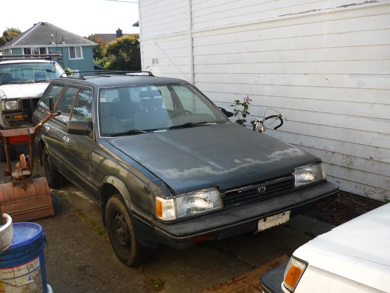

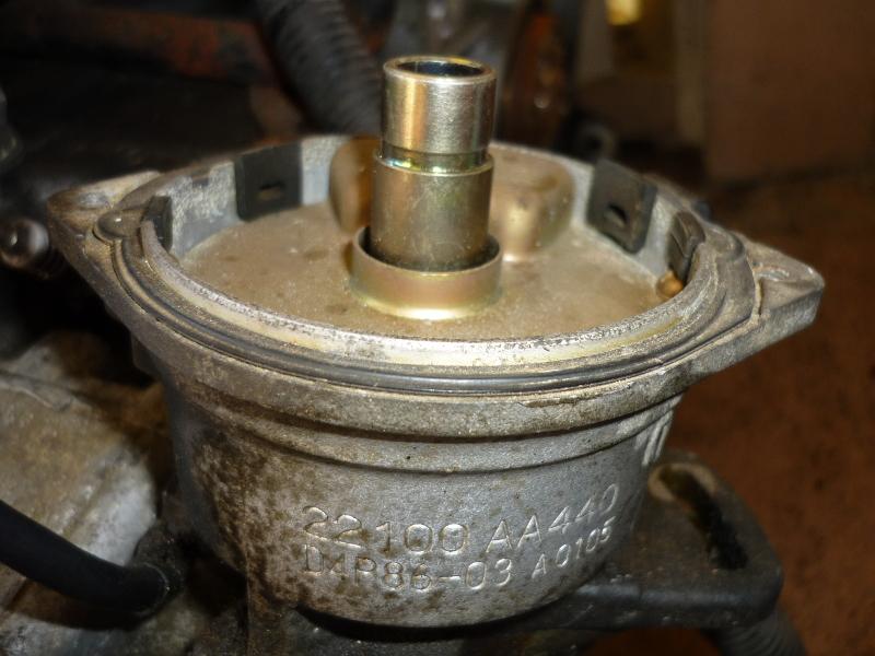

OK, well I have to bring this up again, sorry to be an amateur but I'm not so great with electrical issues... I kind of gave up on the car for a while due to more pressing issues in life, and I've now returned to it finding that my problem is the car will start and run fine (at least as well as I'd expect) for a little bit, then it might start missing and die or just die suddenly. if I try to start it again, the motor cranks but won't start. when the key is in the "run" position after the motor dies,  I can hear what I think is the fuel pump relay coming on somewhat erratically under the dash; under the hood I can hear the injector at the same time, and I can smell gas.
as aforementioned I have had issues with my distributor cap and rotor, leading me to believe they might be the wrong ones for the distributor. also there is a tiny bit of play in the distributor shaft but really seems not enough to be causing this problem. The rotor I had been using is able to shift side to side easily so I think that could be throwing off the timing as it spins. I tried using the screw type rotor but it still ran the same, and I can't be sure if the cap I'm using is correct.  I have checked the coil and its resistances are acceptable, the coil and plug wires have OK resistance, the fusible links look good, I could go through the grounds some more, but they seem fine.
I have a spare ignition coil, but no extra power transistor and I couldn't figure out how I should test the transistor to see if it is functioning properly. I have a spare distributor but it is a 22100 AA440 and I have the rotor, but no cap. what are the correct cap and rotor part numbers for the  22100 AA440 distributor?
anyway, I'm not sure if I'm heading in the right direction or what, I guess I'll start with checking all the easy stuff again and then swap the distributor and coil. Here are some pics for fun.
UPDATE: If anyone is reading...I looked at the throttle position sensor and the wires and terminals are very corroded. don't know if this has anything to do with the problem but I assume it's not a great thing. I have a new connector and I guess I should replace the wires to the harness..?
this dizzy is in car:
Attached File  P1010109.JPG   62.72K   35 downloads
this dizzy is on parts motor:
Attached File  P1010107.JPG   57.87K   52 downloads

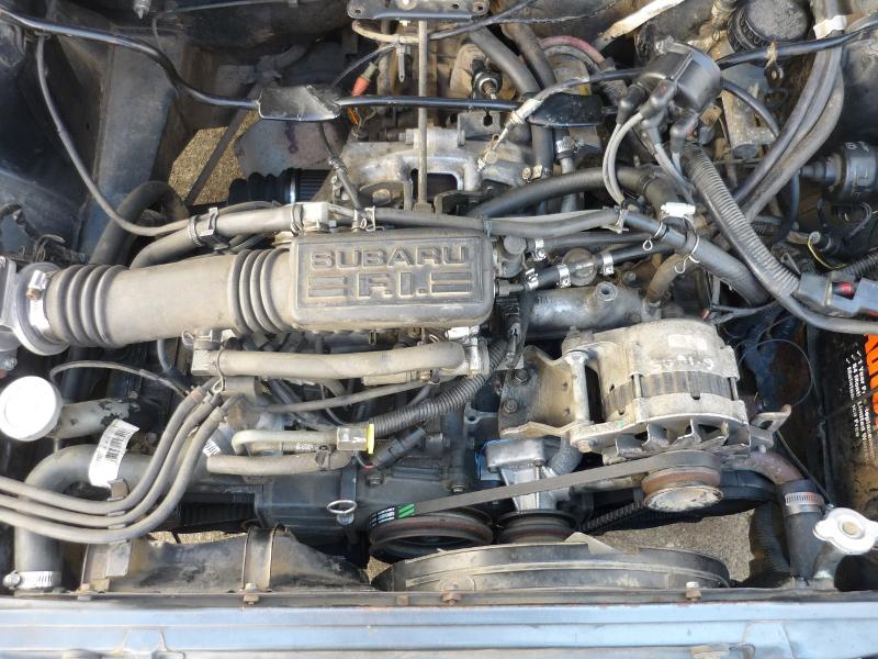

this is the motor:
Attached File  P1010111.JPG   97.21K   70 downloads
this is the car
Attached File  P1010115.JPG   67.73K   58 downloads
thanks for any help
Edited by jkinz, 05 August 2013 - 10:05 PM.

Yeah.....87 FI is a pain.....
the disty has different connector than all other years.
And the Pins at the ECU for Disty Ref. and Pulse voltages are switched from all the later years.
You can use the 88+ optical disty's in an 87 by switching the pulse and Ref. wires at the disty. Easy to do cause of course the connector needs spliced in so just reverse the GW and R wires.
You can use an 88+ ECU and 88+ disty toghether in an 87 car  without switching any wires around but the connector on the harness still needs swapped.
Edited by Gloyale, 12 March 2014 - 11:24 AM.
