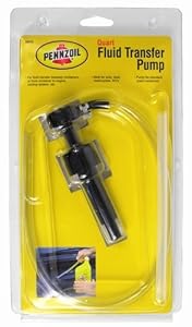

always remove the fill plug first anyway on the rear diff.
soak that drain plug in Kroil or 50:50 ATF and acetone for a few days.
even if it still won't budge, try s propane torch on it for 15 seconds, spray with kroil. let it cool, try again. use more heat if you have too - your changing the fluid anyway. Get a new plug.
I used something like this to fill;
change the o-rings on the suction and discharge hose connectors at the a/c compressor, and both schrader valves. Fill per the amount listed on a lablel under the hood somewhere.
