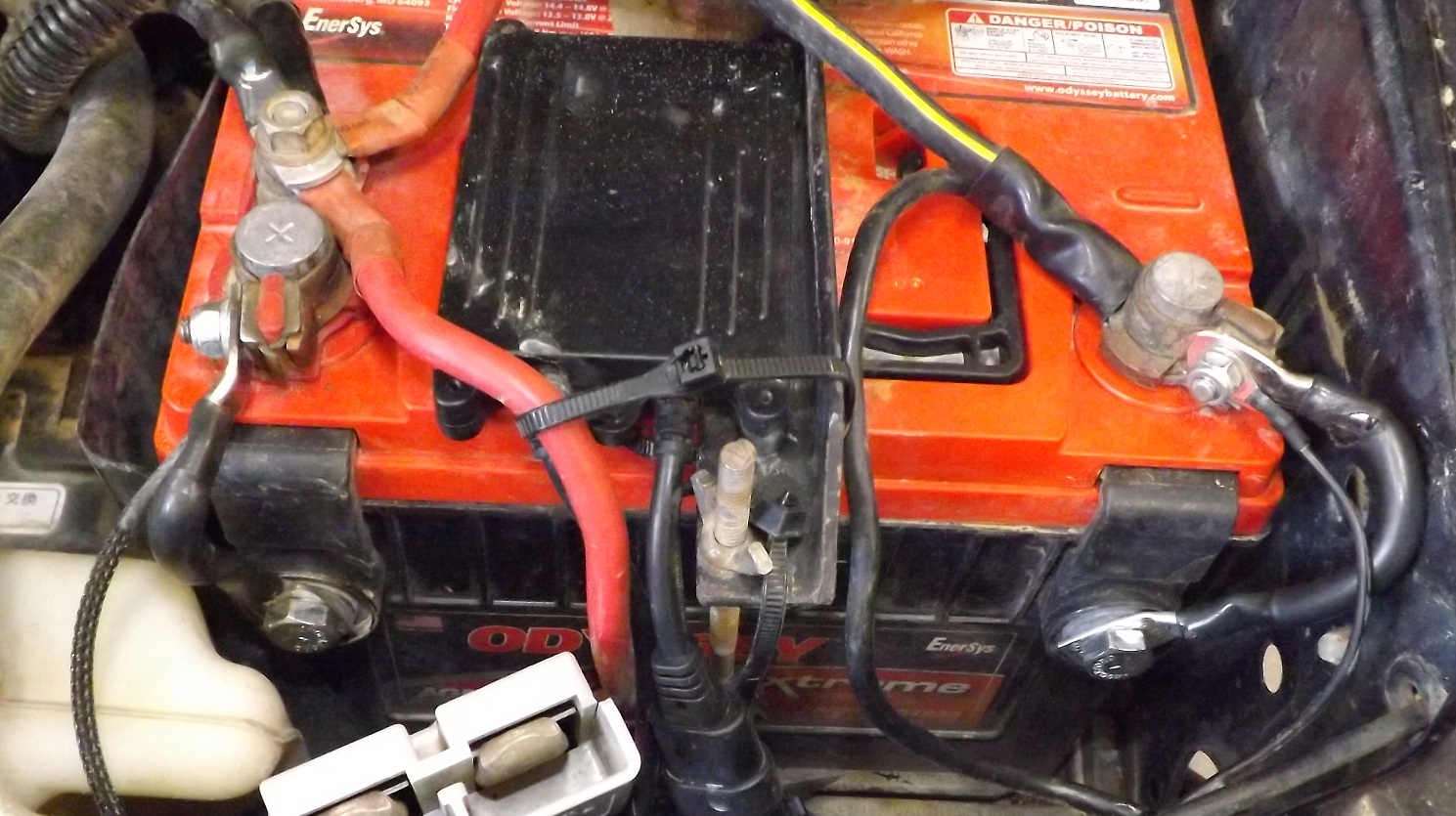

pontoontodd Posted September 23, 2016 Author Share Posted September 23, 2016 Back to brass tacks. We went through the struts, wheel bearings, ball joints, etc and they all seem good. Parking brake shoes are worn way down again, pretty sure that's just from sand and dirt getting in, we hardly ever use the parking brake. Since the battery has top and side posts and we had the positive cable come loose during the race, figured it'd be a good idea to add some short jumper wires to tie into the side posts: I had started to fabricate a new handle for the hatch when my friend suggested I see what the dealer wanted for one. Turns out it's only $25, if this one lasts 17 years I'll be happy. Quote Link to comment Share on other sites More sharing options...

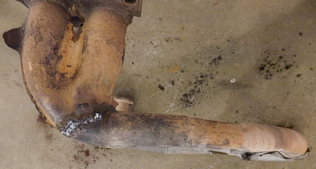

pontoontodd Posted September 26, 2016 Author Share Posted September 26, 2016 Here is the best picture I got of how smashed the exhaust was. Not terrible but probably not good, and pressed up against the power steering lines. You can also see where I had to weld shut the hole/crack we got during the race. For the time being I picked up a header from the junkyard that was lying under a Forester. Cut out some copper gaskets for the flanges. Have small tubes inside of those joints as well to minimize leakage. This is all the exhaust that's on the car right now and it's quiet enough. Eventually I'll run it to the back, probably get rid of this muffler, and have one near the back of the car. Going to make a skidplate out of 1/16" 4130 under the Y pipe and crossmember. Got it mocked up out of cardboard and have the piece of steel, just have to get around to making it. Probably have some spacers under the crossmember to help keep the exhaust from getting crushed. Really leaning towards the H6 swap though, so no sense doing a bunch of exhaust work yet. Quote Link to comment Share on other sites More sharing options...
