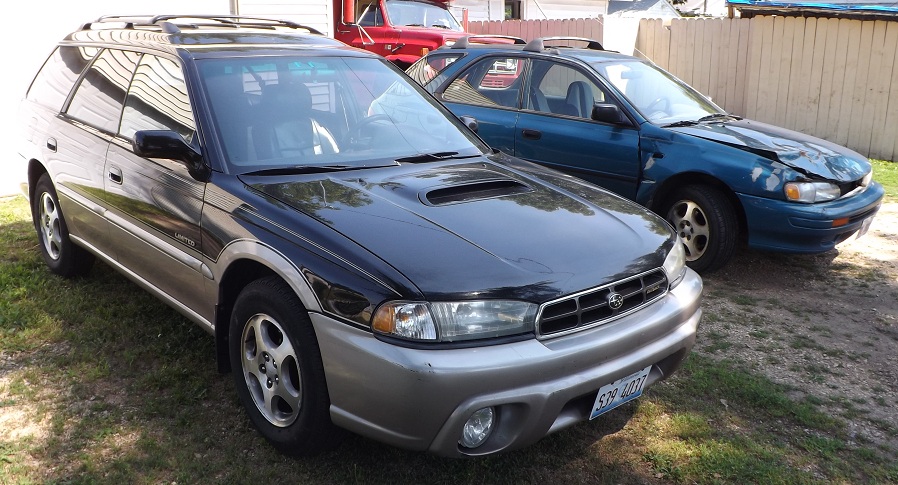

I got this 99 Outback about six months ago for a three day off road trip in the Upper Peninsula of Michigan.  We did about 480 miles off pavement over three days.

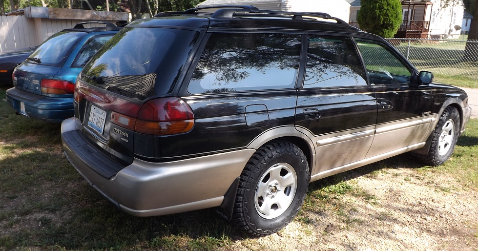

Pix of it next to my 96 Impreza with city boy tires:
215 75 15 Hankook Dynapro MTs and Forester steel wheels ($20 each on ebay) on the Outback and slightly oversized BFG winter slaloms on the Impreza:
This was the only mod on both cars before the trip:

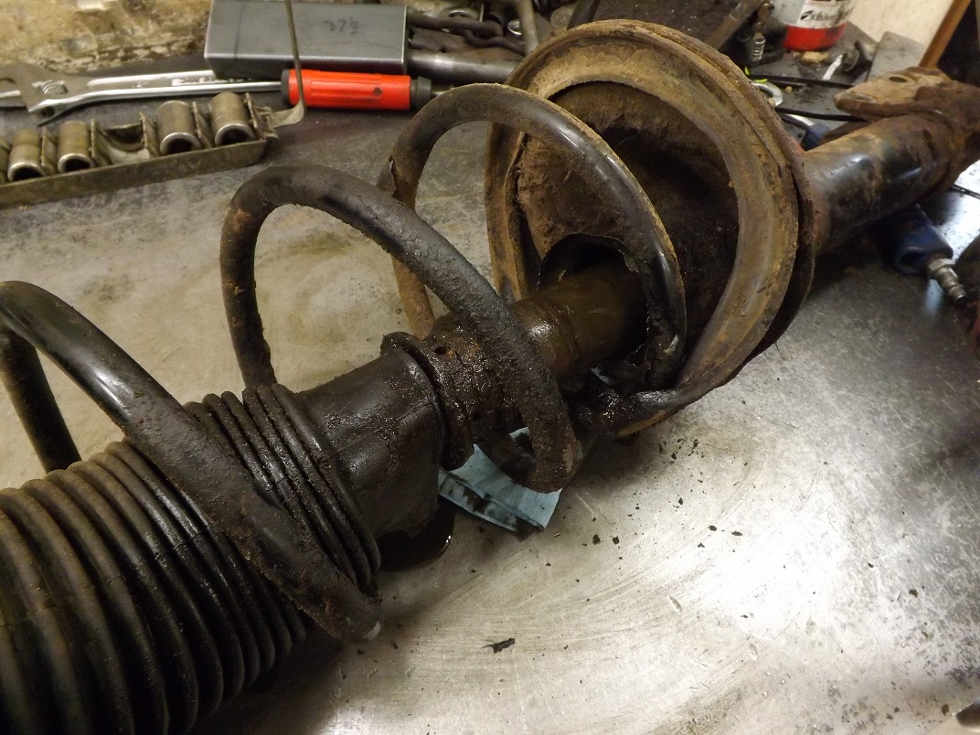

Both cars held up well, we did break the Outback's front swaybar and at least one of its springs.  Three of the springs were broken when we got home, we probably started with at least one broken.  The rear struts had minimal damping when we started and none when we were finished.  As you can see, one of the strut cartridges is completely separated from the tube.
Before I had been inspired by this forum I just got a set of new springs from the dealer (not wanting to break used springs later) and KYB struts for the rear from Rock Auto.

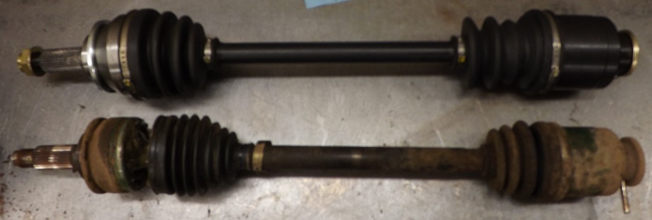

One front CV was clicking badly and the same wheel bearing was very loose.  Put a FWD Legacy axle (2WD 89-92 auto, 89-94 manual) in as a replacement, direct fit but bigger CVs:

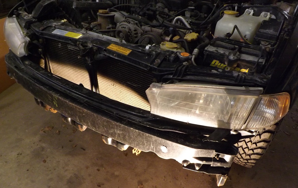

Later in the year we went to some off road parks.  We'd taken the Impreza before and were blown away by where it could go, the Outback was also impressive.
  • Like 1
Share this post
Link to post
Share on other sites

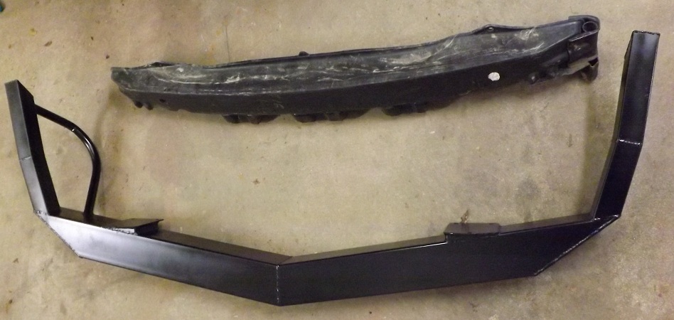

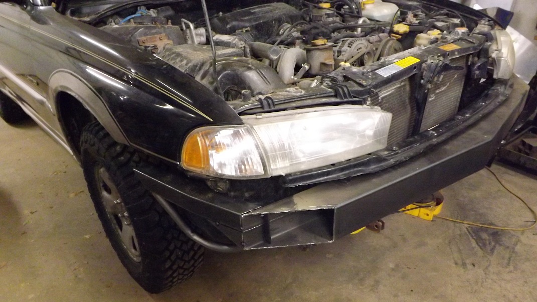

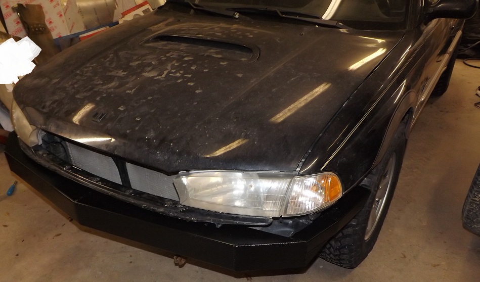

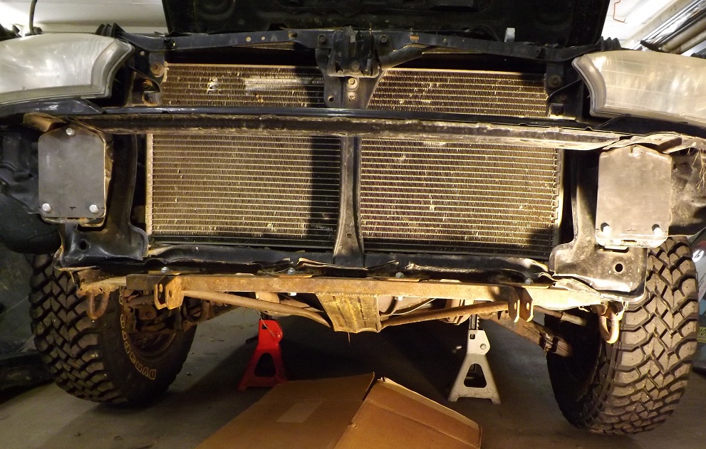

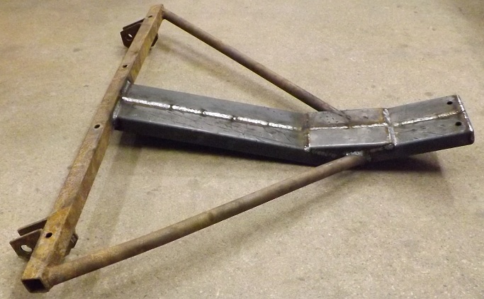

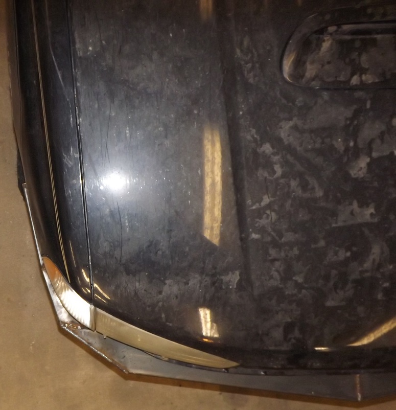

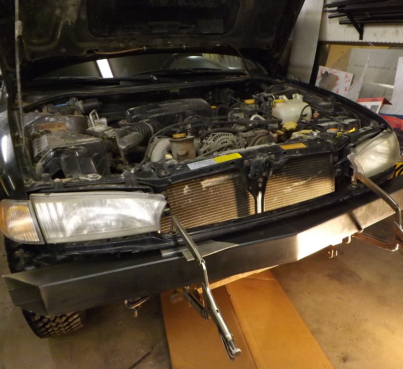

After those experiences, I decided I wanted a fabricated front bumper to protect the lights and so we could take down larger trees, especially since the stock bumper is plastic/fiberglass.
Stock bumper for reference:

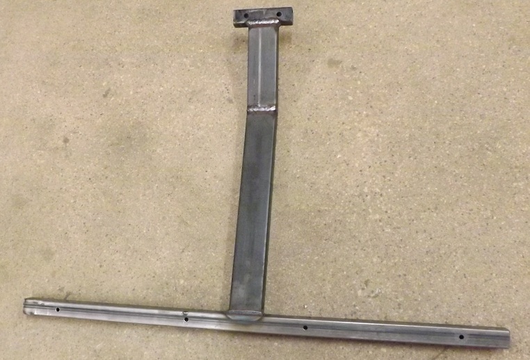

Very convenient bumper mounting on these cars, bolted plates on to the end of the frame to start:
Used a piece of 4" square tubing as the main beam, if I did it again I'd go with 3" square.
Again, this is to get around/over trees, hence the slight V shape.
I wanted to be able to put the bumper cover back on, otherwise I would have had it hang farther outside of the lights.

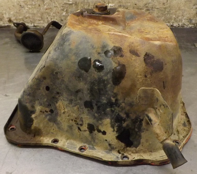

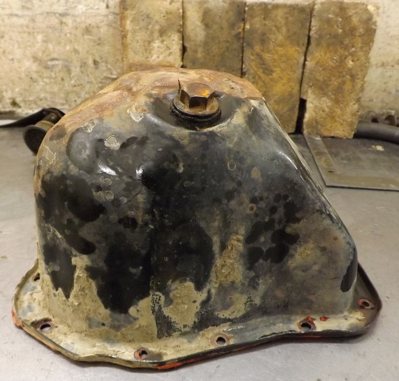

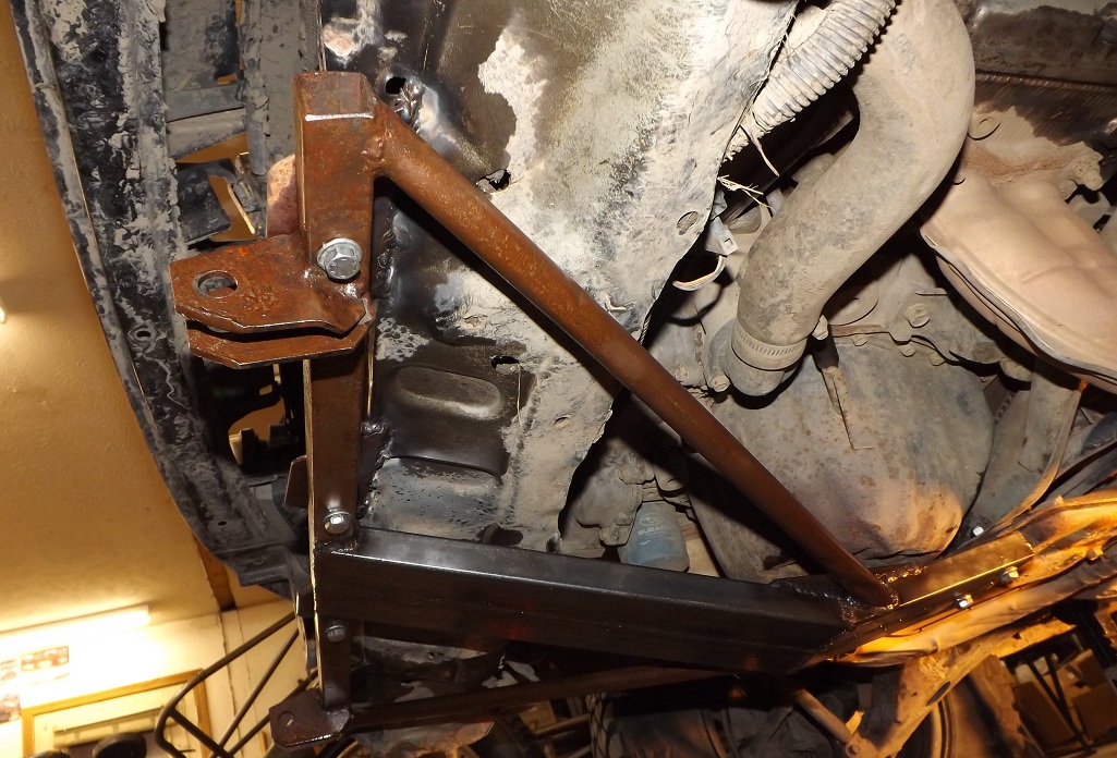

The oil pan guard was again bashed in so I added 1/8" 4130 plate to the bottom of it:
The oil pan was also dented in badly enough by this point the pickup was starting to rub on the inside of it.  That can't be good for flow.
Not too hard to remove, lift the engine a bit and get out the u-joint for the 10mm socket.
I propped the pan rail up on the bricks in the background and hammered it back out.

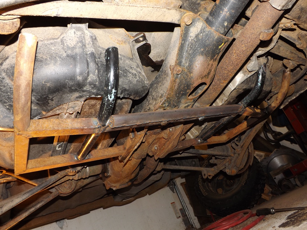

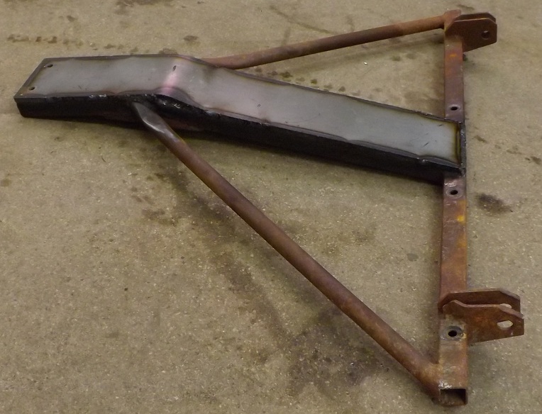

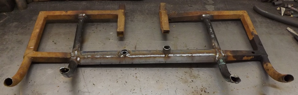

I finally realized the gas tanks on both cars were getting beat so I added to this guard I'd made for the Outback earlier:
Far from pretty but should keep the gas tank from being completely destroyed.

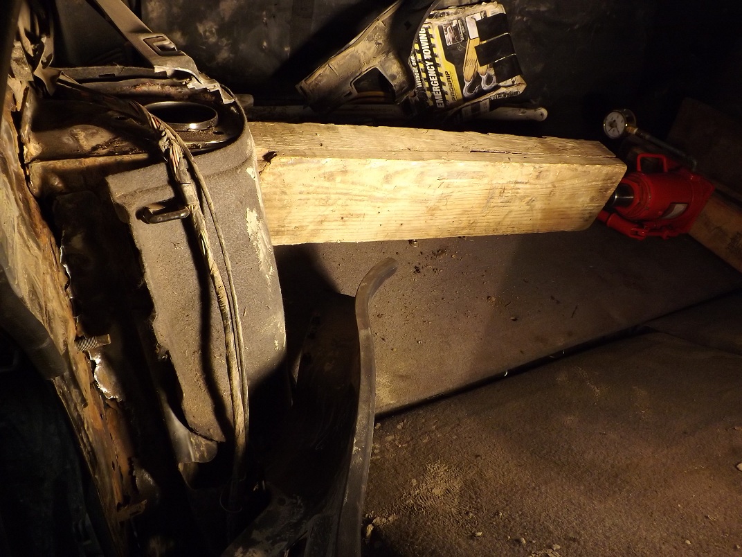

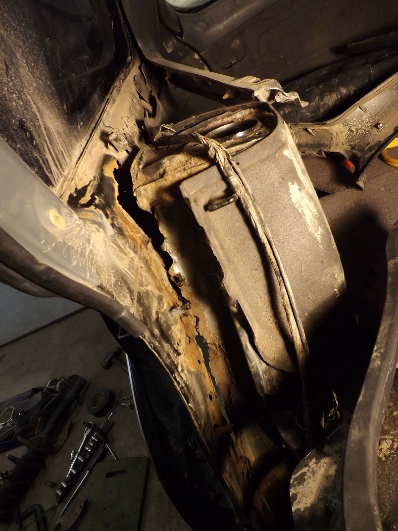

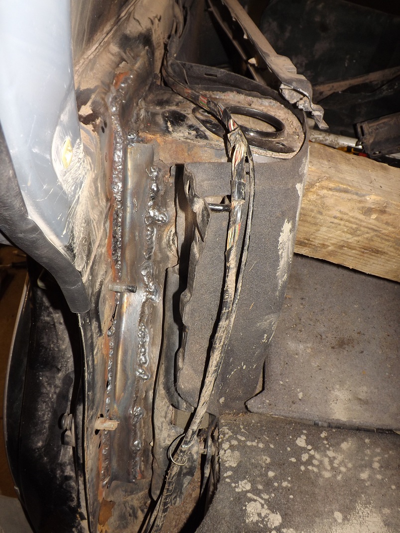

I knew the LR wheelwell was bad, didn't know it was this bad until I pulled out the carpeting.  There must have been a 3/4" gap most of the way around the wheelwell/strut tower.  I'd consider adding a rear strut tower brace to these cars before a front brace.
Tried to get it down to bare steel and pushed it back in place with a bottle jack:

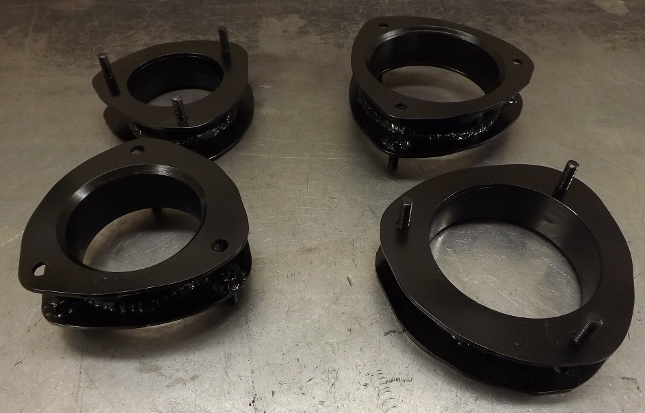

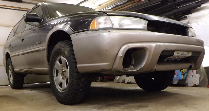

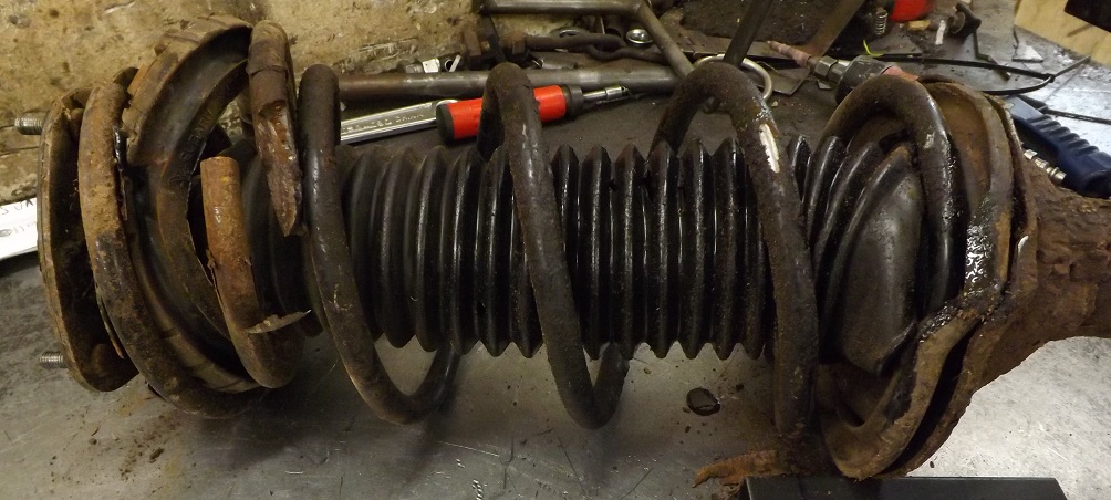

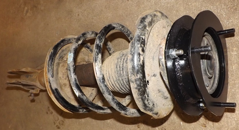

Then I made a 1.5" lift kit, it seemed like that's about all the stock suspension would do without binding.
Took it out in the snow recently:

axles break when: axle angle is far too steep and CV binds up, OR when the boots get torn and the mud/sand/silt etc destroys the CV, OR when the tires rub/bind against the sheet metal.
#2 is cured by maintenance #3 is cured by more lift #1 is cured by less suspension lift and more body lift.

Any idea how much suspension lift is safe for a 99 OB?  I've got 1.5" strut lift now with the intention of removing it if I start going through CVs this summer.

Now im not an expert, especially on newer rigs but I don't believe 1.5" of lift which have a huge impact on CV life.  I am 2" over stock on my axles and they seem to last for a decent amount of time for the conditions.
As for a welded diff i ran one for about 8000 miles with my 27" tires and only replaced two, one with a bad boot and one that separated from dropping a tire.  I have run the same welded diff with my now 235/75/15 (29") tires for maybe 1500 miles and have broken one diff stub, and im not even sure when it happened.  Just make your turns a little wider and be aware of the extra stress on dry pavement.  I will say the traction advantage is huge and was easily noticed when the stub was broken and make things a lot easier offroad once fixed.

IIRC EA81 can run 1" suspension lift,EA82 can run 2" and EJ can run 3" of suspension lift.The most common lift for EJ stuff is 5-6" with 3" from forester struts and the rest body lift.

I have pretty much the same amount of lift as you with tires that are a little smaller.  1.5in in my experience is as tall as you can go with out dropping the sub-frame and rear diff on an Outback, if you want to keep good alignment angles for the highway, and you will find when the suspension is hanging all the way down your cv axles are close to binding. Looks like you are on the right track though, I like you fuel tank guard and I see you discovered why the front bumper must go. As for the other stuff it depends on the level of comfort you want out of the car, mine is still my daily driver until I get another one so a welded diff wont work for me. I would like to have 4 to 6 in of lift eventually because I do some wheeling with my buddy's that have Toyota trucks and Jeeps and I can usually keep up pretty good but I have to use momentum a lot more than they do, so the Outback can take some hard hits. If I had more lift and lo range gearing it wouldn't be as much of an issue.
It also looked to me like 1.5" was all the Outback would take in the rear without binding at full droop.

Try a flat oil pan from 89-92 ej2.2 will give you more room Also if you use 07 and up water pump hose comes off the front instead of bottom gives you more room to
Is the 92- oil pan lower capacity?  Do you have to use the older pickup tube also?
Thanks for the tip on the water pump, wish I'd known that when I did the timing belt on the Impreza.
