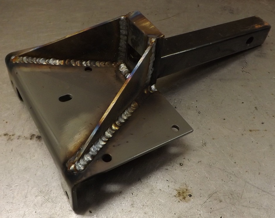

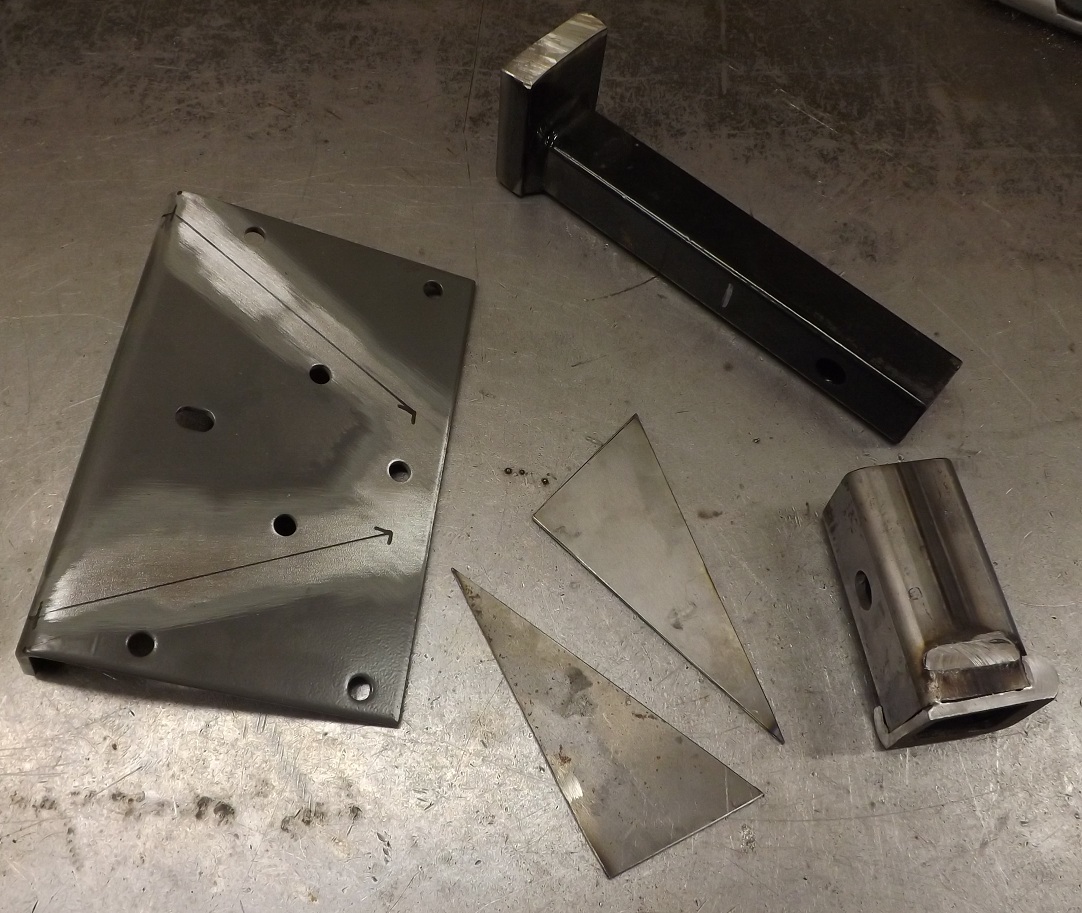

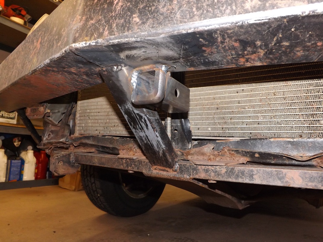

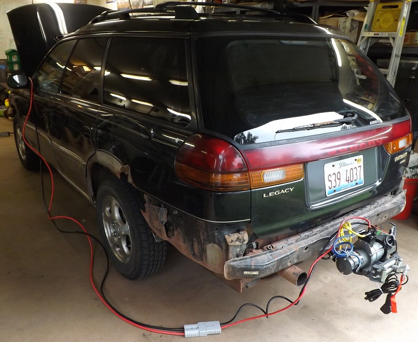

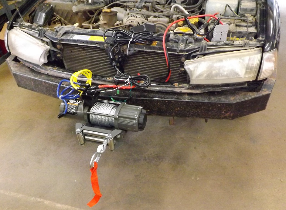

Made a receiver mount for a winch and added a receiver to the front bumper:
Got a 24" piece of receiver tubing from Summit so I have plenty for adding to the Impreza.

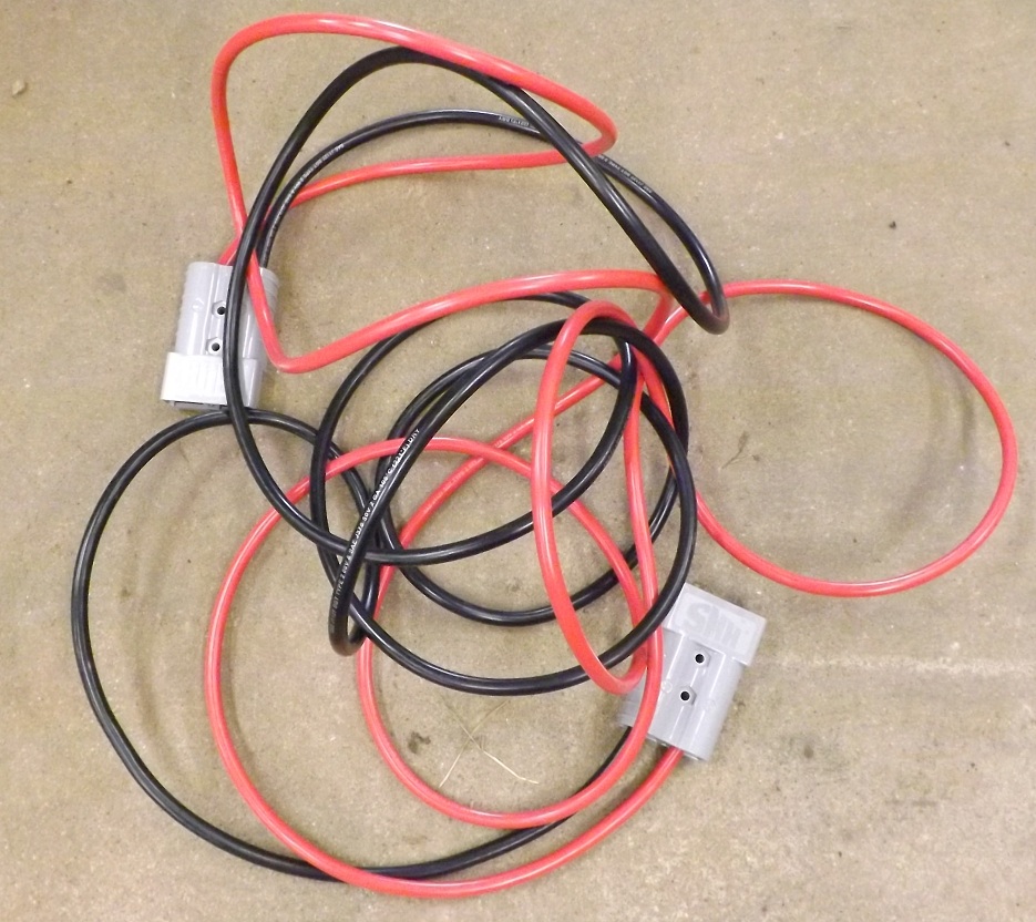

Used Anderson/forklift style electrical connections for the battery cables from HGM Forklift parts.  They're rated for 350A.
Also made a 15' extension cord so I can use it in the rear of the car:
I don't plan to ever leave it on while driving so I'm not worried about the horrible approach and departure angles.  This way I can keep it inside the car and put it on whichever end I want to go in the direction of when stuck.

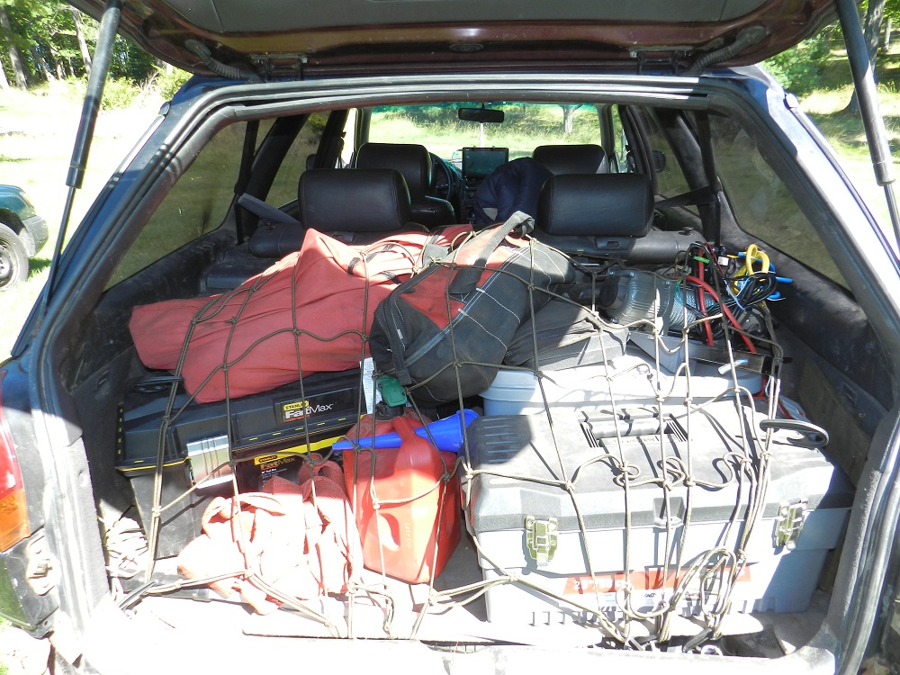

Picture of the Outback loaded up will all sorts of spare parts, tools, fluids, food, etc.  The cheap HF cargo net works surprisingly well.
One of the last minute upgrades before the trip was mounting a $100 android tablet from ebay on the dash with a RAM mount.  With built in GPS and preloaded maps, this made navigating while driving much faster.
We also threw CBs in the cars at the last minute.  They worked pretty well most of the time we were within sight of each other.

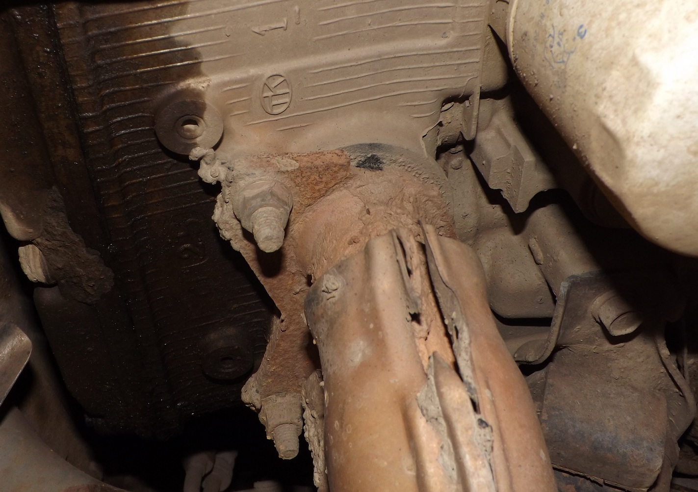

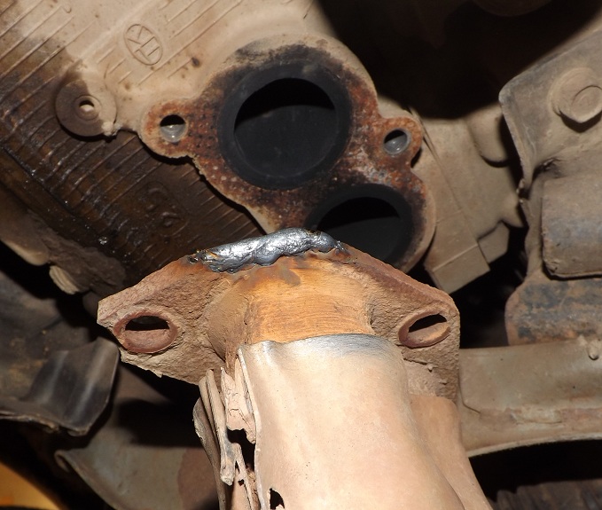

Exhaust manifold appeared to be leaking so I welded up the edge, ground it flat, and replaced the gaskets on both sides.

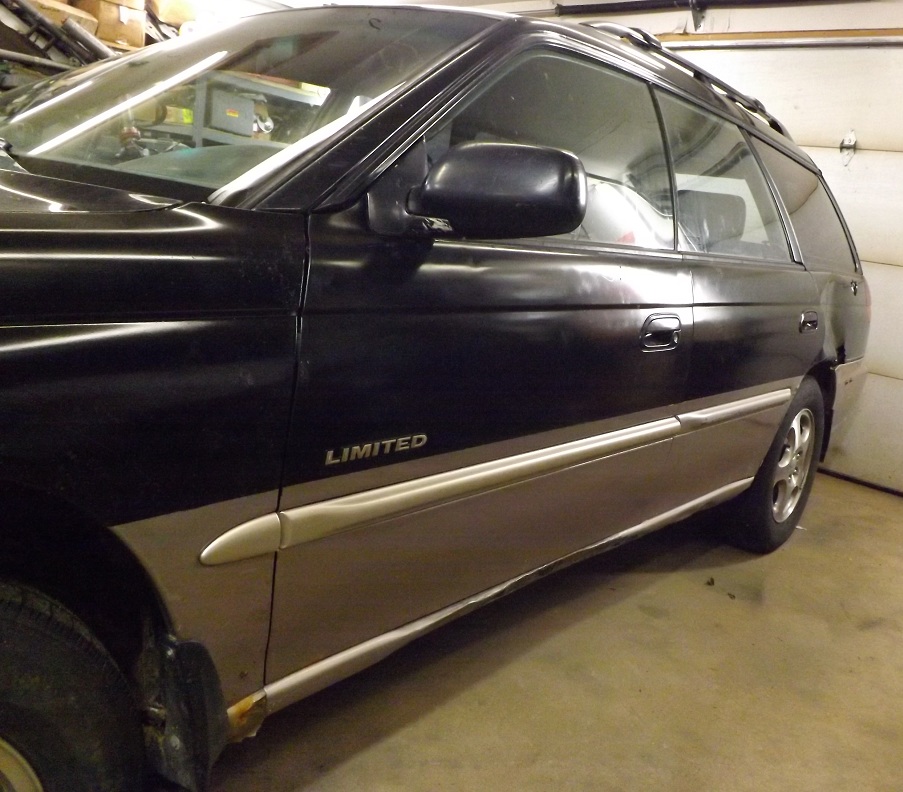

Painted and swapped on the front fender and doors from a parts car onto the driver's side.  It looked like this, mainly from misjudging one tree this summer:

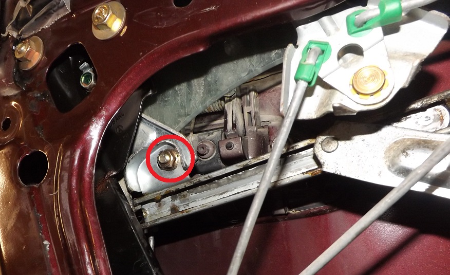

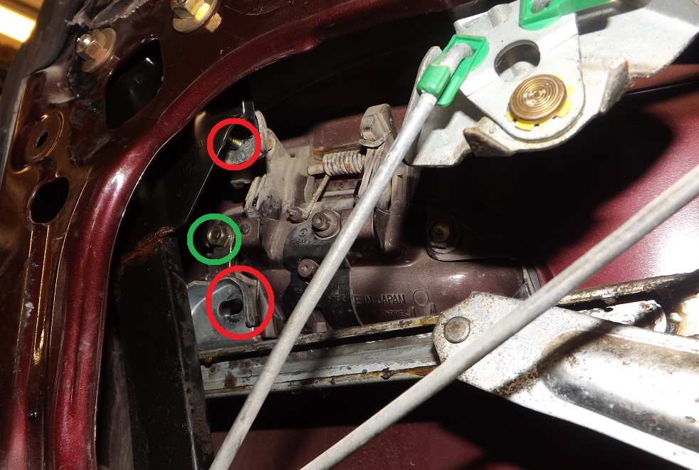

The most difficult part was removing the door lock cylinder.  I finally figured out that if you unbolt this part of the window mechanism:
Then jog the power window up and down while pulling up on the glass, you can open up a gap like this:
And get to the bolt (green circle) with a 1/4" drive ratchet.
I did a lot of wet sanding, priming, etc on the doors and front fender.  Used Krylon which I'd heard was the best aerosol on the market, not real happy with how those turned out.  Not quite the glossy appearance of stock.  Wound up using Rustoleum on the rear fender which matched much better.  Also used Duplicolor Champagne Pearl to respray the side moldings, one of which was black.  That was a decent color match.  Decided to just paint over the pinstriping and arches around the wheel wells for simplicity.  Turned out OK, still have to pop the dent out of the rear fender somehow.
