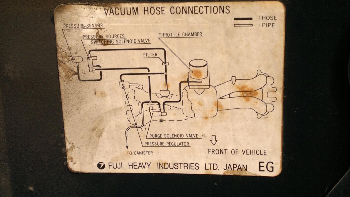

czny Posted May 13, 2014 Share Posted May 13, 2014 Here's a diagram from a 96 Lego for the vacuum & cannister: Quote Link to comment Share on other sites More sharing options...

bratman18 Posted May 19, 2014 Author Share Posted May 19, 2014 Got the vac lines all hooked up the way they should be according to the diagram and it didn't change a thing. Still won't rev up. Quote Link to comment Share on other sites More sharing options...
