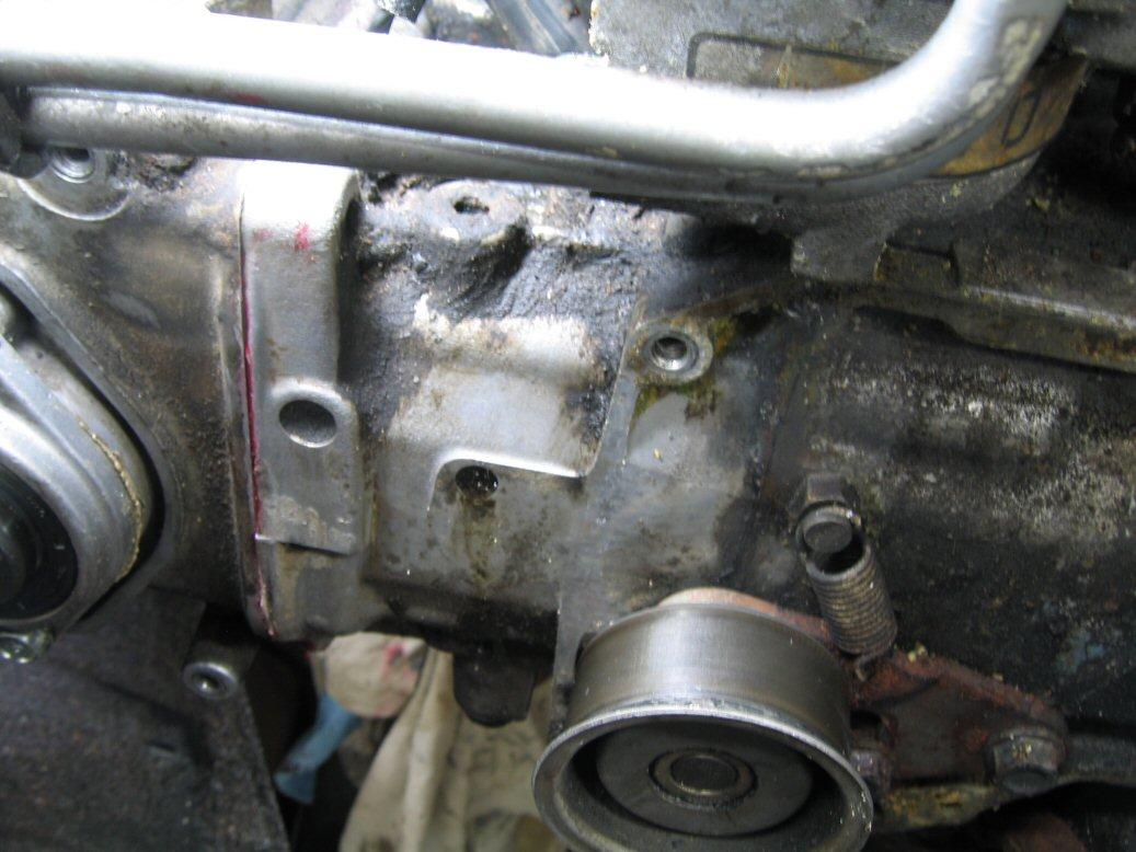

Here's what it looked like once I had everything but the old cam tower out.

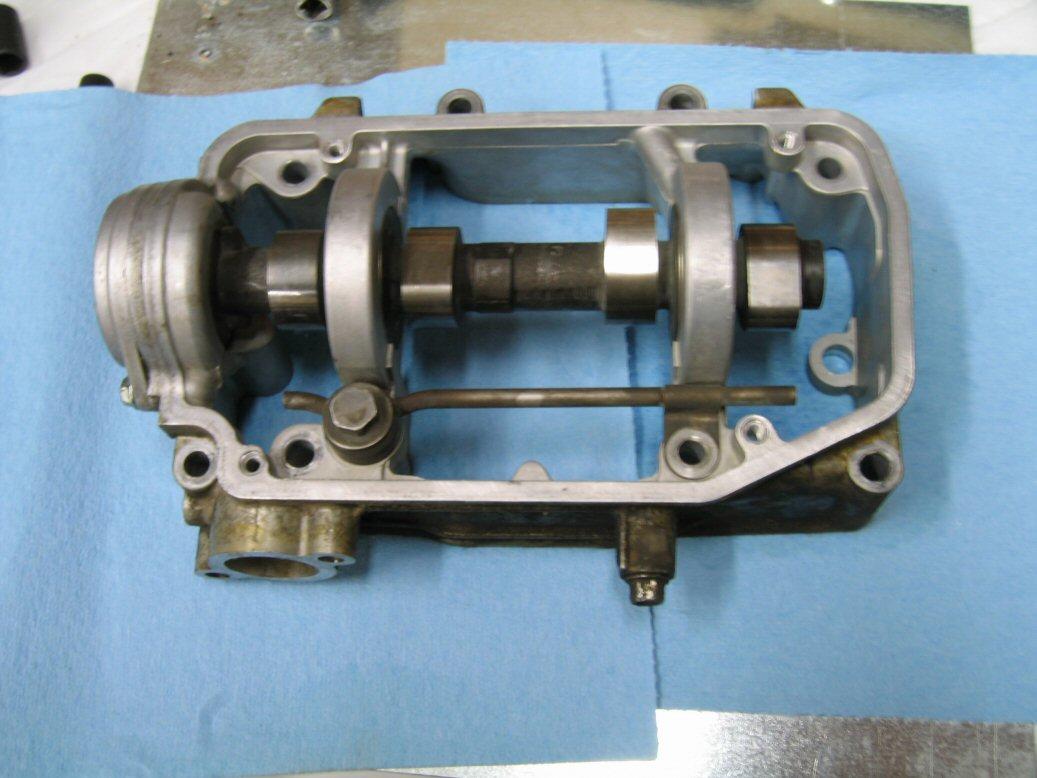

Here's the new cam tower cleaned up and ready for sealant.

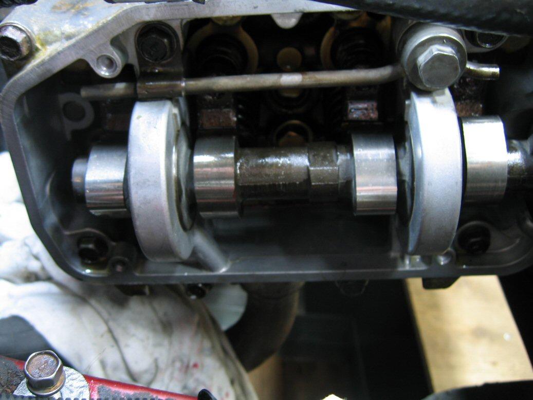

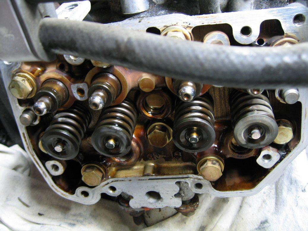

Here's a view of the cylinder head with the old tower removed and the lifters having dropped onto the rag that the book said to put there.  I realize that this is a disadvantage of horizontally opposed engines.

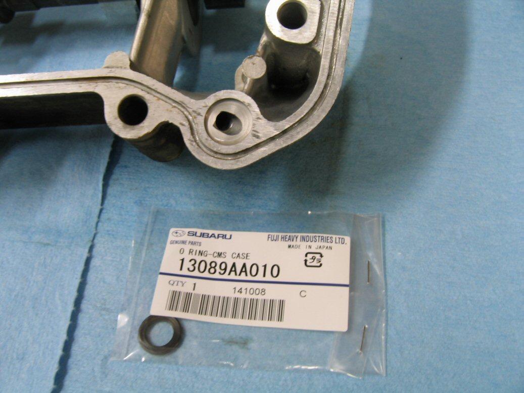

Here's the O-ring ready to go in it's spot.

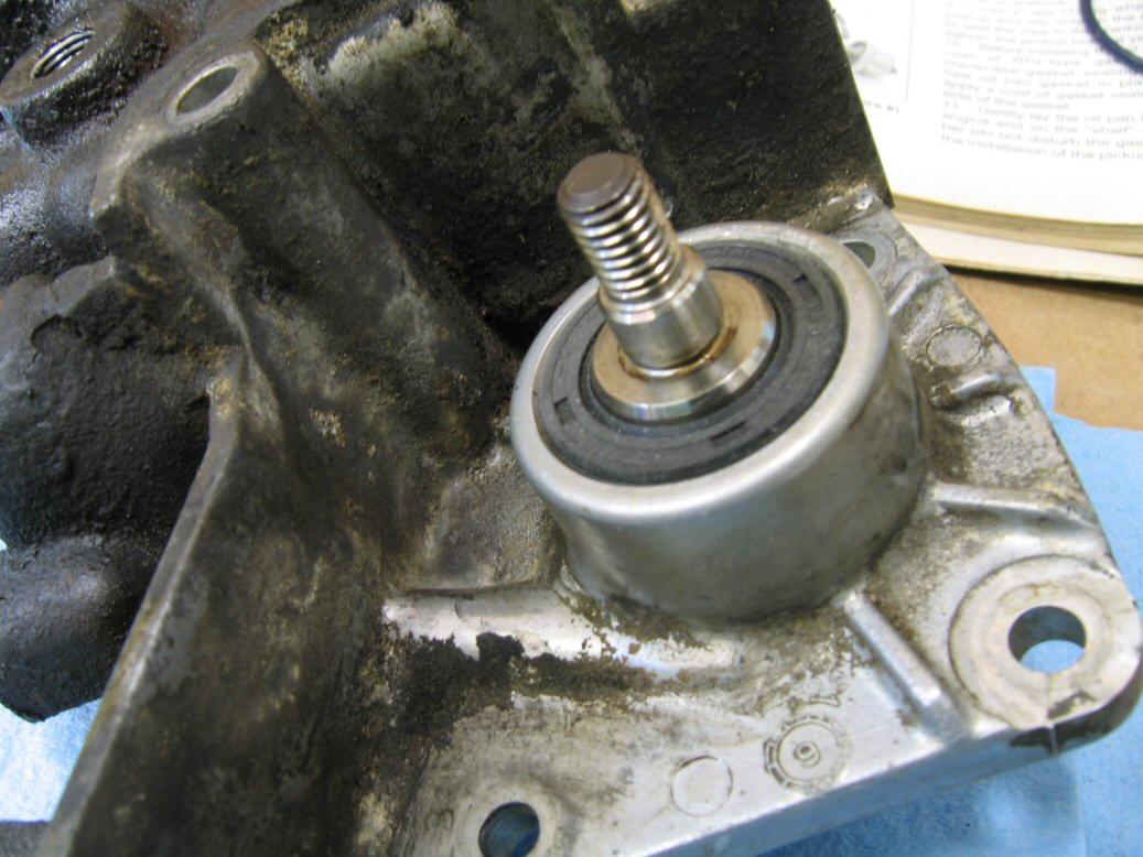

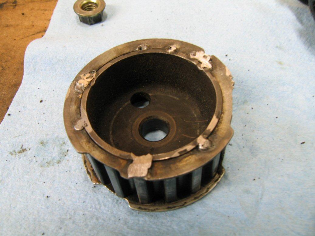

The oil pump - the difficulty here was getting the pulley off which you need to remove to change the shaft seal.  The Haynes book says to hold the pulley with channel locks with a rag over it.  It needed two people and a lot of effort to get it free.  However, two of the three spot welds on the one side were broken, not sure if it happened while I was trying to get it apart or it was already like that.  Here's my amateurish welding repair:
If you have to do this, you need to grind the welds right down because it doesn't have much clearance when it's installed again.  Here it is with the new seal installed.  I used a socket and a rubber mallet to work it in.
Here's the new cam tower installed

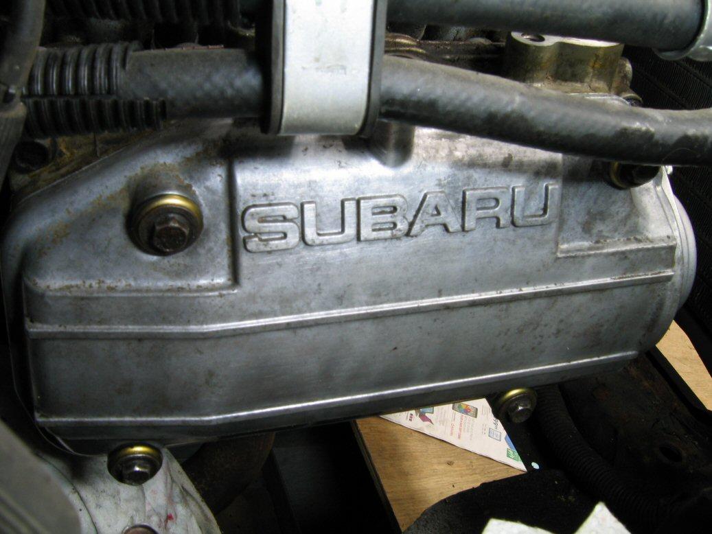

I put the valve cover on next.  If you're doing this job, throw away the torque wrench for this part.  I think the rubber affects the reading too much.  I just tightened them up to a reasonable torque and figured if it leaked, I could snug it up a little or remove it and add sealant.

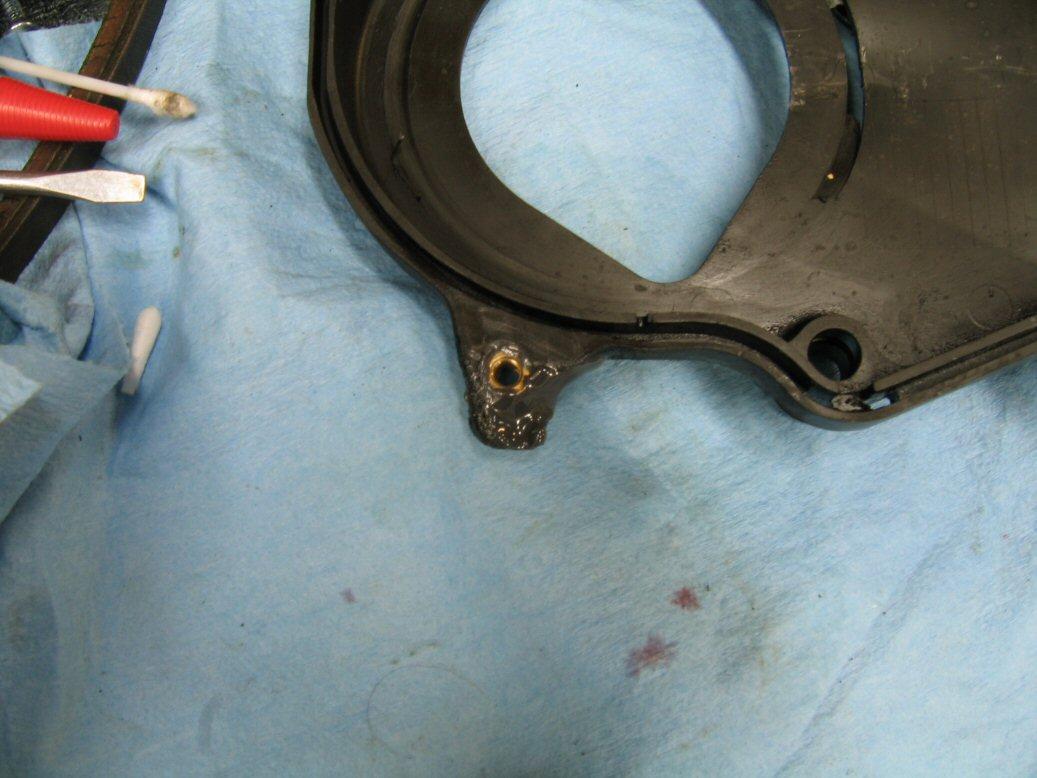

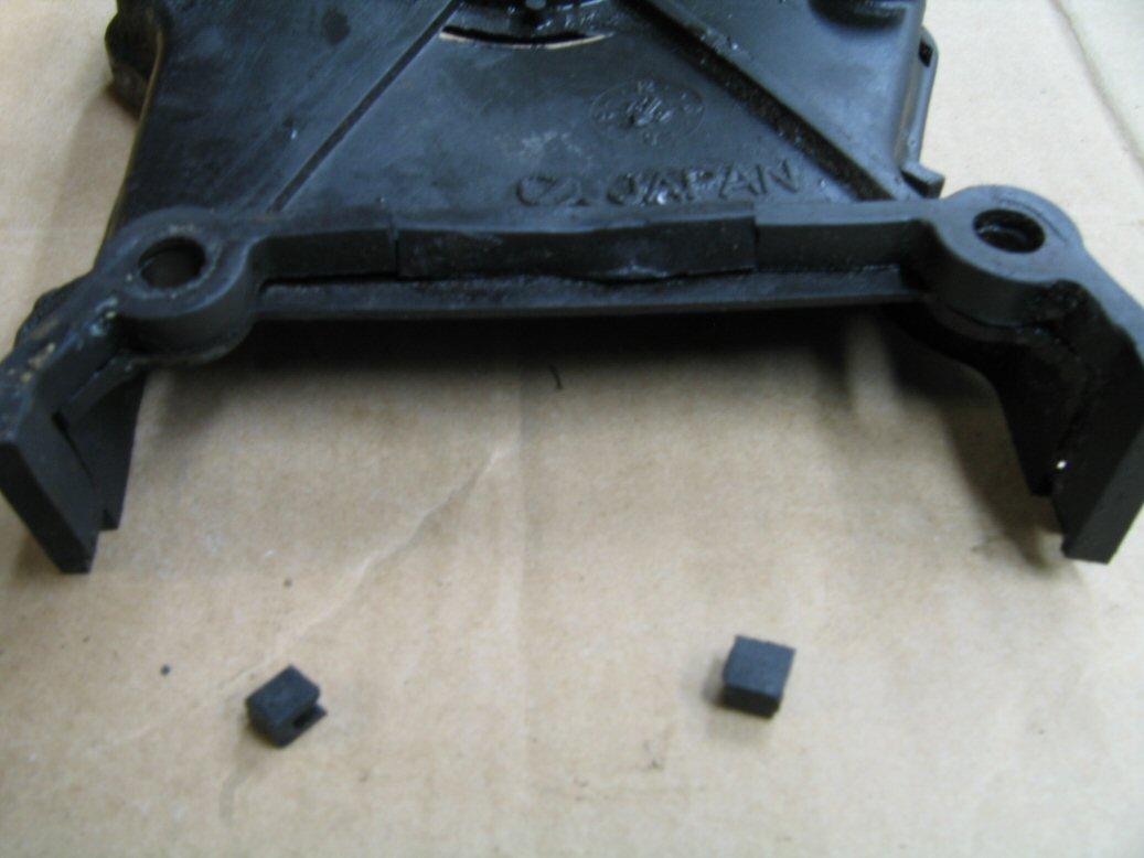

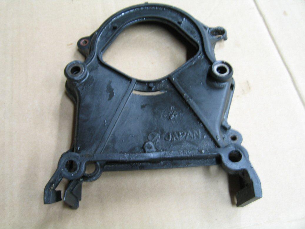

I decided to put the inner timing belt cover on even though I planned to leave the outer covers off.  It had a couple of problems.  First, it had warped a bit and the camshaft sprocket had chewed a groove in it.  I fixed that with a heat gun until the middle was bowed slightly in the other direction, which would flatten out once it was bolted to the engine.  The other problem is that the rubber edging must have swelled, because it was about 3/4" too wide:
So out came the snips.  The whole mess was gummy enough that I didn't have to worry about them falling off.
I also decided to epoxy the one insert that had broken out at some point.  I'll probably never put the outer covers back on so it was kind of a waste of time but I wanted to fix it while I had the chance (though since it was on the bottom outer corner, I could have fixed it after it was installed, oh well).

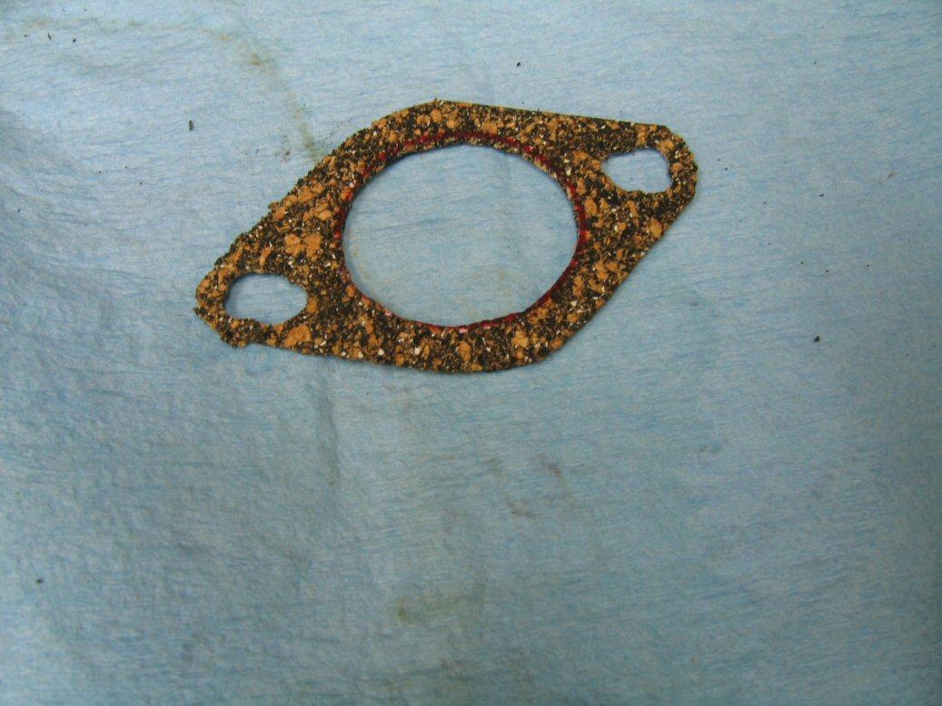

Another issue I had was with the oil filler neck.  At the bottom where it bolts to the cam tower is a black plastic gasket and screen.
Part of the screen was broken off but there was still 5 or 6 pieces of tin foil from oil bottles over the years.  I made a new gasket out of cork for now
I may order the part if it's cheap and available.  Clever to put a screen there though it probably should have been made of metal.  Do most engines have this?

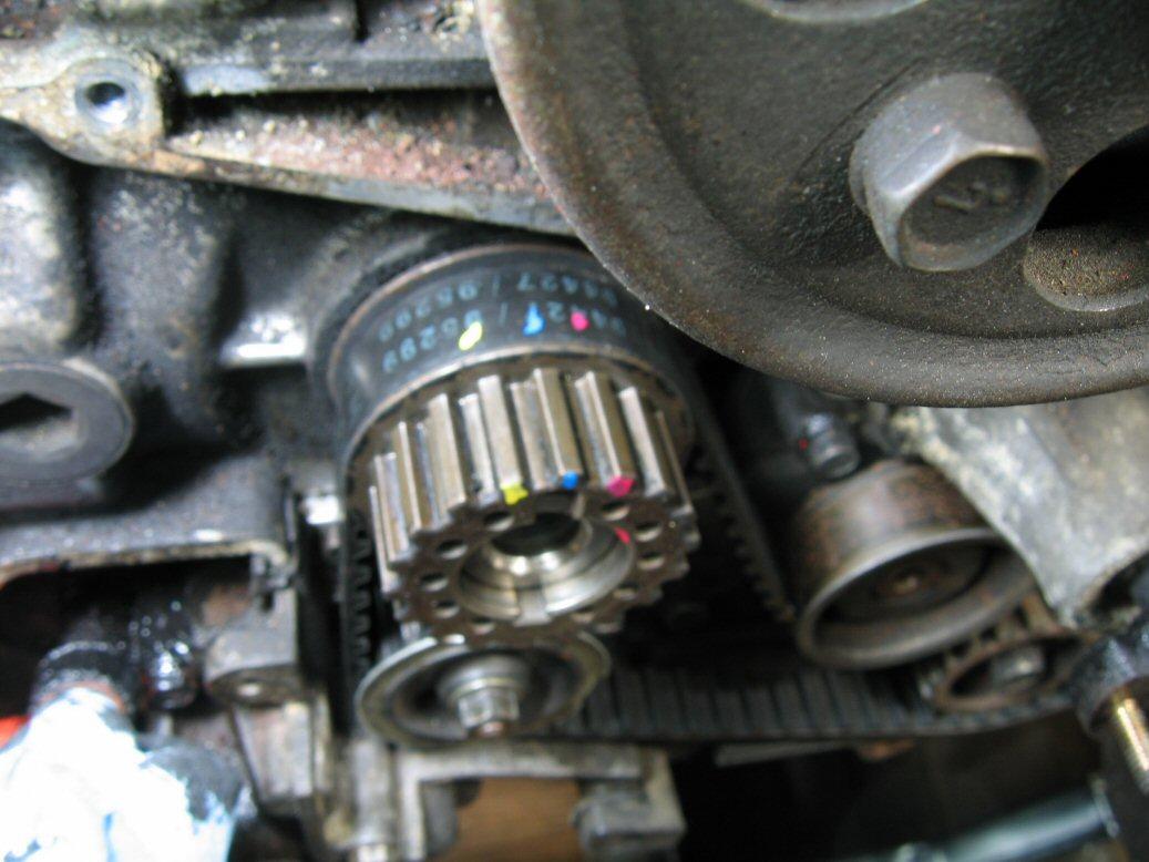

I also marked the front edge of the timing belts and a few teeth on the camshaft and crankshaft sprockets with a paint marker.  It made it easy to make sure they didn't get flipped around and that they didn't jump a tooth while I was putting them back on (which happened a couple of times until I got the technique down).

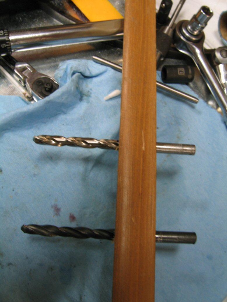

I didn't have the factory tool for putting tension on the belt, so I improvised with two 5/16" drill bits and a scrap piece of wood.

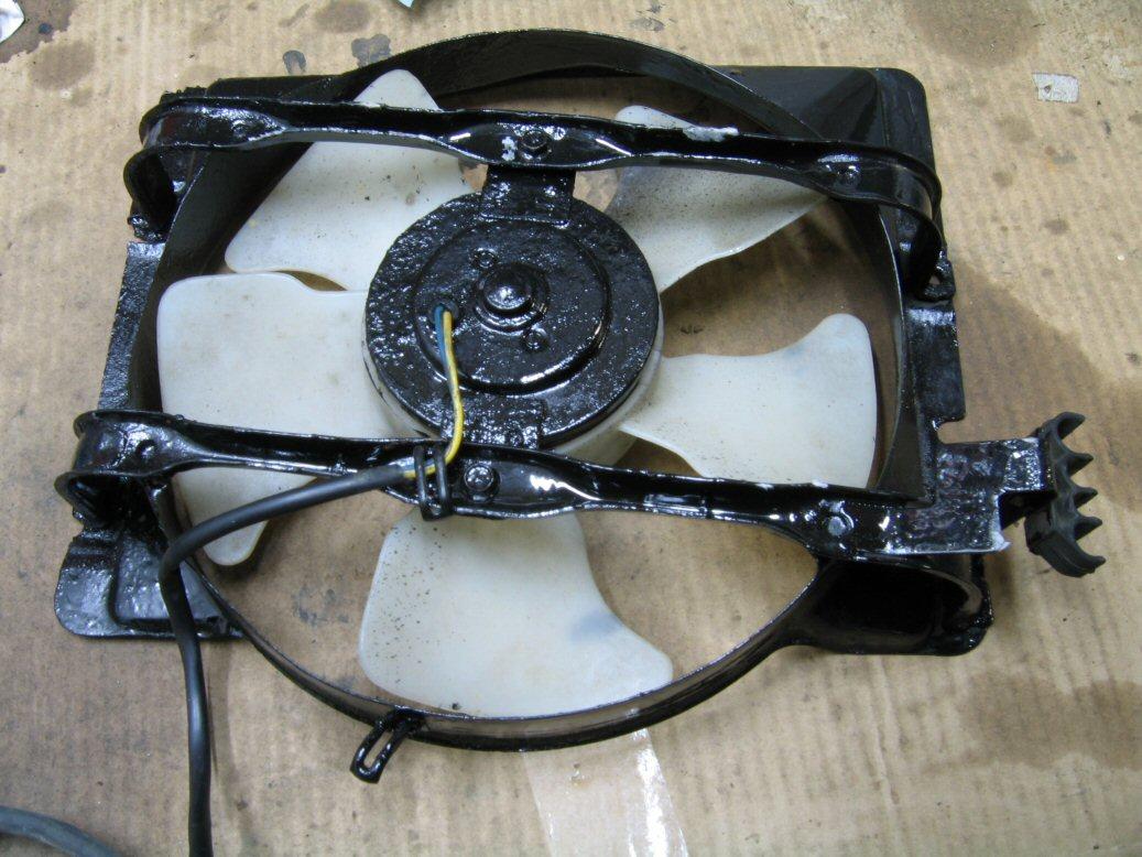

I also took the time to paint everything that I took off that was rusty.  Some of the parts are so rotted that even with new paint they still look bad, but hopefully it will slow the rust down a bit.

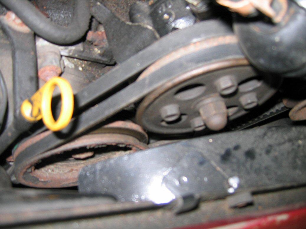

Also painted the radiator frame, battery hold down, charcoal canister holder and the water pump and crank pulleys.  They obviously wind up with water and/or salt sitting in them and the crank pulley was really bad:
Didn't get an after picture but just wire-wheeled it, sprayed some rust converter, masked off the bearing surfaces and sloshed some oil-based paint on it.

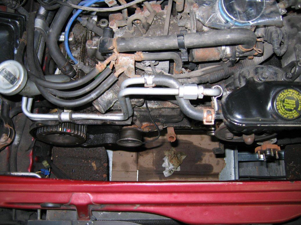

The two big problems I had were with the engine mounts and a coolant leak.  When I lowered the engine down, the studs were not lined up with the holes in the crossmember.  The engine was too far forwards.  I wound up tilting the jack towards the back of the car and using a pry bar between the exhaust pipe flange and engine mount studs.  I got the driver side one to line up first and just lowered the jack a tiny bit at a time and worked the other one with the pry bar until it lined up to.  Wasted a fair bit of time until I came up with a plan.

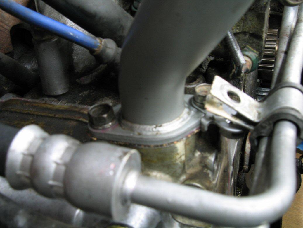

The other problem was that I stupidly connected the radiator hoses to the engine before I had lowered it.  Wrestling with connecting the lower hose to the pipe with the 90 degree bend that connects to the water pump caused the pipe to leak where it goes into the pump.  I wasted two hours fighting to remove the A/C compressor to get at the pipe mount to take it apart.  The O-ring seemed okay and I realized that nothing was worn or broken, it was just the fact that I had put too much stress on it connecting the hose and the mount doesn't really hold the pipe very solidly.  I would disconnect the lower hose at the radiator next time.  I also broke a ring terminal off a wire and had to fix that too.  I guess it's to be expected that when you do major work on a 22-year-old rust belt car, you're going to have a whole bunch more things to fix along the way.

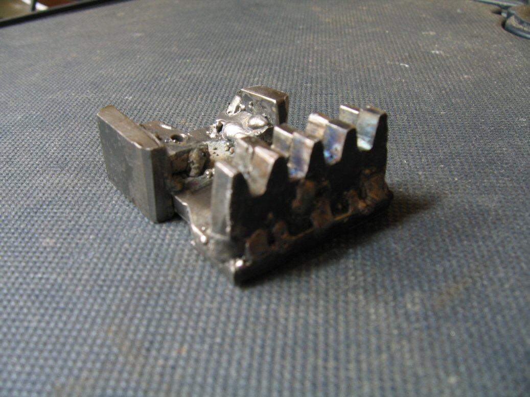

Almost forgot, I cobbled together a little tool out of some scraps to keep the flywheel from turning while I loosened and tightened the crank bolt.  Can you tell I'm not a welder?  Probably overkill, but I didn't want to risk breaking something off and having it fall inside the bell housing.
