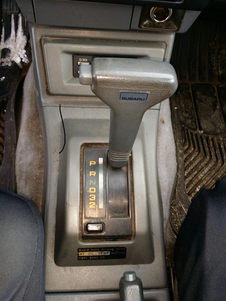

l75eya Posted January 8, 2017 Share Posted January 8, 2017 Are we absolutely positive this is a 4eat transmission we're talking about? Those were fairly rare transmissions to have in these cars. Can we get a pic of your gear shift? Quote Link to comment Share on other sites More sharing options...
wagonist Posted January 8, 2017 Share Posted January 8, 2017 If this gearbox is a 4spd (really need to see a pic of the shifter), then it is the same gearbox as in your outback, and the fuses are the same. BTW, on the part time 4wd model (3spd gearbox) the lights on the dash do not light up front wheels only for FWD, & then all 4 for 4wd. they are either all off when in FWD mode, or all on for 4wd (plus the words "4WD" will light up) Quote Link to comment Share on other sites More sharing options...
brundl3fly Posted January 9, 2017 Author Share Posted January 9, 2017 (edited) I am still waiting for the pic of the shifter (its at my friend's) but it is the 4 speed... unless I am counting wrong. It has the 1 hold button at the bottom as mentioned in the 4eat documentation and there is a "power" light also mentioned. I was looking for an existing pic on the net but was unsuccessful finding the exact one and do not want to confuse matters. I also saw on a year model description the mention in 88 of the air suspension which this car also has. That wasn't mentioned on the 87 model (that I found) but the title says 1987. Edited January 9, 2017 by brundl3fly Quote Link to comment Share on other sites More sharing options...
silverhelme Posted January 9, 2017 Share Posted January 9, 2017 If you could post a picture of the gear shifter. This would answer the question of which transmission it is. '87 is a maybe year, it maybe a 3 speed which has a fuse in the fuse box or it maybe a 4 speed which should have a fuse on the firewall drivers side. It has been a while since I looked at my '88 but that is where I remember it being. Quote Link to comment Share on other sites More sharing options...
brundl3fly Posted January 9, 2017 Author Share Posted January 9, 2017 OK here we are. Quote Link to comment Share on other sites More sharing options...

wagonist Posted January 9, 2017 Share Posted January 9, 2017 "1 Hold" button definitely indicates 4EAT transmission which should be full time 4wd. The centre diff torque split front to rear is controlled by the transmission computer. In wagons, it's hidden behind the trim in the rear left corner of the car (in the cargo area). No idea about where it is in sedans or XT (I guess bolted up under the rear parcel shelf). But first step is to make sure that there is not a fuse in that holder in the engine bay. Quote Link to comment Share on other sites More sharing options...

silverhelme Posted January 10, 2017 Share Posted January 10, 2017 (edited) That manufacturing date should be a 3at but as the photo shows it's not. The fuse for the 2wd should be located on or around the strut tower drivers side per FSM NOT in the fuse box. I've owned 3 of them and every one of them came with a fuse installed in the holder to disable the 4wd thinking it got better fuel mileage. If the fuse is in it is in 2wd. when the fuse is out (not installed) it is in 4wd full time. 2wd is for diagnostics only and the FSM says DO NOT RUN FOR EXTENDED TIME. Edited January 10, 2017 by silverhelme Quote Link to comment Share on other sites More sharing options...
