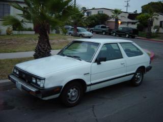

here is a picture of the next project car... Project Black Agent

Yup, looks like a 2WD '87 1600cc DL Hatch to me. Might be badged as a GL, but i would look closer into it, most definatly looks like a DL from here.
Good luck on any parts. There are larger engines, but they don't fit without ALOT of shoe horning. The EA82 and the EJ Series (2.0, 2.2, 2.5) are all overhead cam, making them alot wider than the EA71 and the EA81.

That car came from the factory with an EA81 - no doubt about it. If you have an EA71, then the car has been mucked with by someone.
It's got 4 headlights - smells like a GL to me.

Look into aircraft modifications. GD, that car, being a 2WD, can most definatly have a EA71 in it. Even 4 headlights doesnt mean its a GL. 2WD DL's still have quad headlights.
