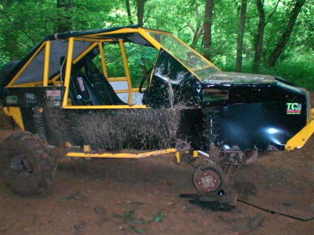

I'll talk with him Mike and see if he has any photo's of the buggy before sheet metal and I'll have him take some more of the inside. Last night he sent me the picture of the black one that they just finished and took out on it's maden run....they rolled the tire off the right front. This is my first time trying to do an attachment so if it doesn't work just look in my gallery I put it there also. The nose on this one is a little longer because they opted for the radiator in the front to make room in the back for a passenger.

This is what old Dirt Track Racers do when racing becomes too expensive ....These guy's have built lots of race cars over the years so the transition wasn't too hard for them.
