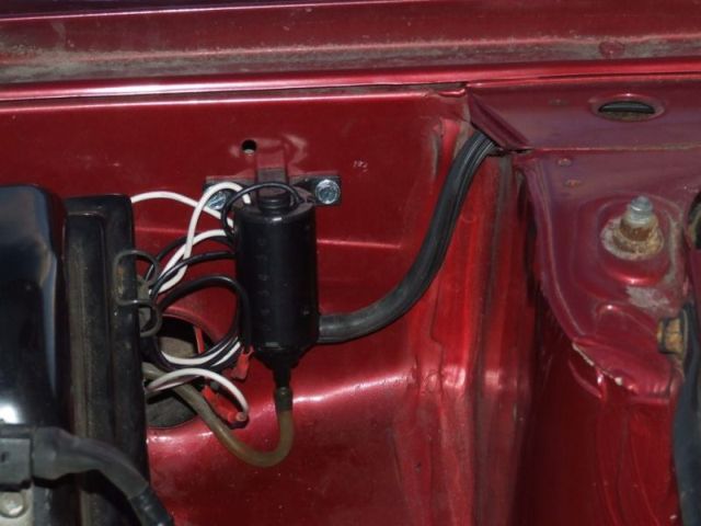

  10. Here's how to plumb a universal washer pump without exhuming the stocker from the fenderwell:)20-2008, 03:51 PM paulpicard http://www.ultimatesubaru.org/forum/images/statusicon/user_online.gif vbmenu_register("postmenu_694406", true); USMB Regular Join Date: Oct 2003 City: Princeton BC State: International Posts: 108 iTrader: (0) Vehicles: 84 wagon, 92 Loyale wagon Photos Re: 92 Loyale windshield washer GD, thanks; you're right. For anyone else out there with a bad Loyale washer pump, the red/white power and black ground wires can be accessed through the same hole in the fender well that the stock pump outlet hose comes out of - just aft of the airbox. I needed long-nose pliers to grab them, but there's enough slack in the main harness to allow about 3" of wire through the hole. I cut them and mounted a new Trico Universal washer pump right next to the airbox and spliced in the red/white and ground wires. The stock hose fits the Trico inlet, and I used the hose that came with the kit for the outlet. No need to go inside the inner fender liner and remove the old pump, the Trico pulls right through it and is a pretty decent unit. Model 11-100 (or WP-300) at your local parts store, around $20 including hose, wiring, and bits and pieces. And get this: it's actually "Made in U.S.A."!!! Attached Imageshttp://www.ultimatesubaru.org/forum/images/attach/jpg.gifTrico washer.JPG (38.7 KB, 3 views) Last edited by paulpicard : 01-20-2008 at 04:38 PM.
  11. GD, thanks; you're right. For anyone else out there with a bad Loyale washer pump, the red/white power and black ground wires can be accessed through the same hole in the fender well that the stock pump outlet hose comes out of - just aft of the airbox. I needed long-nose pliers to grab them, but there's enough slack in the main harness to allow about 3" of wire through the hole. I cut them and mounted a new Trico Universal washer pump right next to the airbox and spliced in the red/white and ground wires. The stock hose fits the Trico inlet, and I used the hose that came with the kit for the outlet. No need to go inside the inner fender liner and remove the old pump, the Trico pulls right through it and is a pretty decent unit. Model 11-100 (or WP-300) at your local parts store, around $20 including hose, wiring, and bits and pieces. And get this: it's actually "Made in U.S.A."!!!

  13. Anyone know where to find the washer pump wire (red/white according to Haynes) on a Loyale? I want to hook up a new pump but can't see any evidence of a red/white in the wiper motor harness, and of course the washer reservoir and pump are buried inside the fender - a place I'm not going until late spring!!

  15. Jeez, thanks - that's encouraging:eek: :-\ I had another thought - is it possible that the pump could freeze (due to no antifreeze mix in the bottle) and therefore not operate at all?? (no noise?)
