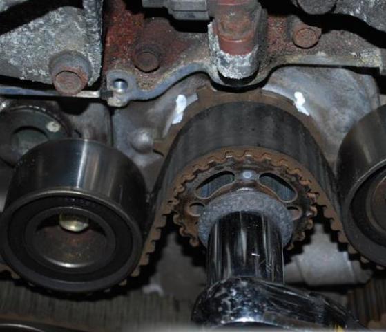

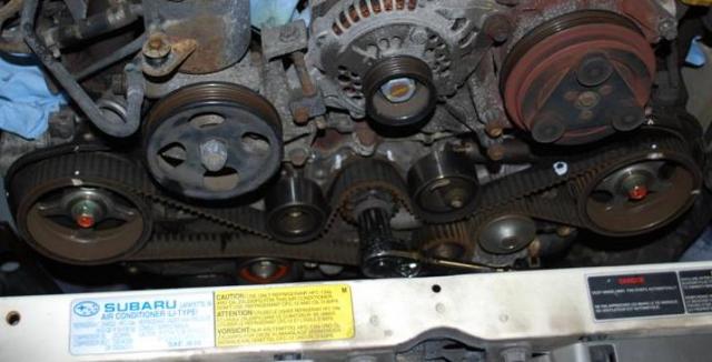

Happy Holidays All.... I have done 4 Subaru timing belts and this is the first one that had man made white marks from the last shop to do the belt. I know how the marks should be lined up. But here is what does make sense. Both Cam sprockets are line up with the metal notch to the back of the timeing belt guard. The problem is the Crank Sprocket is pointing 90 degrees right as seen in the pics. It should point straight up. What do I do. Leave as is or swing it back 90 degrees. It has been running fine the past 90K miles. 98 OBW Auto with a 2.2
