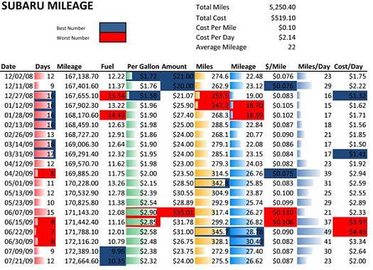

That's sweet. Yeah, a digital one would be cool, but I gotta take what I can get apparently. I mean, vacuum alone can't be the only thing, because it doesn't compensate for speed. but it WOULD be at least a start. It at least seems like it would give me the info "This is the Best Mileage you can get under these conditions", and as long as I keep the needle to the best mileage potential, that will appear when I do the miles-per-tank calculation. The "Hey Cool" factor might just have to wait. This is something I can do easily enough, yes? Is it just a mount-n-connect? I'm sure there's a vacuum output I can find ... -

Right. Aside from the "hey kinda cool!" factor, I'd like to get some immediate feedback on what my mileage is in real-time. I mean, i can get 46 mpg if I drive from on gas station to the next on the expressway doing 55 ... but that's a no-brainer. I wanna see what hills do, what coasting does, slamming on the gas, sitting @ lights, etc. It might not be worth the cost, but it'd be a good feedback mechanism. I do the "per-tank" thing already. And I have gotten anywhere from the 18s to the 30s in mileage. And you're right - that device I posted was for OBDII plugs ... but its as close as I could get in a quick search - I wanted to see if you folks had done anything close to that already, or if I was gonna start from scratch. Where can I get more info on Vacuum gagues? -
