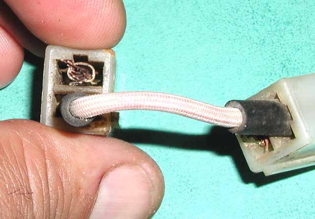

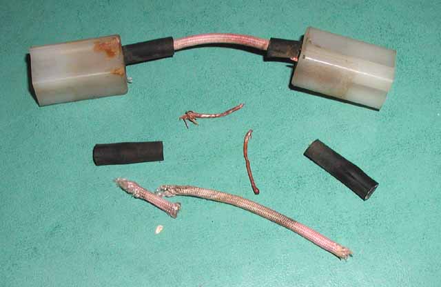

SCORE!!!!! yes. Follow the positive lead off the battery. Look for the funky little piece with the cloth wire covering. It is only about 2-3 inches long. Less than a foot off the terminal. Pics below. I tried to get the wire connector out. No such luck. I cut a piece of new fusible link wire ( Napa, sppol for less thank $ 6.00) and crimped it in there. Tried the key and all the dash lights lit up and the engine cranked. I ran some fuel line right from the pump to a gas can. Won't fire. Then had wife turn key while I put my hand over the fuel filter inlet. Slight suction. Looks like I might have to elevate the can to get the pump primed? If it runs then I'll reconnect it to the gas tank. Good Plan?

Arrgh. I finally got the gas tank drained and the line cleaned. New fuel pump, so ready to fire it up. Cranked the engine. Noticed smoke from the engine bay. I quick check and I saw the wires to the alt were not hooked up. i had taken them off because I had to move the alt to gain access to something. O.k. alt wires reinstalled and turn the key....nothing and I mean nothing. Not even lights to the dash. Anyone got a clue as to where to start? An order would be good. See, even those little things you forget can get you. Tis an 81 wagon 4wd
