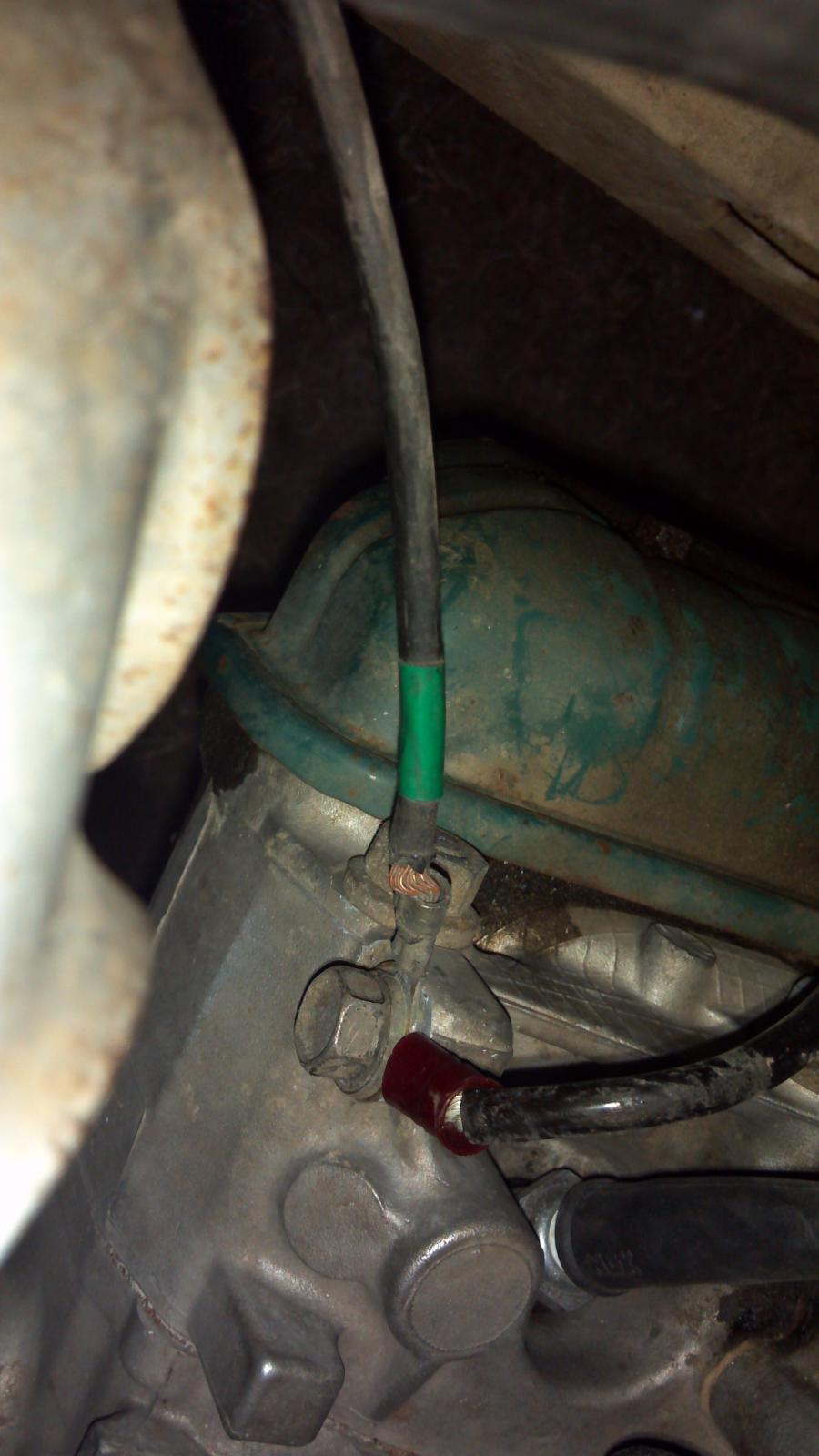

  15. I have replaced plugs, cap, rotor, plug wires(twice) i have cleaned the ground on the front passengerside head. cleaned ground from batt. to body. added a ground from back of motor inbetween bellhousing to body. the pickup being worn makes sense. mine just went out. still waiting on it. once i get it replaced ill see if it still happens.

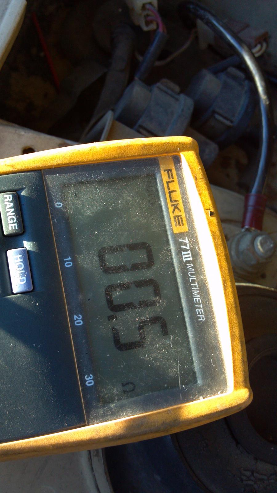

  20. With the ohm meter between the hex and head. Good or bad?

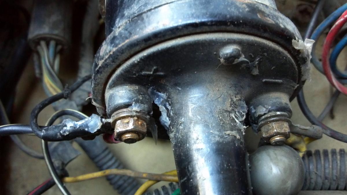

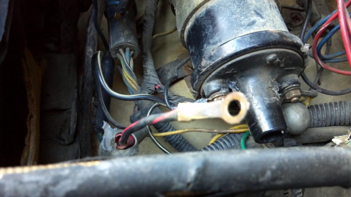

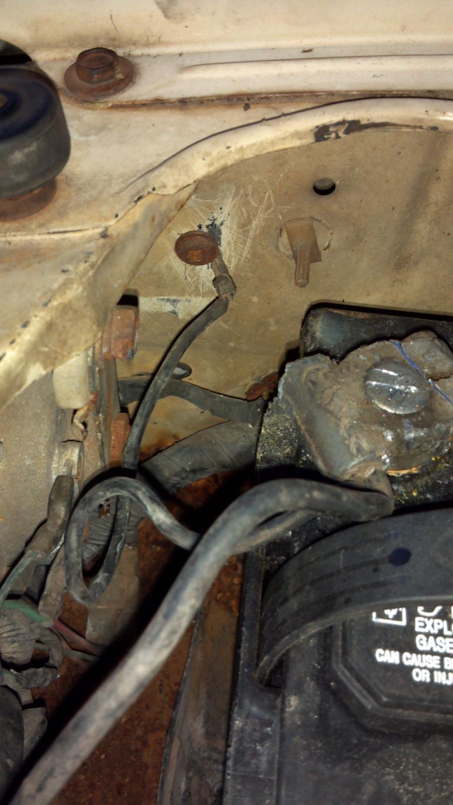

  21. Coil to body is good. All the grounds i can find are good. I found one engine ground that goes to the negative side of battery. The battery then has a smaller gauge wire going to the inner fender. I added an 8 gauge ground wire. Still have the same problems. I did some reading on coil wires and found that the coil has two yellow wires on the negative side and two black with white and a solid black on positive side. My coil has those wires. Except i also have a black with red on the positive side. Anyone know what the black with red? I took it off and everything still works. The black with red has no + volt at any time. Its not dark enough to see if i have the same arcing problems. Any help id appreciate.
