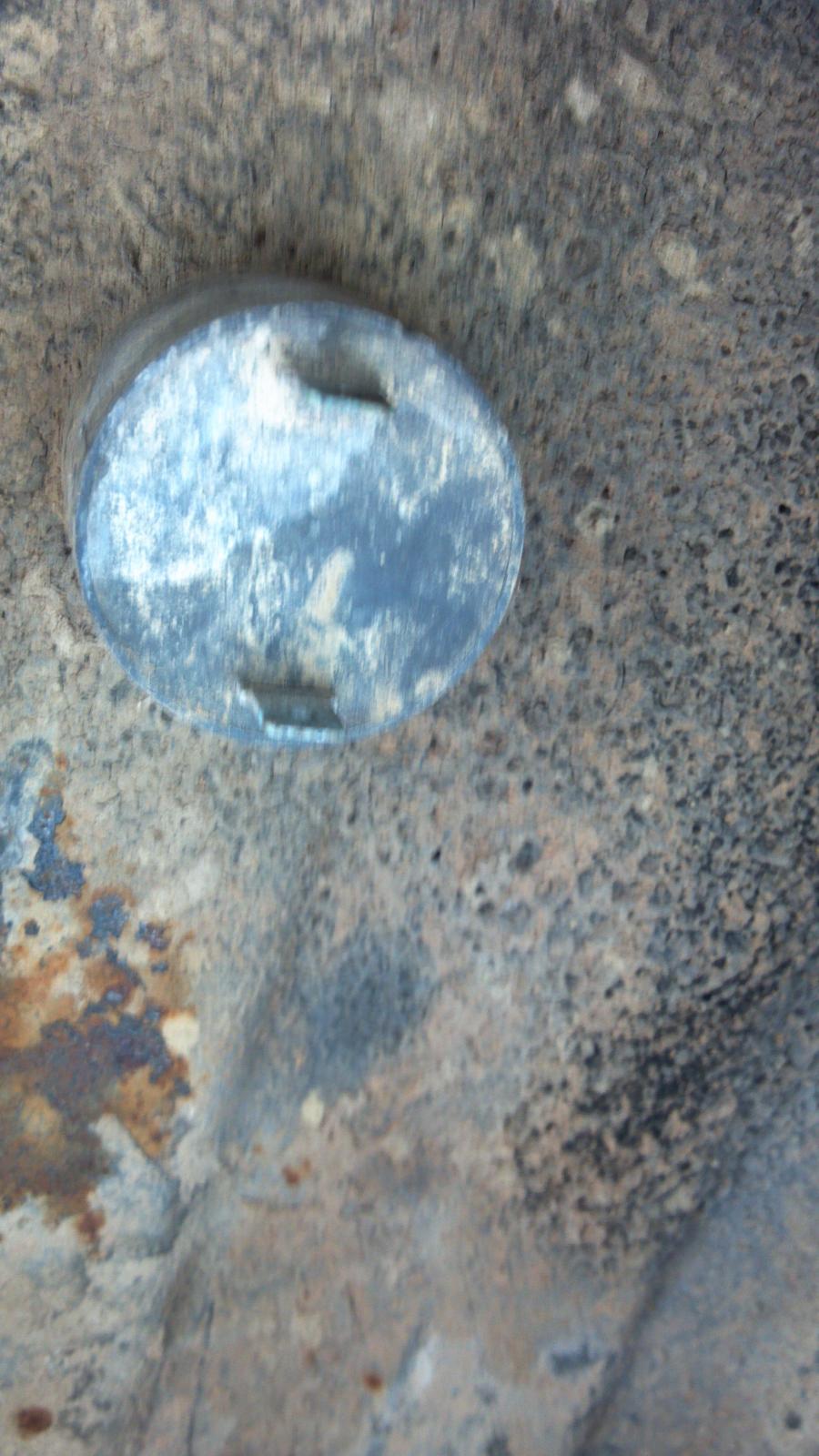

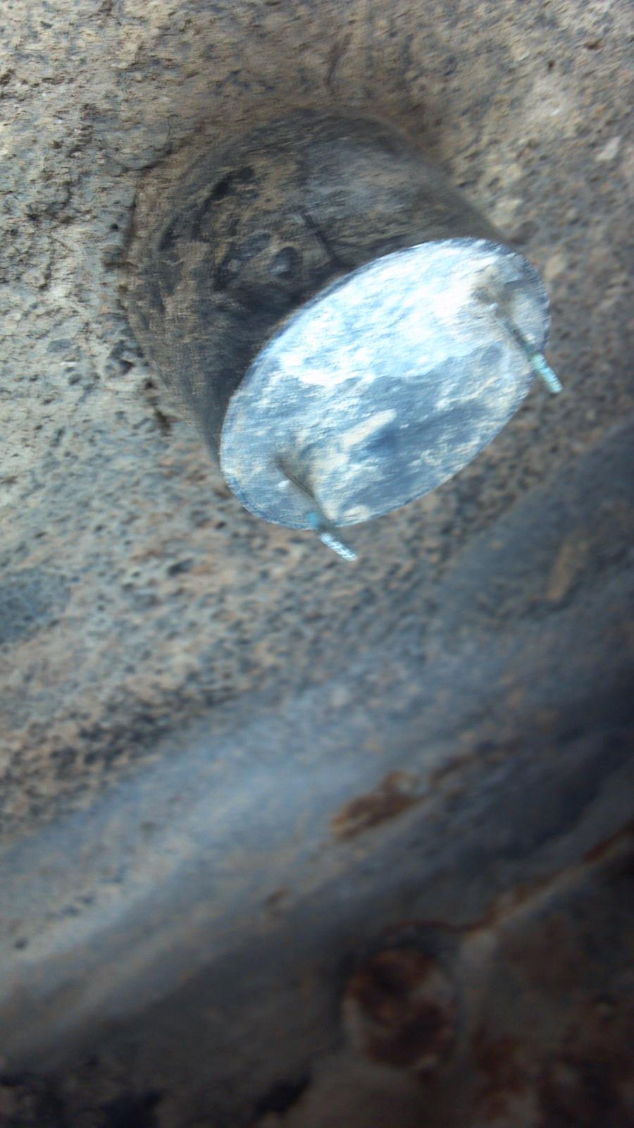

  16. Anyone know what this is? Its under the car behind the driver side back tire by the muffler. 81 dl 4spedd 4x4
