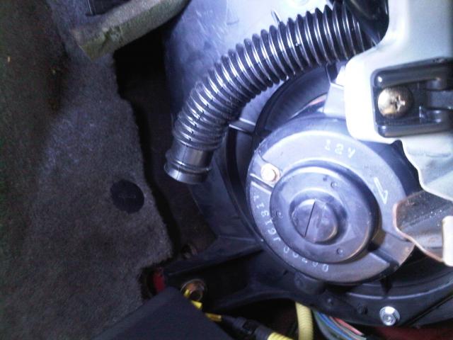

accordion tube under glove box
Anyone know what this and whether it should be connected at both ends? Out of view there's a 90 degree bend and it is hooked up. This is from a 96 outback wagon under the glove box. I did some searches on line but didn't find anything. Thanks.
