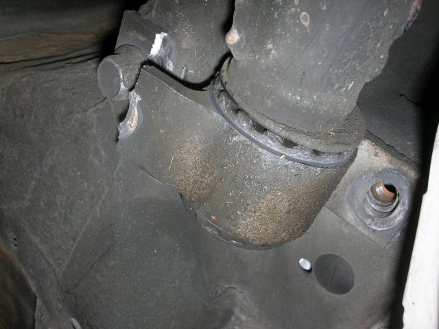

Crosswind stability issues 97 Legacy L Wagon
jamesm113 replied to jamesm113's topic in 1990 to Present Legacy, Impreza, Outback, Forester, Baja, WRX&WrxSTI, SVXI did get that fixed. Had to get a time sert installed where the bolt fell out and had to replace the mount Ahh, this is why i get confused! Anyway, the crosswind issues existed before the damage to the A arm. I don't think the poor SAI angle made it any better or worse.
jamesm113 replied to jamesm113's topic in 1990 to Present Legacy, Impreza, Outback, Forester, Baja, WRX&WrxSTI, SVXThe rear of the passenger control arm was loose. See attachment. Does FL mean driver's side or passenger side?
jamesm113 replied to jamesm113's topic in 1990 to Present Legacy, Impreza, Outback, Forester, Baja, WRX&WrxSTI, SVXBump? Anyone have any tips or clues?
jamesm113 replied to jamesm113's topic in 1990 to Present Legacy, Impreza, Outback, Forester, Baja, WRX&WrxSTI, SVXYea, I noticed that, too. What would likely be bent? The strut? Wheel hub? However, I've had the crosswind problems before the SAI loss.
