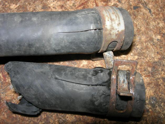

I didn't have to have to drop the cross member to spot my leak. Follow the air ventilator hose from the filler neck. On the other side (interior side) of the wheel well is the first spot it connects. Mine was cracked there. Then, there are a couple holes in the middle of the cross member. You can spot the other end of the hose through those. It's behind the filler neck tubing. Mine was cracked there as well.
Thanks Fairfax, those couple inches was enough to get the hose out. Gas cap is fine though. Both ends of the hose were cracked. Since it was a 5/8" hose made by Gates, I don't think it was factory installed, and I bet it being the wrong hose and size had something to do with the premature failure. EDIT Hose is Subaru Part Number 42162AC030
I think I found the leak, almost by accident. I was originally on planning on taking the car into get smoke tested today, but since I had the canister out, last night I figured I'd give things one last try when I was putting it back in. I had a friend attempting to pull a vacuum from the purge line in the front of the car, while I laid underneath the canister, plugging the vent line with my thumb. Since this took a while my eyes started wandering and a cracked hose miraculously caught my attention. The hose was the air vent hose, in between the gas tank and wheel well. It's pretty far in, but of course, I now feel like an idiot for not seeing it earlier. The side closest to the wheel well had some cracks around the hose clamp, with one extending about 1/4" towards the middle of the pipe. The other end, which attaches to the gas cap (you can spot it through one of the holes in the rear crossmember) had about a 1/2" crack. Anyone know if I can lower the rear crossmember a couple inches without removing anything but the 4 bolts that attach it to the frame? I just need a couple inches to work.
