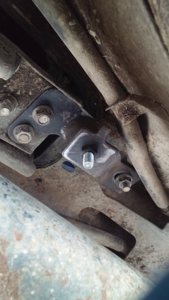

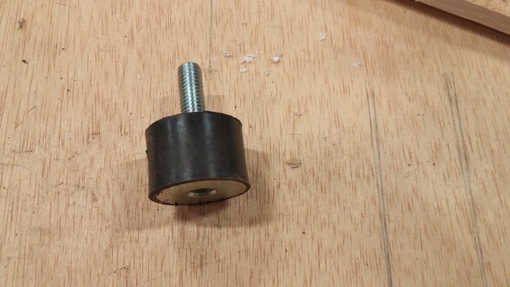

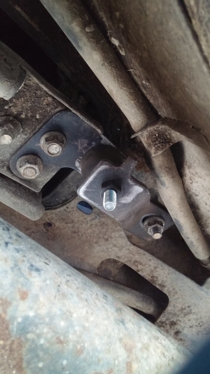

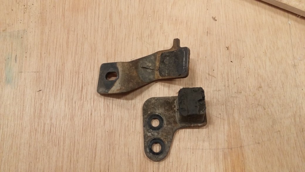

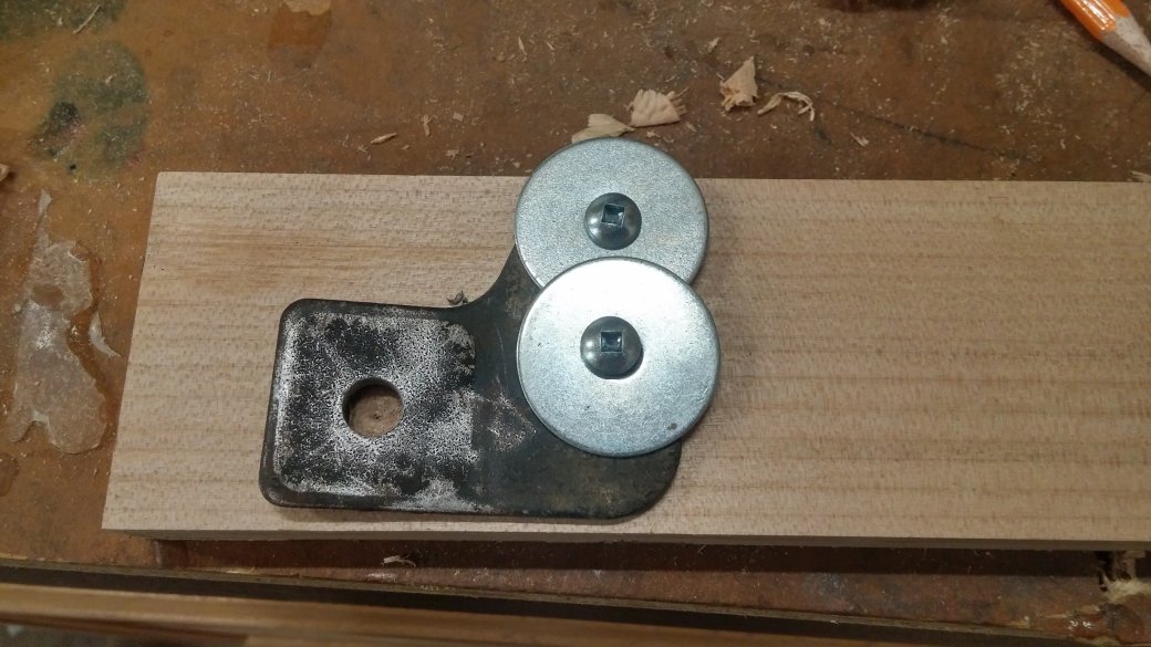

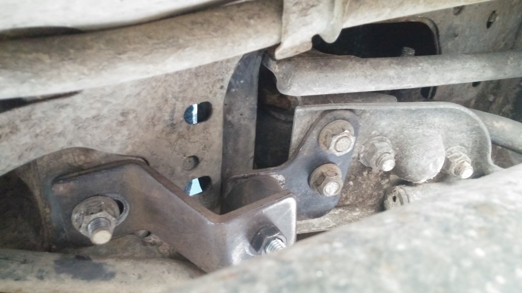

So the shift mount on my 87 GL broke and I would like some input on my fix I Found this online, I don't have a welder so bolt on is great I scarped the old rubber and sent both side through the drill press. This is how it fits. I plan on painting it at some point but is seems to be working What do you guys think?
