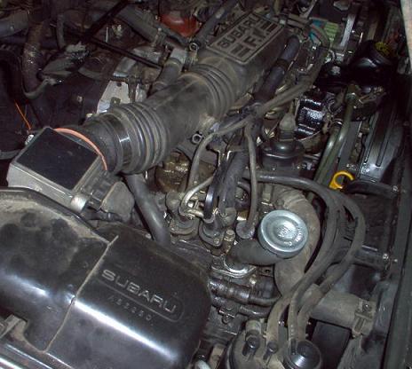

TOD?? Yes, I Might be able to record the sound but I can't do that until tonight. BTW I'm attaching a picture of what this setup looks like. if you look closely you will be able to see the MPFI injectors under the mess. and you can kinda see how I adapted the SPFI intake tube to the MPFI Thottle body and MAF. Also notice that there is no turbo on it.

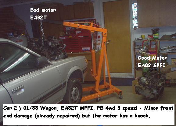

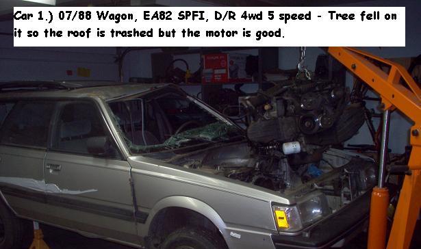

I need some help here! I've acquired (4) subies in different conditions to try to make two good cars to maybe keep or resell. (probably resell) Car 1.) 07/88 Wagon, EA82 SPFI, D/R 4wd 5 speed - Tree fell on it so the roof is trashed but the motor is good. Car 2.) 01/88 Wagon, EA82T MPFI, PB 4wd 5 speed - Minor frent end damage (already repaired) but the motor has a knock. Car 3.) 01/89 Wagon, EA82 SPFI, D/R 4wd 5 speed - Rear ended so the body is trashed but the motor is good. Car 4.) 10/89 Wagon, EA82T MPFI, Auto 4 speed - nice body but the motor has a hole in the block. I bought them from "ddog87" which is a 4 wheel'n buddy of mine. His post about the cars when he had them is here. http://www.ultimatesubaru.org/forum/showthread.php?t=66717 And I started a post about Cars 3 & 4 here since I was concerned about the auto to manual wiring harnesses: http://www.ultimatesubaru.org/forum/showthread.php?t=66887 Anyhoo, I figured I would start with the first two manual transmission cars {EA82 SPFI, D/R 4wd 5 speed} & {EA82T MPFI, PB 4wd 5 speed} since they should be the easier ones to swap. So I pulled both motors, wiring harness and ECM's. Last night I got the EA82 SPFI motor, harness, ECM installed into the Turbo P/B 4wd Wagon. I compared the harness before I installed it and there were some major differences (one large plug under the dash, the 4wd Push Button solenoids and one tranny plug) So I swapped over the 4wd Push Button solenoid plug and I installed it hoping it would work - knowing that I probably only had about a 5% chance of it actually working. but I had to try since I had everythign torn apart that far. Well I it cranks over but thats it. I have no spark, no fuel pressure and no power to the ECM. Basically I've determined that its NOT plug and play even with swapping of the wiring harness back to the ECM. So where do I go from here? Looks like I have a few options. A) Try to hardwire power to the ECM and see if I have spark then? How would I do that? my book shows a Red/Blu is the power to the computer but there are several wires with that color in the harness. Does anyone have a labeled Schematic for the ECU plug wires? Swap over dash harness and see what happens - which might eventually mean I will also have to swap Trannys, CV, driveline and rear diff. C) Swap the MPFI harness back into car and make a high compression SPFI motor (remove turbo stuff) using MPFI heads? D) Give up and burn them to the ground...- D/R EA82 swap into AWD Auto EA82T ??
