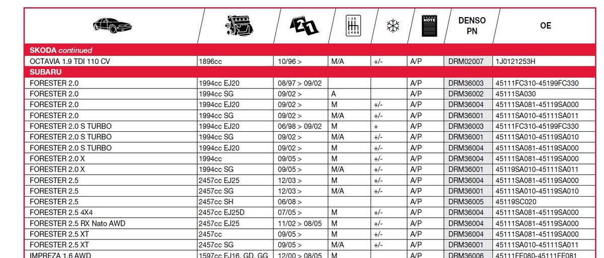

turboguzzi replied to Stevo F's topic in 1990 to Present Legacy, Impreza, Outback, Forester, Baja, WRX&WrxSTI, SVXhad the same problem with my 05 forester, slow leak from the seam, there's no good repair for that. managed to find a Denso DRM36002 radiator (OEM quality) for around 150 euro, (about 160 $), really easy job to change

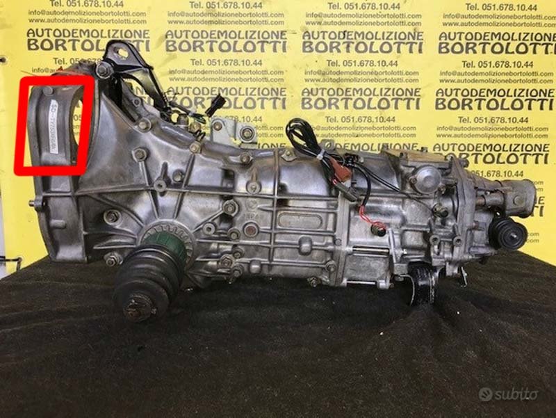

turboguzzi replied to turboguzzi's topic in 1990 to Present Legacy, Impreza, Outback, Forester, Baja, WRX&WrxSTI, SVXHei Texan, checked out that car-part.com site, serves only north america, USA, CA, MX, not Italy Will gonna drop by my trusted mech thursday, but preparing myself mentally for a "gearbox gone" verdict..... Is there a way to tell from outside the front diff ratio? im pretty sure this is same as mine as in italy there was really just one version of the non turbo 1st gen sold. wonder if the white label (red area in pic) can say which ratio is in there.... https://www.subito.it/accessori-auto/subaru-forester-cambio-usato-subaru-ej20-bologna-312421015.htm?from=areariservata

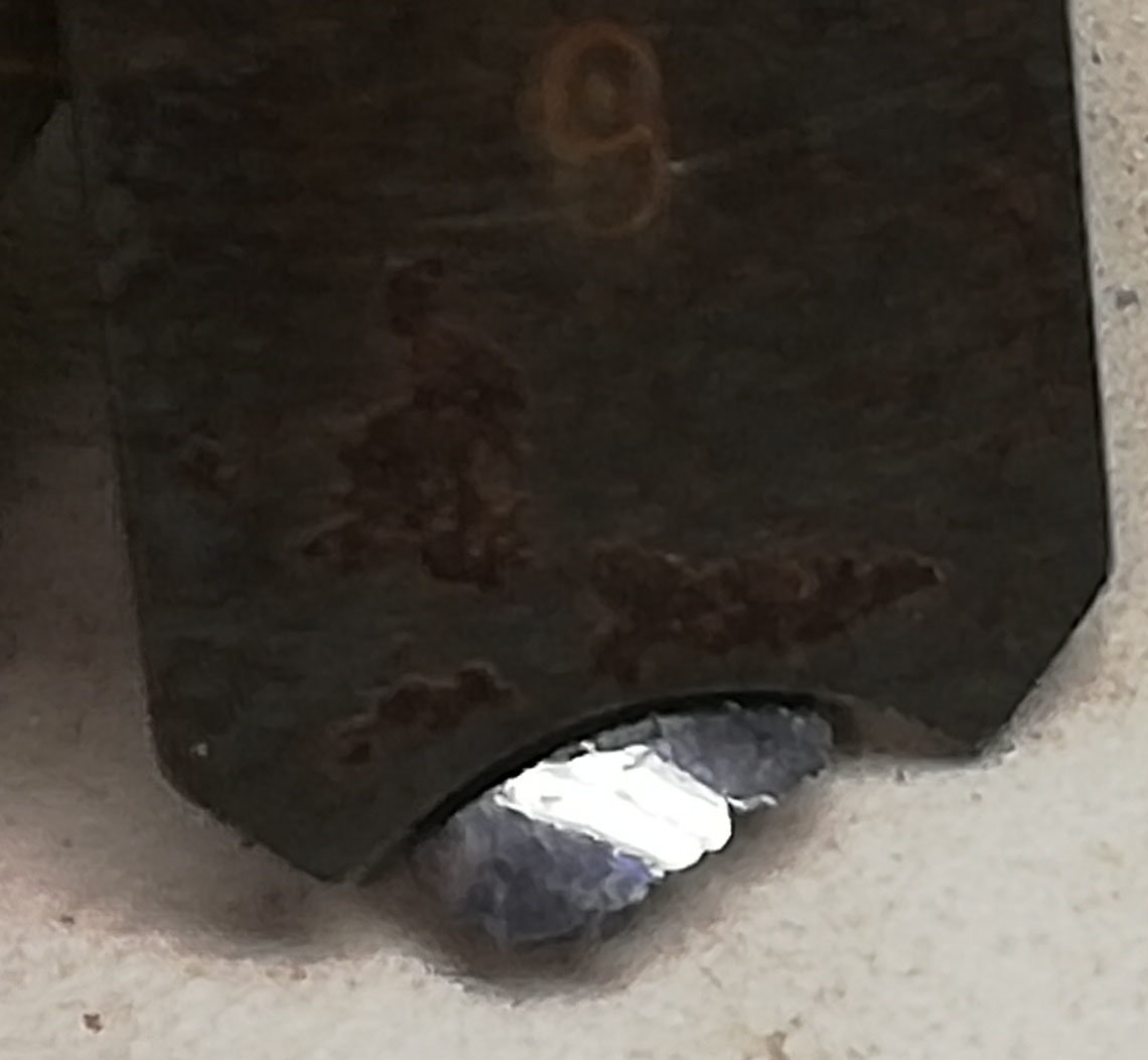

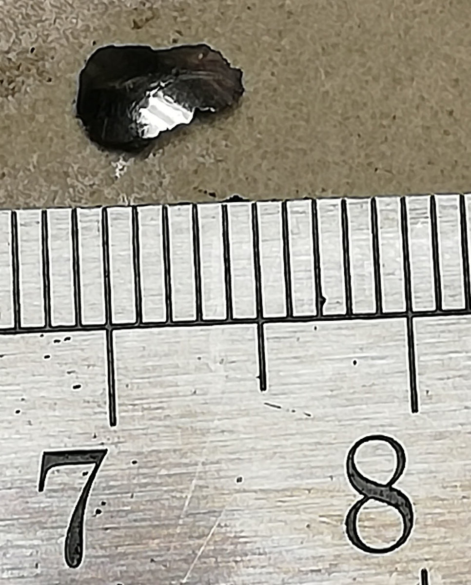

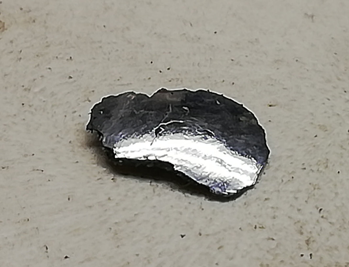

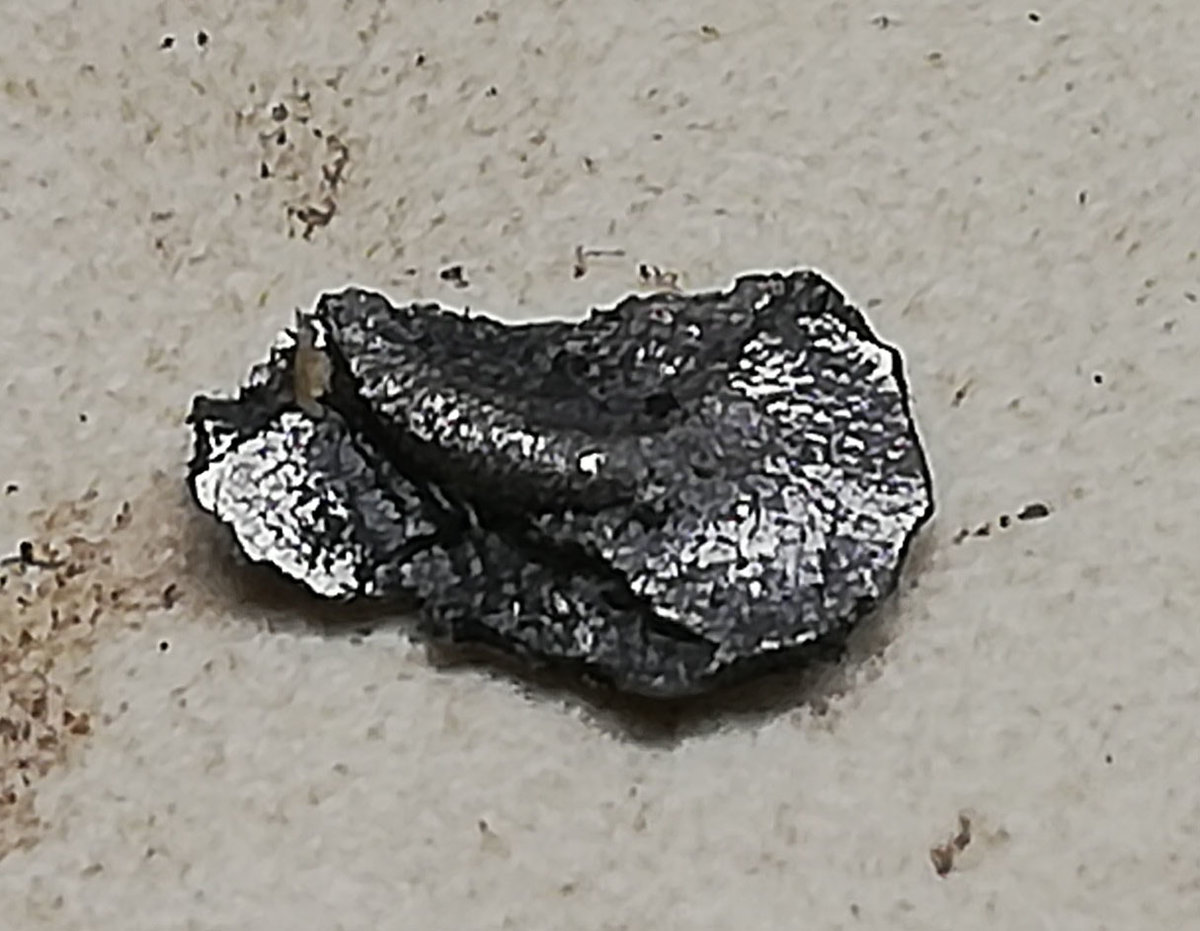

turboguzzi replied to turboguzzi's topic in 1990 to Present Legacy, Impreza, Outback, Forester, Baja, WRX&WrxSTI, SVXTnxs for the info guys. As for your questions: All gears slip in nicely, no slip out of gear, oil was clean and nice, most of the 4 liters that go into an 5MT went out, collected about 3.5 Can add that while driving in all gears, noise only present when pressing the on the gas, no noise when coasting. The cyclic thing sounds to me too like a bearing From previous experience, is damage usually limited to just the bearing? or likely i need to change some gears too if i decide to open the box? cheers back
5MT ouch....
Noise from the 5MT box is never a fun thing to sort, but this weekend I had some time to do some pocking on my GF’s 99 forester (120K miles). It is a light to medium grind/rumble/whine, very similar to an old rear drive car with a worn rear diff, but comes from gearbox / center of car. It is cyclic, not steady, sort of wa-wa-wa. I can hear it also in while in neutral, goes away if I press the clutch pedal. Then, while driving, whine gets louder but not excessively and is present in all gears, from 1st to 5th. I drained the oil so to check for stuff attached to the magnetic plug. Was half expecting to find quite a bit of shavings, but actually there was very little of stuff that could come from a failed gear, BUT, there was on the other hand, a shiny broken piece which on the external face is spherical, and on the internal side , looks like broken off form somewhere due to fatigue. Was suspecting it was coming from a ball in a bearing, but too big…. About 1/4 “ long, and also the radius is too big. Any ideas? So something is amiss with the box I’d say, just trying to decide how much I can wait, and if try to find a used G/B and do a quick-ish swap or try to open it and fix, no idea what I will find inside… I’m an expert motorcycle mechanic, can do top to bottom overhauls on anything wiht two wheels, but not sure I have the means to handle a huge gearbox repair (got no press) and the time to stop the car for long while DIYng the box. Your opinions are welcome…. Tnxs
