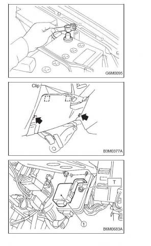

  12. thanks for the inputs again now the big question..... am not really interested in having delayed/timed door auto locking in the first place !!!! and my gen 1 didnt have it either no kids or other such dangers, so is there any way to simply bypass the thing? will try to dig deeper into the schematics but maybe someone has already managed to. Cheers TG
  13. OK, found some threads but the odd thing is some say timer is on the passenger side, some on the driver side fsm shows it in the driver side for a 97 at least....
  14. thanks gary had this in my sights too, but somehow it seemed to me it was a mechanical issue with the switch looking at the fsm, the timer is surely easier to reach, so might tackle that first! TG
