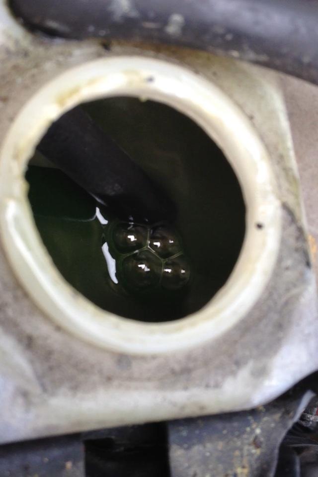

This was after a half hour drive. Bubbles popped up one by one, but quickly stopped altogether in less than a minute. Could it just be from driving vibrations or head gasket?
Did the upper rad hose check this morning. No pressure in the hose after a short while running.
Should have also mentioned earlier that when the engine is cold, it has a strange idle. It will idle fine, sound like its stalling then quickly rev to about 1000 rpm, then steady out. Happens about once or twice a minute until it warms up. Thermostat?
No bubbles in the coolant resivoir with engine running, ill do the hose test tomorrow morning. Still nothing from the right fan, even with a (very) warm engine and the AC on. Would a faulty thermostat cause an innacurate reading on the gauge? Seems a lot warmer than what it shows. Does anyone know what the temp would be normally? I find the fact that the gauge is unlabled annoying.
Well it was previously owned by the "little old lady." It has just ticked over to 77,000 yesterday. Don't think any things beig covered up or hidden. Yes it's an EJ25D, I've been worried about head gaskets for a while. It could be the thermostat, not sure. Also, are both cooling fans supposed to be running at the same time? The left one is the only one that runs. I know they have problems with the connectors being too exposed on the bottom, haven't gotten time to check and see if any connections are good. I'll to the head gasket test when I have a chance. Thanks for the advice everyone! (Knew I shoulda got the 2.2... Lol)
