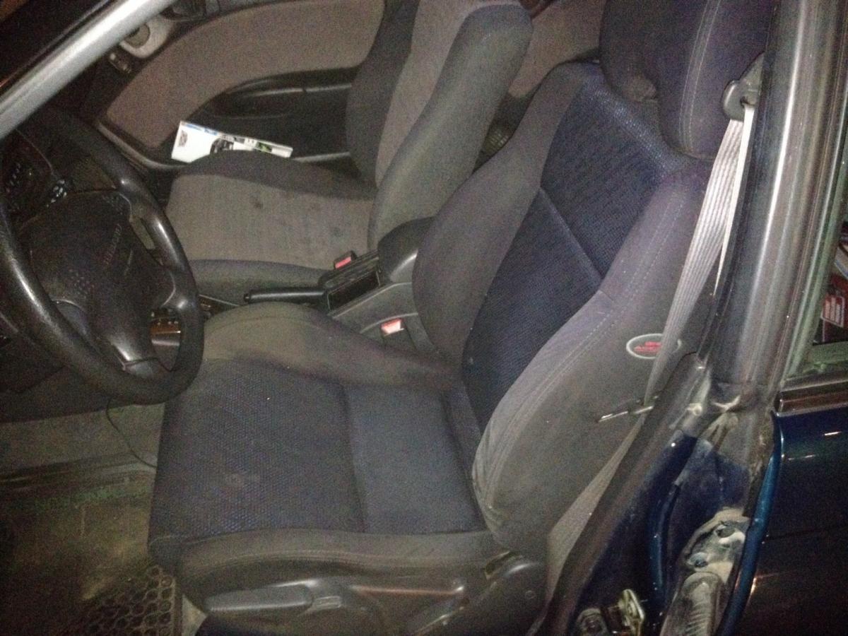

Got a pair of seats, put the drivers side in tonight. All went smoothly apart from having to use my origional seat belt buckle (and being too tired to notice until after the seat was bolted in place) and the WRX seat has an airbag inside it. I had to cut before the connector, so i simply covered and isolated the two wires. (If anyone can tell me how to disconnect that connector, i would really appreciate it! I always have bad luck with connectors and that one has me stumped.)
