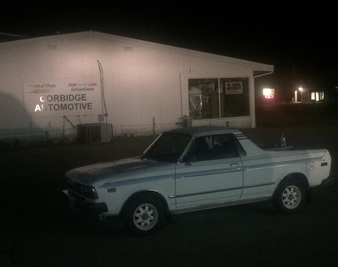

Tom, that's crazy! I stopped at a shop in Niles called Corbidge Automotive - a fellow by the name of Mitch helped me out and he couldn't have been nicer. There's a Route 66 right next door to the shop that I set up a tent behind and crashed around midnight. At 7am, I packed everything up and stuffed it in the Brat. Within 5 minutes, the sky completely opened up and I thanked my lucky stars for the timing. There's no way my $30 tent from Walmart could have withstood the fury of that storm!

Turns out I had play in the tie rod which got worse over time. That led to the pad slapping the rotor, warping it. The wobble in the tie rod messed up the wheel and when it was all combined, I got the violent shaking. The garage I camped behind was able to machine the rotor and switch front and rear tires for me so I could limp across the border. Currently 200km from home waiting for CAA/AAA to come pick me up and finish the trip. I thought about trying to finish it on my own, but it's not worth the potential damage (wheel still wobbles a whole lot). Still, 2200 miles since Friday morning ain't half bad for this ol' Brat. I'll be ordering a new tie rod assembly from Rock Auto soon unless anyone can recommend another vendor I should check out. Thanks to everyone on the forum for all the help and advice - much appreciated.- Emergency! Gen 1 Brat bearing/brake/transmission question

Just looked at it with the shop - the rotor is out of round and there's some play in the tie rod. My hope is when combined - that was the problem. They're machining the rotor now and I'm gonna try to limp home with the (minimal) play in my tie rod. I'll be setting my God to avoid highways and keeping braking to a minimum. Goal is to get across about 40km's past the Detroit border into Windsor. After that I can call in a 320km tow from CAA/AAA. I'll keep folks posted.- Emergency! Gen 1 Brat bearing/brake/transmission question
