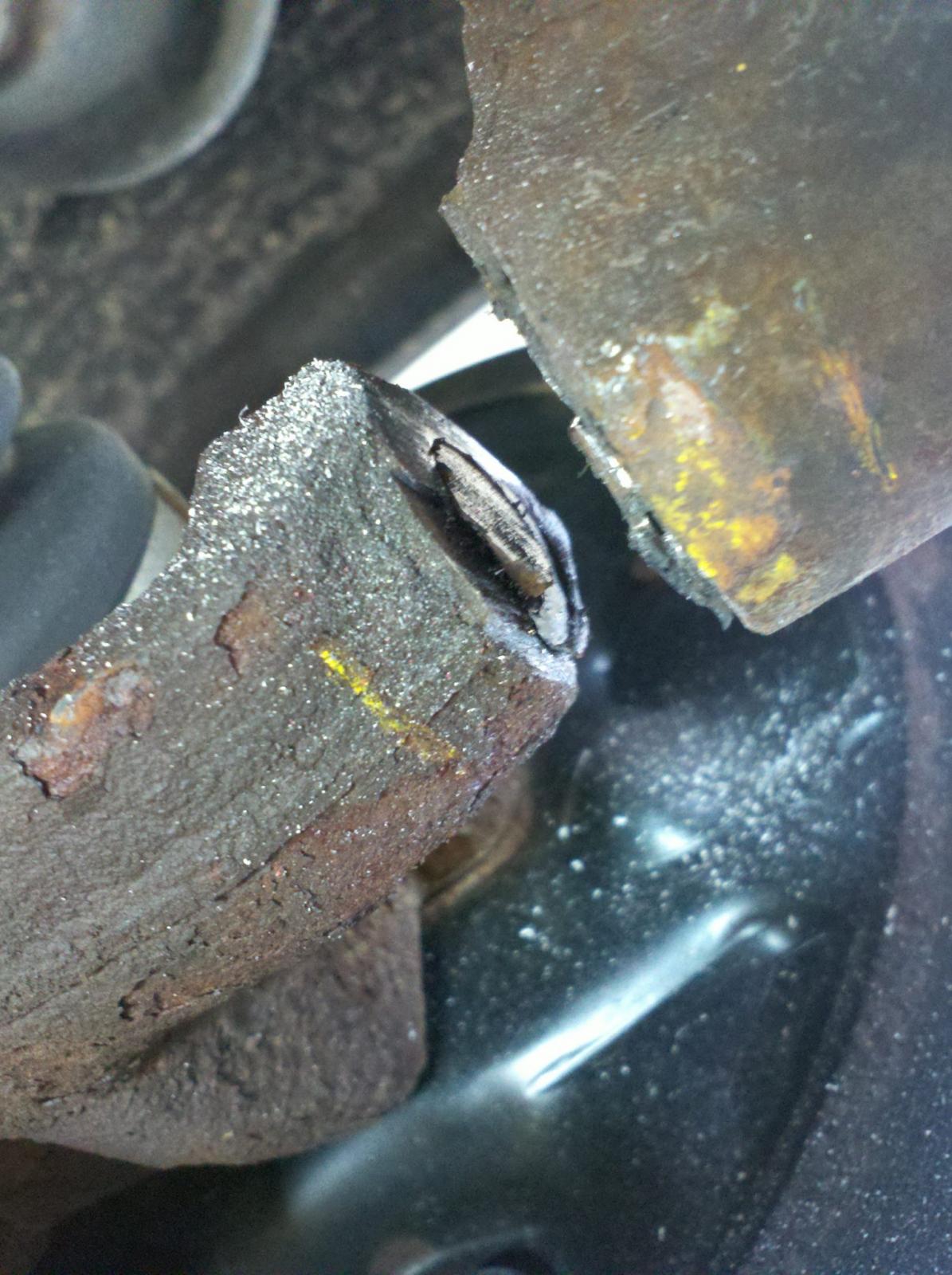

Lateral Link Bolt Cut Off, Knuckle Damaged, Doh!
stevetone replied to stevetone's topic in 1990 to Present Legacy, Impreza, Outback, Forester, Baja, WRX&WrxSTI, SVXThank you everyone for your help. I will grind smooth and continue. BTW, a Pitman Puller did a nice job on getting the bushings out of the control arms. I had rigged up a pipe and bolt solution on the first bushing, but ended up snapping the bolt. The Pitman was much easier. steve
stevetone replied to stevetone's topic in 1990 to Present Legacy, Impreza, Outback, Forester, Baja, WRX&WrxSTI, SVXThat sounds like a good approach. You are much wiser than me...
stevetone replied to stevetone's topic in 1990 to Present Legacy, Impreza, Outback, Forester, Baja, WRX&WrxSTI, SVXIt was a Chicago rental car in its previous life. They use a little salt on the roads there in the winter...You should see the outside of the brake drum! (Of course, Wisconsin, where I live, is not any better.) So smoothing it out a bit will not reduce the width enough to cause a problem? The other side I did a better job, so no touch-up would be needed there. Thanks everyone for your help! Hope to get to the actual project, replacing the bearing, sometime soon
Well, after wrestling with the lateral link bolt, aka "BAB," for 2 days, i went to Plan B--the reciprocating saw. All went well, taking only 15 minutes to make 2 cuts into the Grade 8 bolt. I had expected a much harder time of it, as I used some cheap blades I had laying around. *Only* went through 4 of them! Anyway, after feeling really good about that, I looked at the knuckle and noticed that I carved into it 1/16 - 1/8" or so. Photo attached. So my question is: If I grind that smooth, can I reuse the knuckle? Or am I just asking for trouble in alignment? So far, this *wheel bearing job* is more about battling rust than the actual bearing. I haven't even got to that part yet... steve 2003 Forester X
