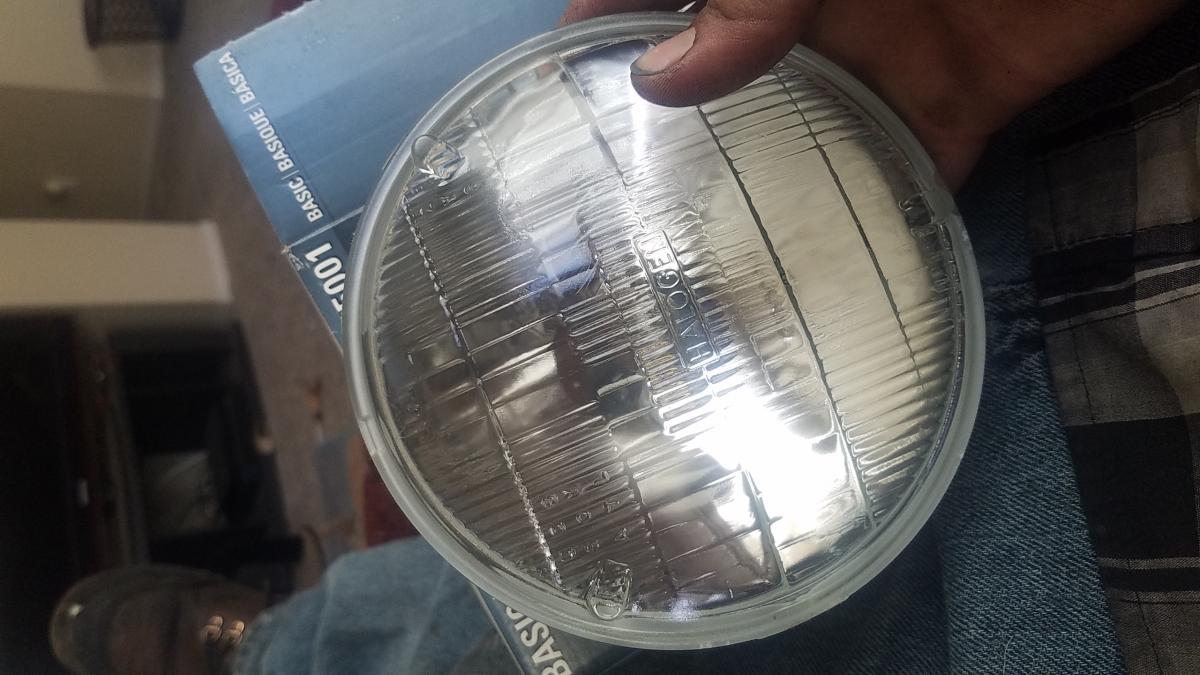

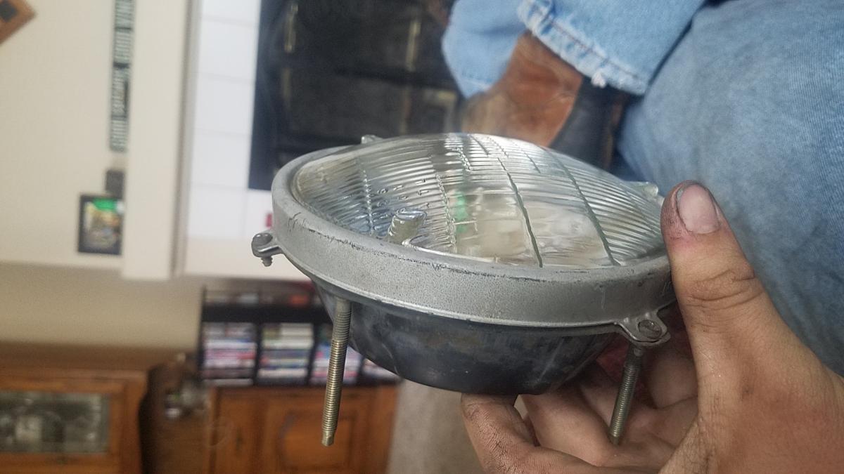

  21. Got these buckets today for the low beams, off an 82 3 series beamer hopefully have them mounted this weekend
  22. To fit the sylvanias the easiest bucket to find seems to be an e30 bmw. Going to the junkyard today
  23. Just for you my friend I went to oriellys on the way home found a set of 6 inch halogen in the back and got them, now I have to find cups in the junkyard or make my own and then run the Hella's as high beams and the Sylvanias as my lows
  24. Actually to remedy the whole thing I wonder if a Sylvania round is the same size, if it is I'll run those as low beams and the Hella's as high beams, that would be the best of both worlds. Legal low beams and I wouldn't be using highs around anyone else anyways. Good idea right? Anal saves me a bit of money
