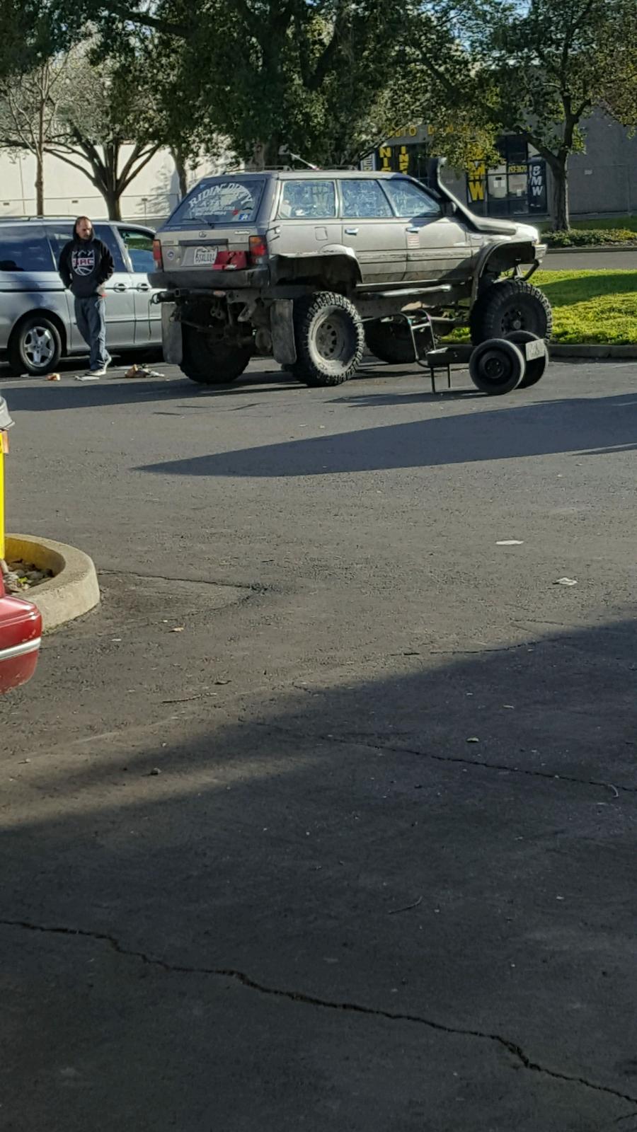

I've seen a guy put a loyale body on an explorer frame he lives up in Placerville or Roseville or somethin. I have a picture I'll post it when I find it -
