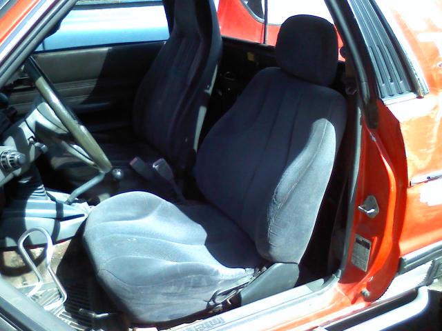

new drivers seat for me....
Looks good also. I drive a ton of miles and if I ever get rid of my Rx, the front seat stays :)
came out of a '95 Cavalier. it's very comfy....

compared to either an EA81 seat with metal sticking through into your side, or even the '90 Legacy seat it replaced... yes, very comfy :)
Doesn't look bad. Beats the standard EA81 side bolster blowout.

HOw did you fab that up.
4 pieces of 1/4" flat stock. drilled and bolted to the stock soob rails.
for the ea81 seat rails, I needed:
door side
1" center
2-3/8" center
console side
1.5" center
2-5/8" center
short pieces to the front of the seat.
both sides mount to the outside of the Cavalier mount holes. fronts straight out to the sides, backs angled.
