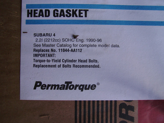

It said on the head gasket package, to get new bolts. What they told me in my automotive tech class was to never re-use TTY bolts, which IS what the EJ22 has. So my training is clashing with what a bunch of people on the internet said. :rolleyes:
I trust you guys, but I NEED this car to be right the first time :o
PS, i bought new bolts, but they were 100 DOLLARS! and i pay cost prices, not list! So i am ready to return them if i can
Is that a Subaru OEM package? You might try contacting a dealership service department and ask them what they do.

oh good, more information was exactly what we needed, this is making sense now. return the fel-pro gaskets and get Subaru gaskets, that's the problem.
torquing procedures are gasket-dependent. it wouldn't surprise me if they stamp that on every headgasket they make as a CYA. makes me wonder, i have a few fel-pro's for older engines that i know aren't to have head bolts replaced i might look at in the morning if i remember.
what the automotive classes don't tell you, because they can't cover that much material or specialize, is the idiosyncrasies of various manufacturers, parts, or specific engines. this is where boards like this are very helpful.
Subaru EJ engines are not forgiving of headgaskets so this is one case (pun intended? :lol:) where I would use Subaru OEM headgaskets. It's the EJ25 that's problematic but since Fel-Pro headgaskets are known to fail on EJ25's, I would not want them on any EJ engine.

that point is probably gasket dependent or at least it is in other instances. follow the directions of the gasket manufacturer.
it seems odd for Fel-Pro to say replace them...except as a CYA which may be why you and I both suggest they just sort of "put it on the package".

These are NOT torque to yeild bolts - in fact there are alternate methods used by many seasoned Subaru mechanics that use real torque values rather than the degree method. The bolts do not stretch - they are threaded into an aluminium block and would rip the threads out of the block long before the steel bolts "yeilded" from torque.

All my confusion about the TTY bolts came from this:
Do I still need to back off the bolts or is there another procedure i should be following? I'm at a standstill because i do not want to screw this up
follow the directions you're talking about, that's correct. 80-90 degrees, back off, then final torque, compare it to the torque procedures quoted on here often.
that's funny they print TTY on their packaging where have they been?
