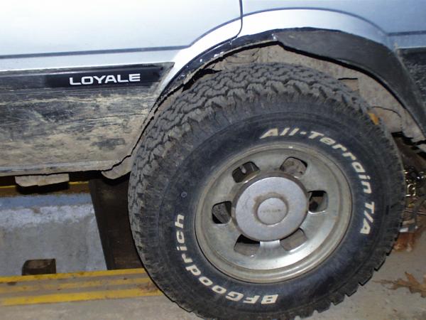

    Second on the Mitsubishi rims. Here's mine with a subaru center cap:   They have about the perfect backspacing to tuck the wheels without rubbing on the frame too bad at full lock. With 235/75r15'

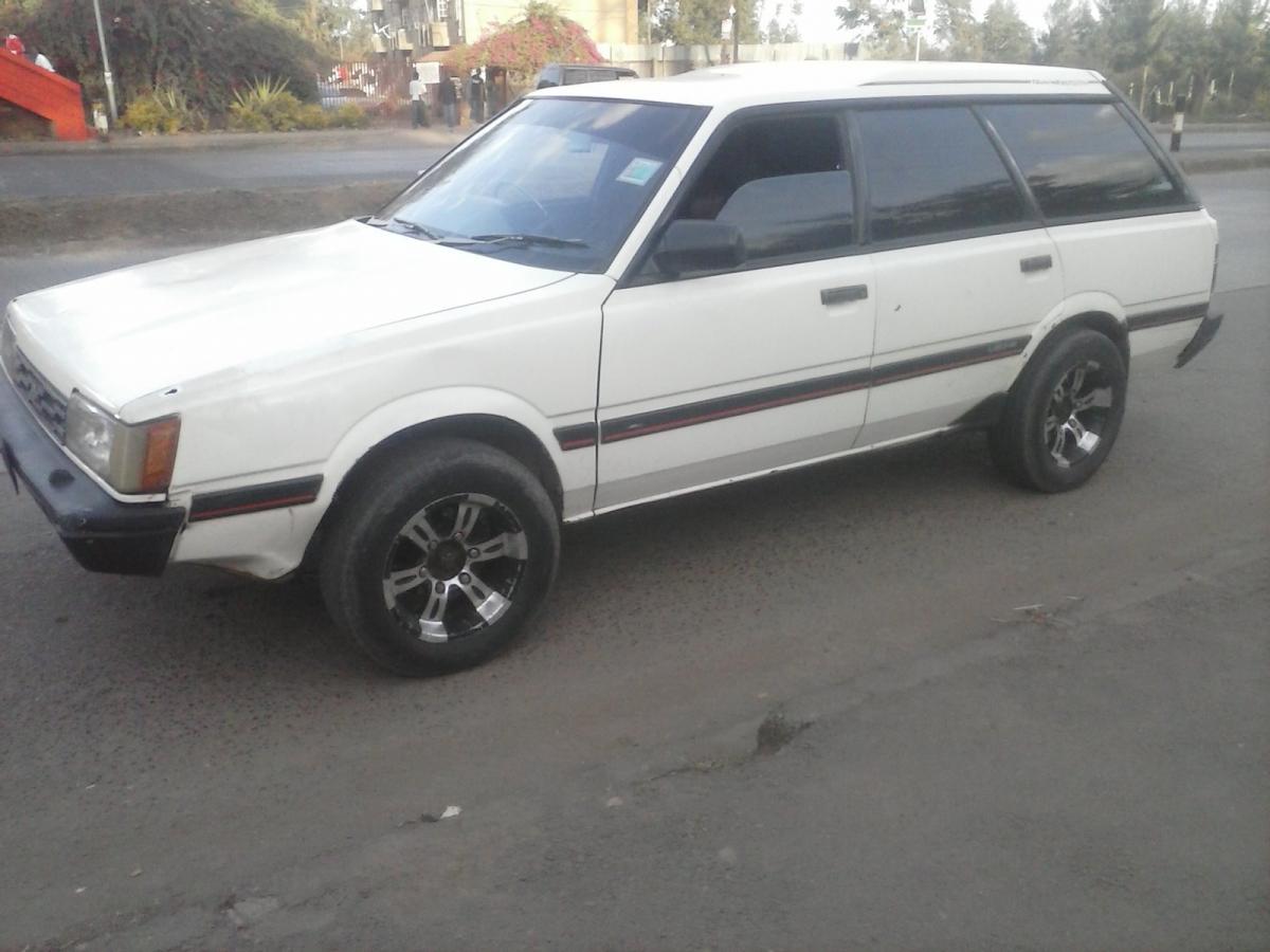

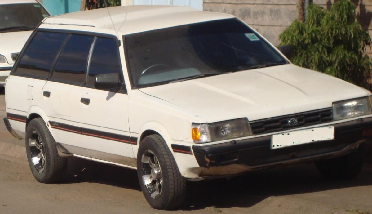

I recently got this car EA82T 1800ST
Decided to save it and pimp it. Got on USMB for info and ideas..
watched this video on you tube
Since i'm not going to be offroading alot i.e crawling on rocks, trenches, boulders n all, I got 1" spacers at the front and changed the springs at the back, got suzuki vitara springs which are about 1.5 inches longer and firmer than the Original soob springs....
Bought rims (14" Alloys from a Toyota Hiace), stud & bolts to fit, lock nuts, and re-drilled as in the video.. and this was the outcome :-)
