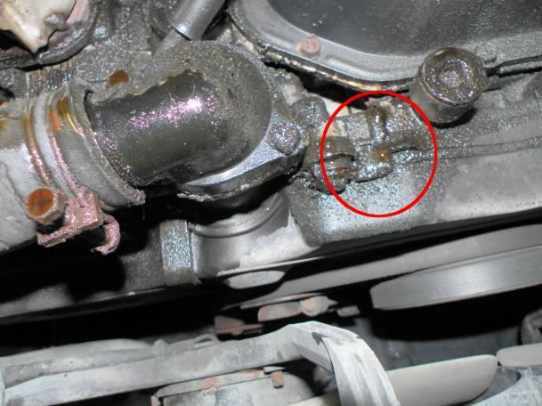

April 13, 201214 yr Ok, so my 95 Legacy wagon 2.2 has sprung a leak. It seemed for a while to have had valve cover leaks, as I could see the oil residue around the covers, and eventually it was (I thought) leaking down and burning, but now I am thinking it may have been the beginning of this other leak I am now seeing, a major dripping gusher. Unfortunately, the other day I was driving and didn't realize about the leak till I got home and major smoke was coming out from under engine etc. I checked oil and it was like 3 qts low. So my main concern is that I may have permanently damaged engine, though when I reoiled and started it it sounds normal. And where the leak is coming from, whether it would be a big deal to fix, or (hopefully) it would possibly be solved by timing belt kit/seal job? I've attached a pic of the spot where the oil is dripping from...If anyone could please tell me where they think this might be from? It seems to be between the oil pump and water pump, if I remember my timing belt install correctly on my old '97. Thanks '97
April 13, 201214 yr Probably the cam seal leaking and dripping down the inside of the cover. That's pretty low, but if you wasn't run that long or hard, you may be clear. I'd change the oil and filter immediately though. The oil that was in there probably got pretty burned, may even have some metal from accelerated wear. Since it's coming out of the cover, it's probably nothing more serious than a cam or crank seal.
April 13, 201214 yr I'd probably also change the timing belt. If it's leaking that much oil, the belt is probably covered. Oil breaks the belt down extremely fast, especially if it's already getting old and starting to slightly crack. The oil will destroy it. It's an interference engine, so you don't want to temp it to snap. Because it will...

April 13, 201214 yr check the oil pressure sensor under the alternator as it may leak and drip down in the same area.

April 13, 201214 yr it was like 3 qts low. ... when I reoiled and started it it sounds normal. this is why i love the 95 ej22 engine. it will take a lot of abuse. you will not really know any thing until you remove the timing cover. but chances are excellent that new seals, new oil pump o-ring and reseal will fix it. my son's 95 would leave a baseball size oil spot on the ground EVERY night. a cam seal had popped out of the head. it was cockeyed. i did the reseal and timing belt all is good. the oil saturation will shorten the life of the belt, but i don't think it will destroy the belt immediately. so you should definitely replace it, but these belts will go way more than the 60k miles. and usually it isn't a belt failure that causes a timing belt ''event'' usually it is the pulleys. i don't thinl i have ever heard of a belt failure due to oil saturation. but since your plan is to not drive the car, a good idea by the way, until you repair it this is a non-issue. i would also replace the PCV during the repair. they can cause a higher than normal pressure in side the crank case which MAY contribute to seal popping out, maybe. plus they are cheap. good luck.
April 13, 201214 yr If it is coming out that fast most likely the oil pump seal, but can be anything. Do a complete timing belt change, no cheating and that will solve the issue.
April 15, 201214 yr Author pardon my ignorance, but i only did the timing belt myself one time. the oil pump o-ring, that is only replaced if you take off the oil pump? I didn't do that last time, though I remember having the o-ring. i suppose then if you take off the oil pump you want to reseal the backing plate on it? Thanks again. '97
