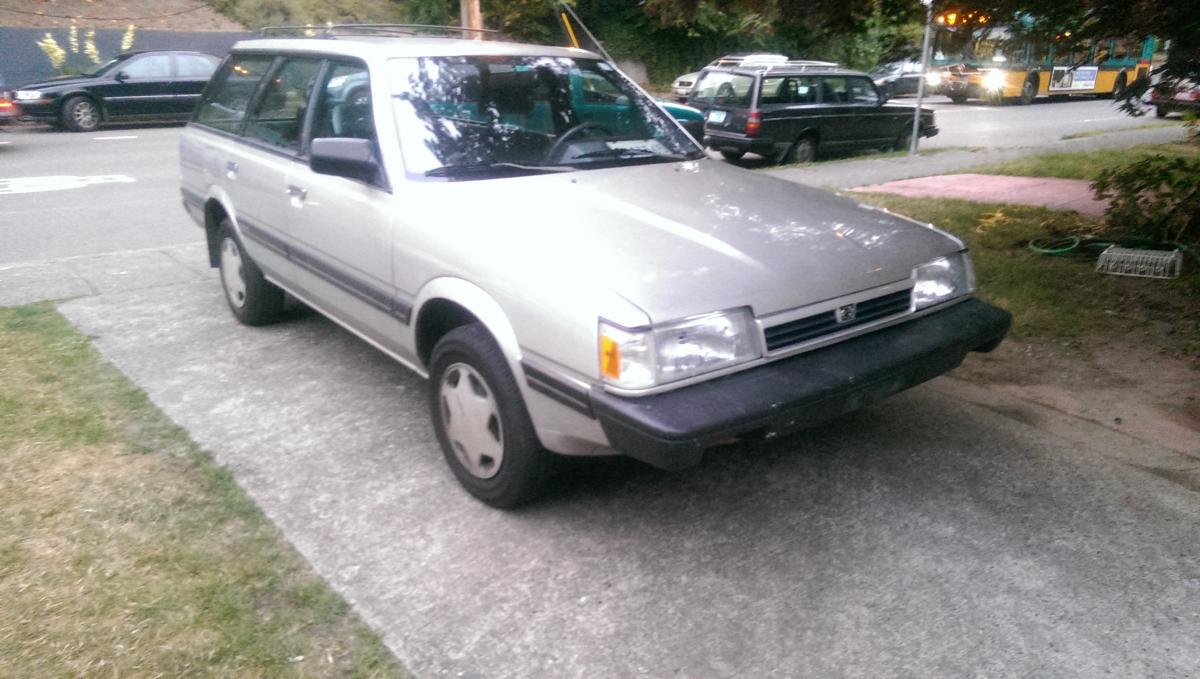

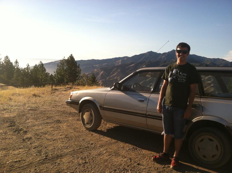

September 8, 201312 yr This is my '88 GL wagon. Picked her up in a car lot in Salinas with only 83XXX on her! It has the 3AT in it, and thus is a gutless wonder, but it'll go just about anywhere without complaining. Just not fast. Loose future plans for this wagon: EJ swap, 5spd DR swap, add a decent stereo, and find some different wheels. I'd like to keep it looking mostly stock because I bought it in such nice condition, but depending on how it looks after the body work is done I may also look for a different bumper. Unfortunately I was in an accident only a week after returning to Seattle. I'm in the process of replacing the fender and radiator. I pulled a fender from an '85 wagon I found in a pick-n-pull but haven't found a decent radiator yet.

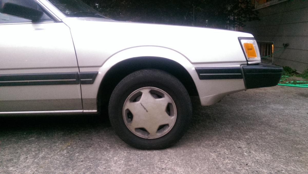

September 14, 201312 yr Author One new radiator, one new fender, and five pulls on the bumper beam later, the wagon is back up and running. Pic to come tomorrow.

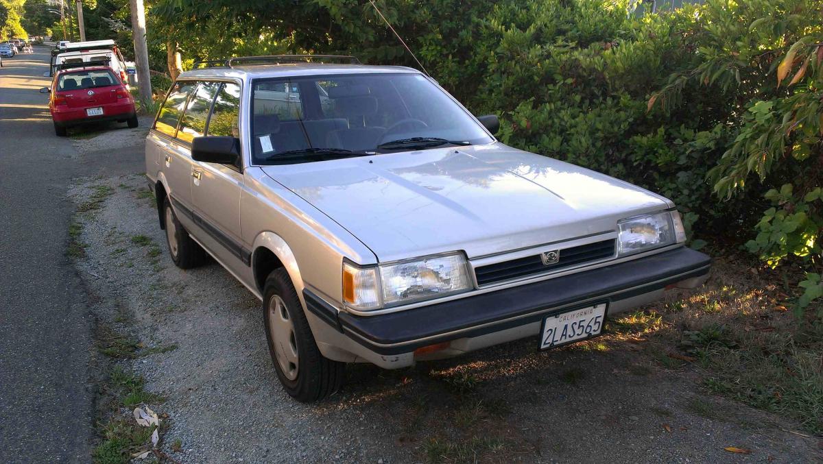

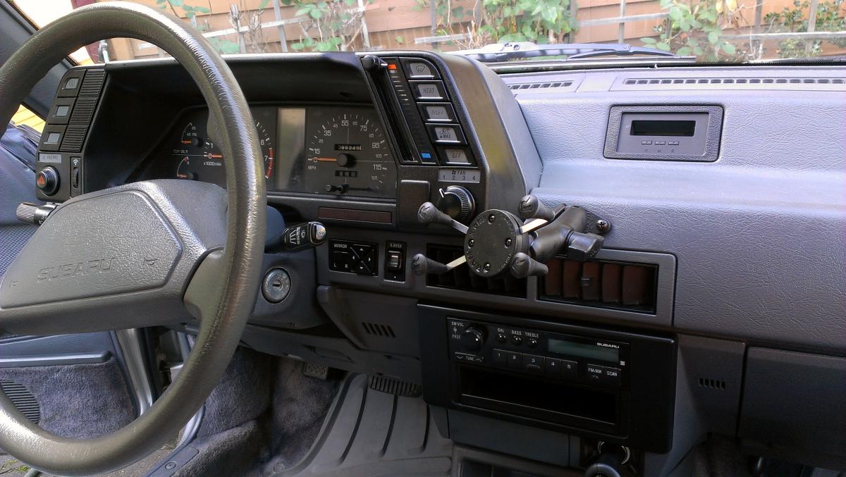

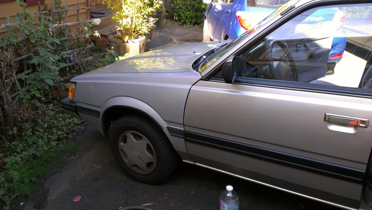

October 5, 201312 yr Author A bit of a delay on the update, been super busy these last few weeks. The Murray single row radiator seems to be keeping the engine much cooler than the OEM one, which is nice. The new fender is a slightly different silver, and the trim is a different size, but we'll just call it the jazz of car repair. I'll keep it like this until I can find a parts car or a matching '88 fender. Since my last post I've also installed a RAM mount for my phone/GPS setup, works like a charm. Did some detailing work today so the interior is looking pretty sparkly. On another note, can anybody comment on normal oil pressure ranges for the EA82? I just don't know what to look for. If it runs consistently at ~45psi, but starts around ~65ish, is that normal? Edited October 5, 201312 yr by thesmith

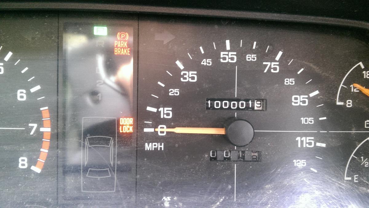

November 30, 201411 yr Author Joined the 100k+ club a month ago. Still running strong! A couple issues have popped up recently: The brake fluid light comes on from time to time. I check the master cylinder, usually put a tiny splash of new brake fluid in, and it turns off. But I think this is related to the fact that it's time for a brake job. AC doesn't blow cold at all. Not that I care for now, given that it's cold in Seattle, but it sucks in the summer. Given the complexity of retrofitting the whole system to run on r134, I might just get rid of it until I go for the engine swap. Also, my power steering pump looks leaky. Anybody know where to get a reseal kit? Work done recently: Driver's side valve cover gasket New Optima Redtop battery w/ Military spec terminals routine oil/filter changes Still waiting to do the rear disc swap until I can rebuild the old calipers and change pads/rotors. Edited November 30, 201411 yr by thesmith

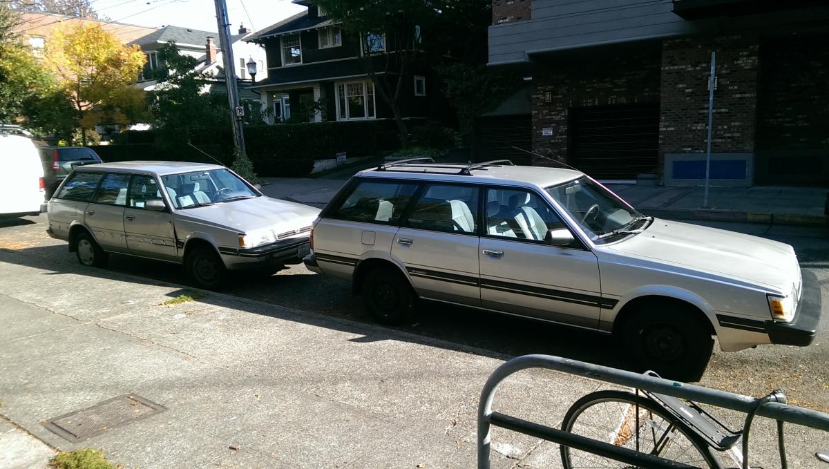

October 25, 201510 yr Author Hey all, been a while since I've posted here. Busy times. Recent work on the Doobaru: -Hacked in a new manufactured ACDelco 1991 Maxima alternator with some help from Autosport Seattle. I didn't feel comfortable grinding down the pulley spacer with the tools I had, so I took both alts, new and old, to Autosport. They did an amazing job, the Nissan alt almost looks like it came that way. I can't recommend them enough for machining work, and the attitude there is great. Love the shop, too, bits of MGs and Triumphs all over the place... but I digress. Since the swap, I occasionally get some belt squeal, but I've tensioned the belt with the alt to what feels like appropriate tension. My guess is that the squeal is coming from a leaky/otherwise unhappy PS pump... thoughts? I still haven't done any of the bushings or suspension work, I haven't had much time to work on the car these days. Oh well, still drives and runs pretty well! Here is my car next to a less fortunate GL wagon of the same color: [edit: for some reason I can't upload one of the pictures for this post, I keep getting a 403 error... ?] Edited October 25, 201510 yr by thesmith
