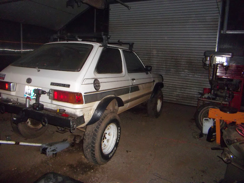

1986 subaru 2 door hatctback
turbosubarubrat

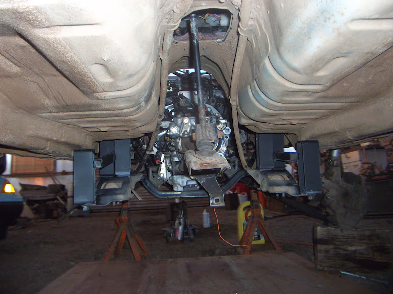

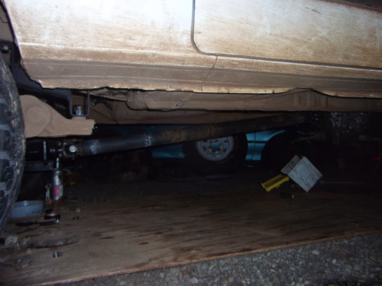

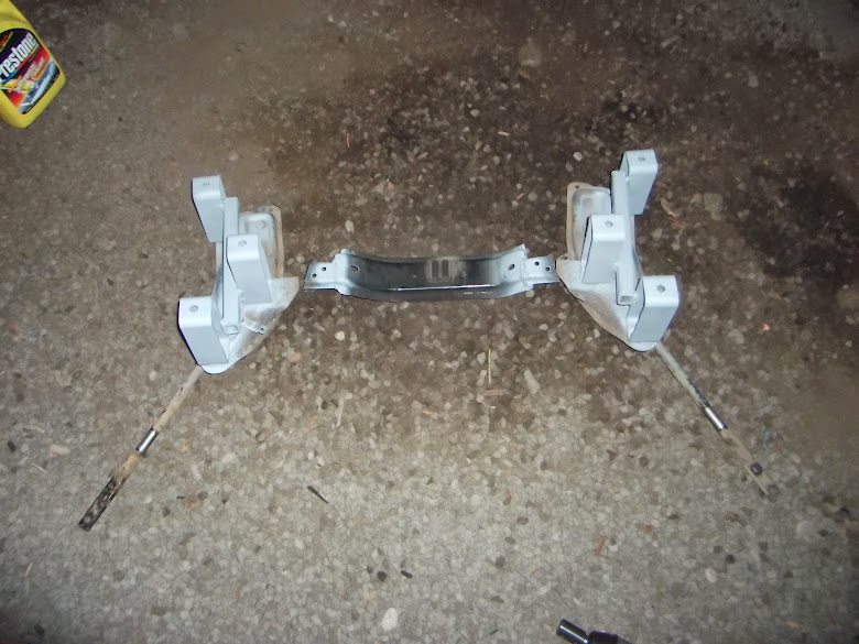

5 speed cross member welded together
Lift blocks braced

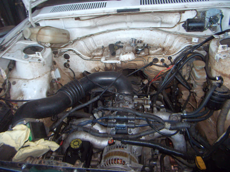

Engine and trans are in but ended putting them in separate .Put on a new oil filter and put in new oil. I need to get the trans cross member bolted up so i can find out what i need to do for a drive line. The drive line needs to go in so i can fill her will oil to start her up for the first time being ej'd. Still need to put the ea82 fi pump on and upgrade some fuel lines, front brake line extensions, shifter linkage, and a bunch of other stuff.DSCF6871.JPG

Fuel pump is fitted in and all new fuel lines and vapor lines. Power steering hoses are hooked up too with atf in them.

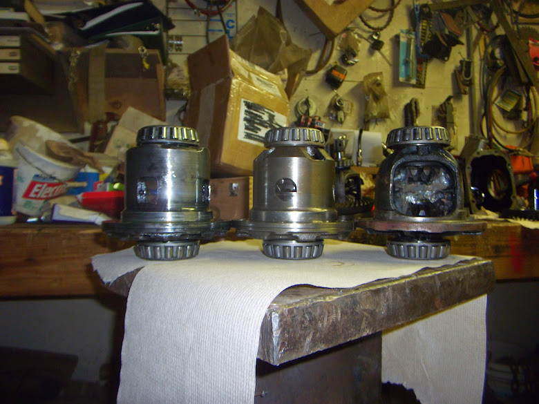

Vlsd, Clsd, and welded
Swapped in the Clsd carrier so now i have a 3.9 clsd in the rear.

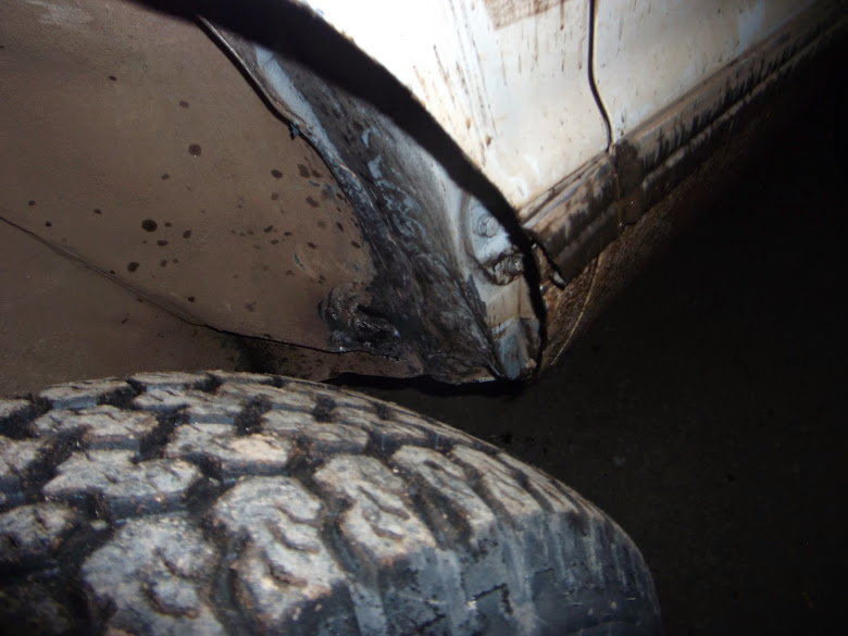

Chiseled/cut out the jack holder
