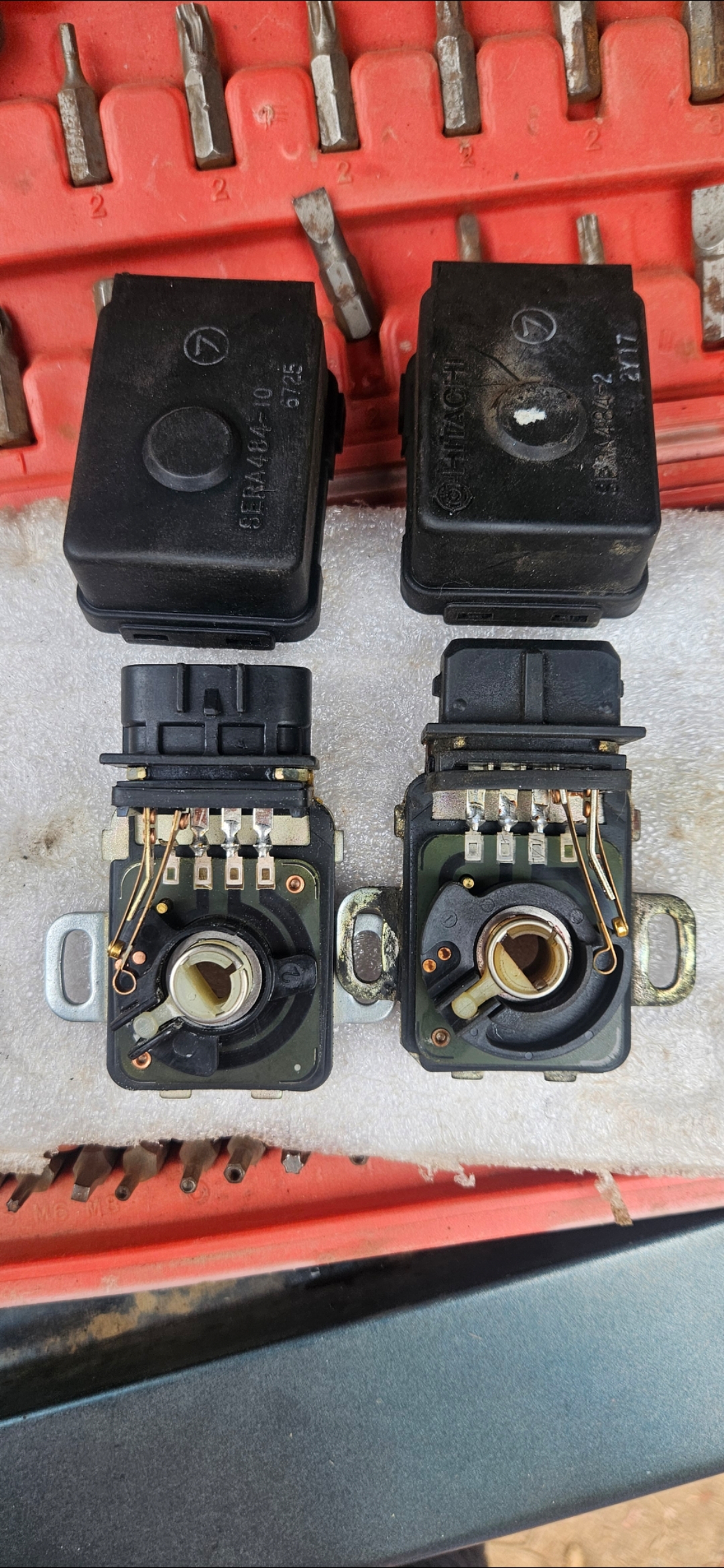

September 9, 20241 yr I saw somebody use a sera484-10 in place of a sera484-2 for a lotus on another forum. The connector for their car was different than ours and they had to swap it over. The Sara484-10 looks almost identical and is four pin for under 30$ does anybody know if the pins are in correct order or if they need to be changed to use on a 93 Subaru loyale / gl? Edited September 9, 20241 yr by Anthonyy
September 14, 20241 yr Here's a picture of both of them open. They are mirror images of each other so maybe if you mounted it upside down with spacers for the mounting hardware it could work
September 14, 20241 yr only problem I could see with My old one was between the spring contacts there was a carbon buildup.
September 15, 20241 yr On 9/15/2024 at 5:04 AM, Anthonyy said: only problem I could see with My old one was between the spring contacts there was a carbon buildup. And that would be your issue. Clean it up, reseal and go again. This can happen with EJ TPS units too. Once cleaned they work a treat again! Cheers Bennie
