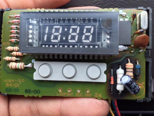

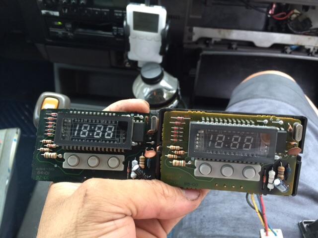

okay so what am i looking at? what do i replace? funny part is the one on the right (first picture) that looks burnt on the bottom right of the board is the one out of my donor (2nd picture) thats working fine, the one on the left is the one that sometimes works now. what do i replace so it can work for another 10years to keep as a spare?

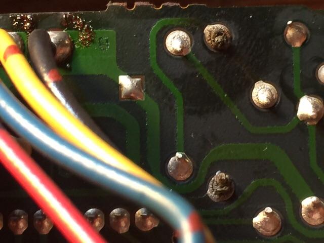

also i don't see any bulbs of any kind rdweninger :/ it has its own light source. (3rd picture)

Your clock looks a little different from the one I fixed from a 1985 GL wagon -  it had the trip computer/clock.
I think your clock has a tiny bulb seen in the second pic,  middle -right.
think thats where they vacuum seal it from the factory in order for it to glow and light up (first picture)
also i think i found the problem, white resistor on bottom right on previous post seemed to have unsoldered.. (2nd picture) so i will see what happenes now.
alright, its all good and fixed, white resistor is the issue, if it unsolders again, ill just have to replace it with a modern resistor, see if that improves anything with the heat issue.

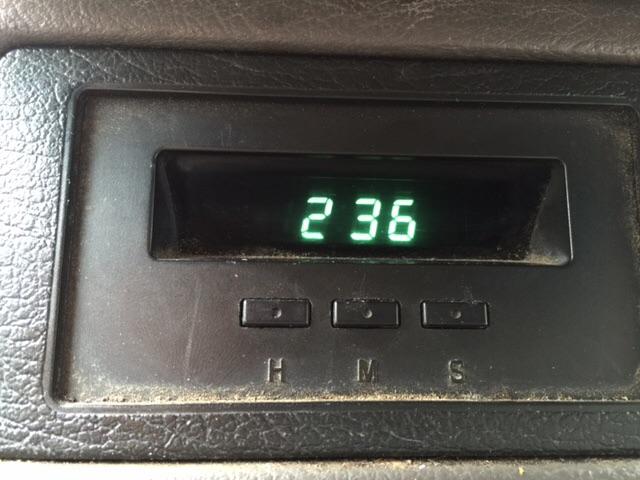

also (note how much brighter it is) looks like it might annoy me at night while driving now lol.

... looks like it might annoy me at night while driving now lol.
Nope, it will Dim when you turn on the Lights.
