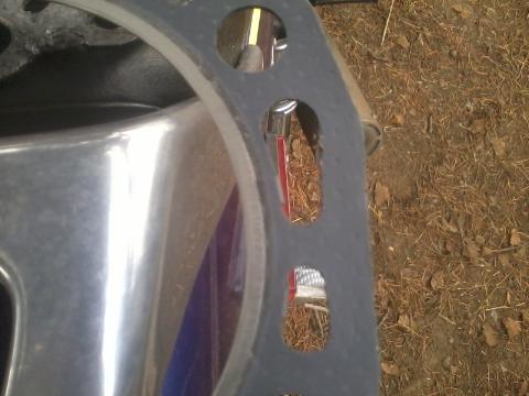

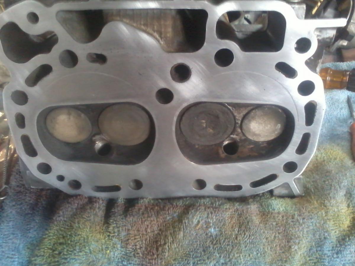

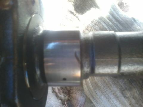

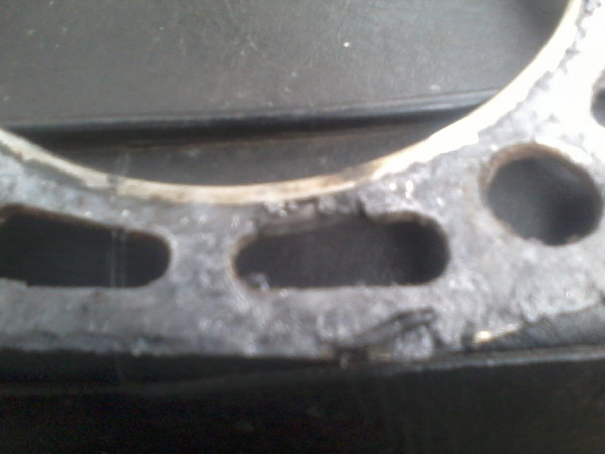

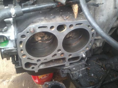

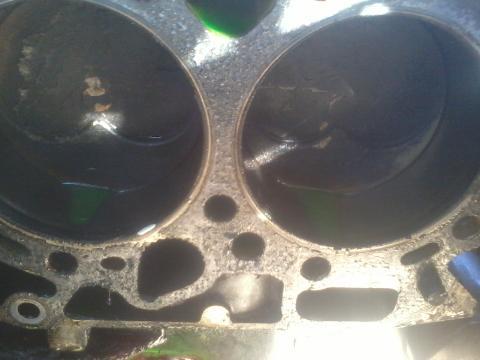

Yep Head Gasket.. I got OEM replacements. I examined and compaired.. Felpro came apart in 2 places actually one by a water jacket.. I like OEM because there is actually metal that wraps around from the Fire Ring.. So keeping coolant down/ temp @ or below half.. I'm at 165 miles on a half tank of fuel as well compression increased it's now at 180 on all Cyl. 269,129 mi. And now driver side seat belt is ... Well yA know... Aaaaaahhrrrggu! Serenity Now! Serenity Now! LOL!! Thanks for the support.. I will upload pics Sunday..
So yeah mystery Ball bearing gouged Camshaft...
And got as much of the Fire Ring out...
No real Warpage...
The other head was warped minimum 0.002 but got Fire Ring out sadley I lost that premium pic...
all seems well... hardest part..CLEANING Parts!! :rolleyes:

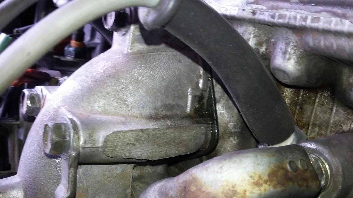

Well after having put some miles on and finally more cool dropped in the resivor and stayed at the same full line for about 6 months it moved again in 3 days almost to the bottom. I am getting a bad feeling... i had this happen before the catakzmic catastrophe of a blown head gasket.. after i borrowed out my car to somebody... not telling me what was going on they added pure water and zero coolant making my problem much much worse.I chased all bolt holes and I used some rtv sealant as during assembly just because .... i gave it another twist and got a smige of a cReEk. Intake passenger side .. what ya suby nuts think about this episode?post-44102-0-44363400-1457994930_thumb.jpg
Edited by Len Dawg
Pull the intake, make sure you clean the threads in the head really well and clean the threads on the both really well.
Light coat of silicone on both sides of each gasket.
Put her back together and you should be good.
IF it has not been run hot with low coolant, it might be only a failing intake gasket.
Get OEM intake gaskets, no sealant.  They are made almost like headgaskets, reinforced so they don't fall apart.  Are made to shift a little with expansion also.
Thanks for the replies.. I did all mentioned suggestions plus wire wheeled the bolts as well I sanded both intake and head real good and checked with flat edge and .002 blade.. good for now just weird same side same symptoms before.. I look for my other gaskets as I had ordered an extra set by miss communication between me computer and counter person LOL! then it's back to this pan again,, arrgh!
