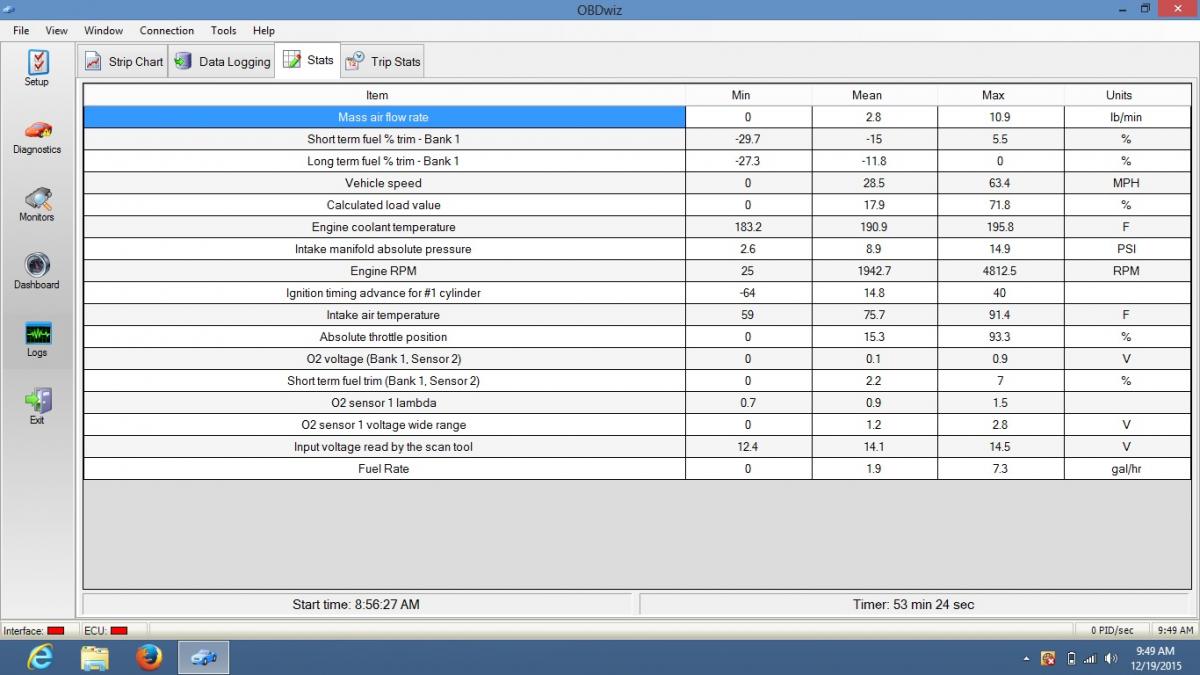

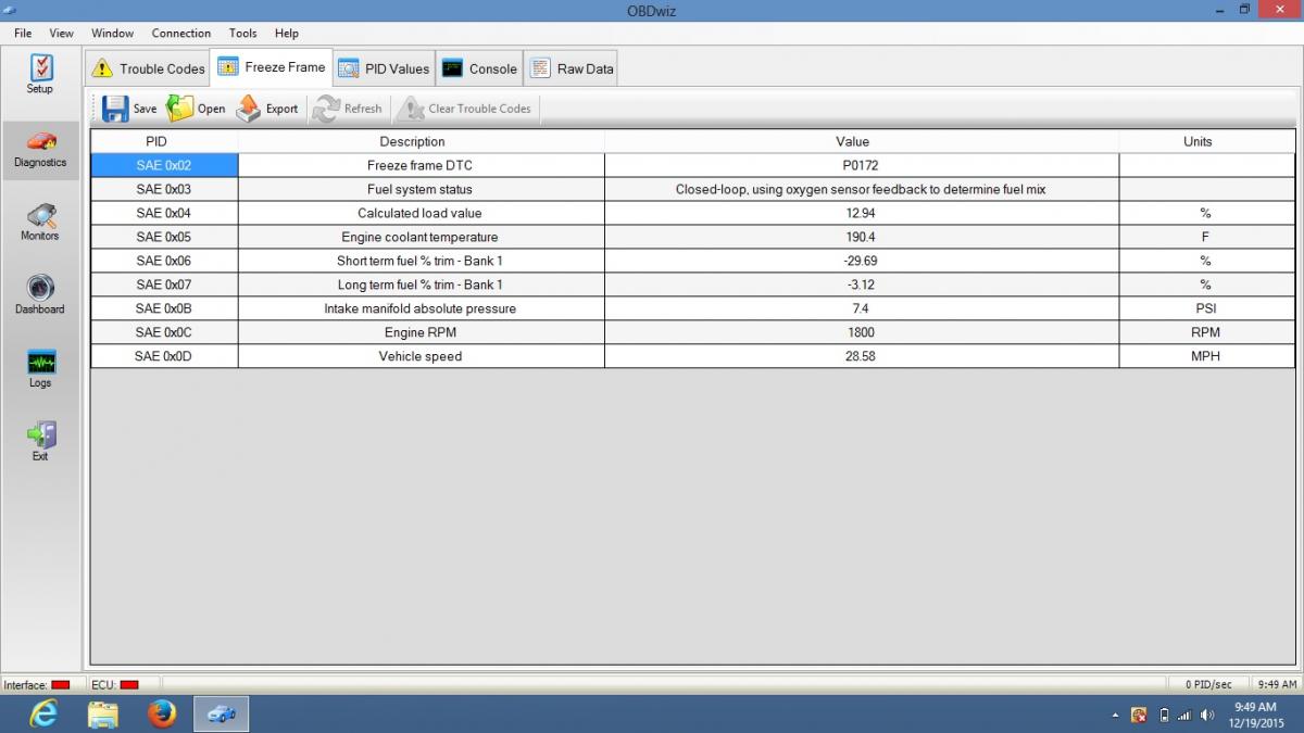

December 23, 201510 yr Just picked up a 2002 Legacy GT Limited and it drove fine for the first month then just went insane. Its bucking and stalling like mad and getting 14ish mpg. I scanned it and got a few codes it is misfiring in all 4 cylinders and running rich. Only codes it gave. I have since replaced the coil, plugs, wires, Fuel pressure regulator, throttle body, MAP, and TPS. Nothing has changed. I'm at a bit of a standstill the only things left I could find searching is injectors or the front o2 sensor. I do have a parts car an 03 Legacy L that ran amazing it just had suspension problems and no clutch. I just don't see all 4 injectors failing at once so could it be the front o2 sensor doing it? Sorry if this has been covered before I've been searching everywhere and its hard to keep track of what I have found. This is my first Subaru, I'm more of a domestic guy my other car is a 62 Ford Galaxie. I know nothing about them other than I like the car enough to try and fix it. Here are a couple screenshots of what I got on the scanner. Edited December 23, 201510 yr by Cobrae

December 23, 201510 yr I couldnt remember if Legacy had a MAF that year or not. I think the Forester may have for 99-01ish. Whenever you see fuel trim numbers maxed out all the way in one direction or the other, probably gonna be an O2 sensor problem. Can you do another screenshot at idle, and include TPS in your PID list.
December 23, 201510 yr Author Will in a few got the laptop charging. Forgot and left it in the car all night. Didn't like the cold much.
