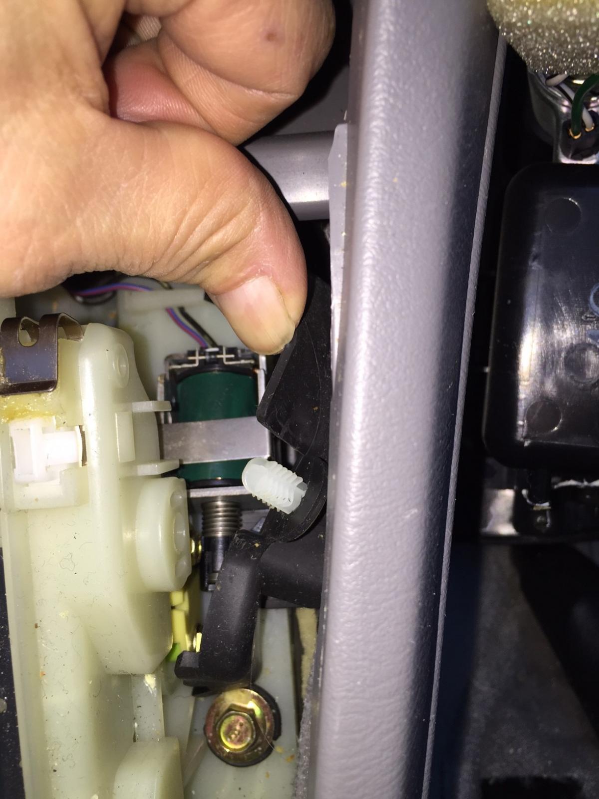

I went out and popped the panel off around the shifter---there was a little "cap" I pulled out,,,,,see the picture
This is similar to my 95 legacy
I pushed that white thing with a screwdriver and that solves the problem
It over rides the lock
So its some kind of shift lock
Not sure how to get to it underneath there or what the part is called...
Ok so you're hearing the key-lock solenoid engage, which is what prevents the key from being removed unless the shifter is in park.
You should be hearing a solenoid click under the shifter when you hit the brake pedal. I think the solenoid should be somewhere beneath the shift lock emergency release (white button in the pic), possibly under the black plastic cover on the right side.

I  popped off a few covers off and there is the culprit.....It works maybe 1/10th of the time the brake is pressed
Don't see any gunk holding it up
Was hoping to clean it rather than replace
I should probably make sure that power is going to it with each press of the pedal first.......and hope its not a deeper problem

I think it should be getting 12v. Double check that. If the voltage is low it may be something related to the remote start install.
Also Try to push/pull the lever that thing moves by hand to make sure the lock mechanism it moves freely.
Maybe give it a couple quick shots of silicone spray.

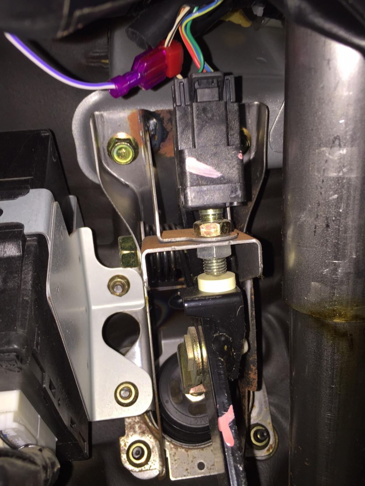

bgambino, when you step on the brake and the shift lock solenoid does not click, are your brake lights lighting up or not? If not then I would replace your brake light switch down at the brake pedal. Just a possibility.
Hey guys
I just checked the brakes lites.  When I step on the pedal and the interlock (at the shifter) DOES work....the brake lites come on
When the interlock does NOT activate with a push on the pedal....the brakes lites do NOT work
Are we sure it then is the switch at the pedal??
Anyone ever change this? location? procedure?
the mystery unfolds....
Edited by bgambino
Then a bad brake light switch it is!
Poke your head under the dash, look near the top of the brake pedal. There wil be a big switch with probably 4 wires. Generally removal is pretty simple, though I've not done one on that year Subaru so I can't give specifics.
most brake light switches you just turn counter clock wise 90 degrees and pull out of holder. reverse to install, but to get proper operation, when you install, only push switch in until plunger is depressed then twist clock wise to lock it in. be gentle doing this as the piece it locks into is a plastic part. also; the elec connector has a tab that needs to be depressed before pulling from the switch. if the tab does not depress easily push the connector into the switch then depress tab then pull apart, this removes tension from tab.

Attached is a picture of that plunger switch at the brake pedal.....now, maybe it just went bad.....but notice the clipped on extra wire----that has to be from the shop that installed the remote starter
Yet......I cannot understand how that could "stop" voltage from going from the brake switch to the shift interlock........it is only a piggyback wire it seems
Bad switch or call the guy at the remote starter shop
Edited by bgambino
Those type of connectors are horrible. They cut strands of the wire when they're crimped down. More than once I've seen those melted because the wire cant handle the current through the circuit after those are crimped on.
Possible that connector is causing your problem. Check voltage at that wire on both sides of the crimp connector and see if there is a drop across the connector.
Another thing you could do to try just as a curiosity test is when you press the brake and the interlock does not fire, reach down under the dash there and jiggle that wire/connector slightly and see if that makes it engage or chatter, which if so might just mean that wire the crimp connector damaged needs to be repaired. Of course jiggling it might also break whatever thin strand of wire is still intact under the crimp.
