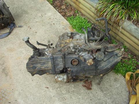

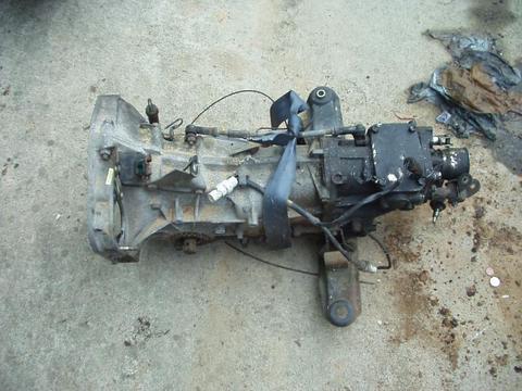

June 3, 200421 yr Author Here are a couple pics that might help. I just want to know what car these came out of & what kind of 4wd tranny it is. The engine was carbed and the two came together so I know that'll narrow it down.
June 3, 200421 yr The engine is an EA82. The carb model was installed in 85-87 model cars. The trans appears to be a 5-speed Dual Range trans. They were standard equipment on 85-89 manual trans nonturbo 4WD GL cars. So... it appears you have the engine and trans out of an 85-87 GL. The trans will bolt into any 85-94 DL, GL, GL-10, RX, or Loyale. The same goes for the engine- but- on 88+ models, you'll need to swap the intake manifold and related parts. As the manifold is already off, that's not a problem.
June 3, 200421 yr and they may be swapped in older products, ex. ea81 trans and ea82 engine go together
