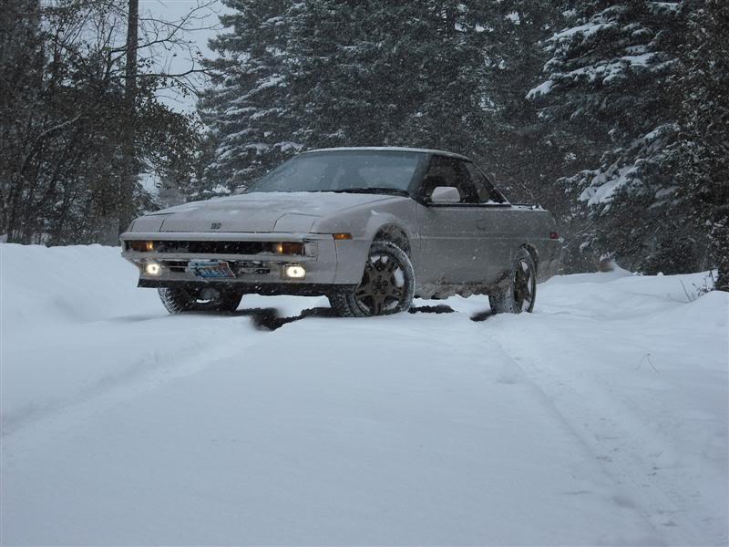

No issues if you don't mess with / modify these. stuck with the 4 stud originals + 13s
1934397_1030570381198_4050791_n.jpg?oh=c
Cool?
