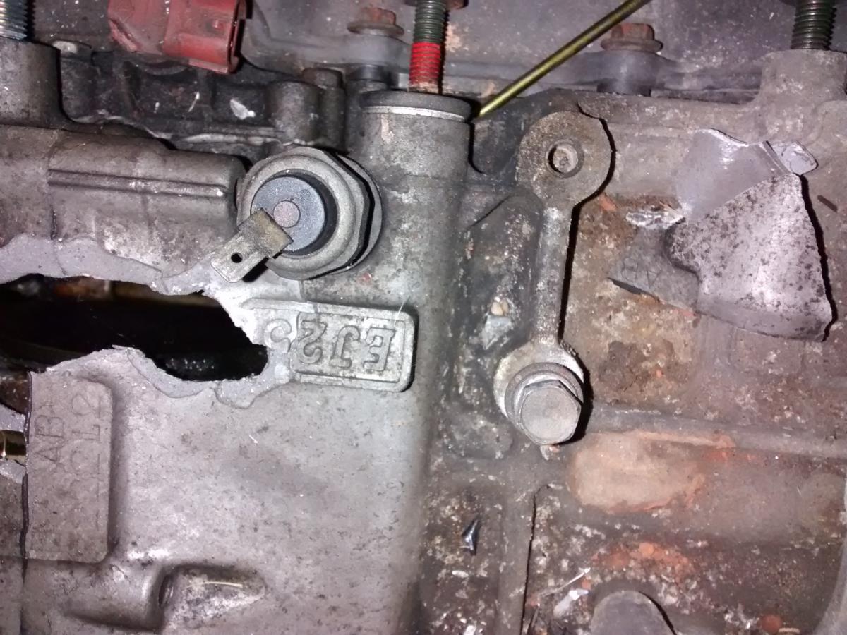

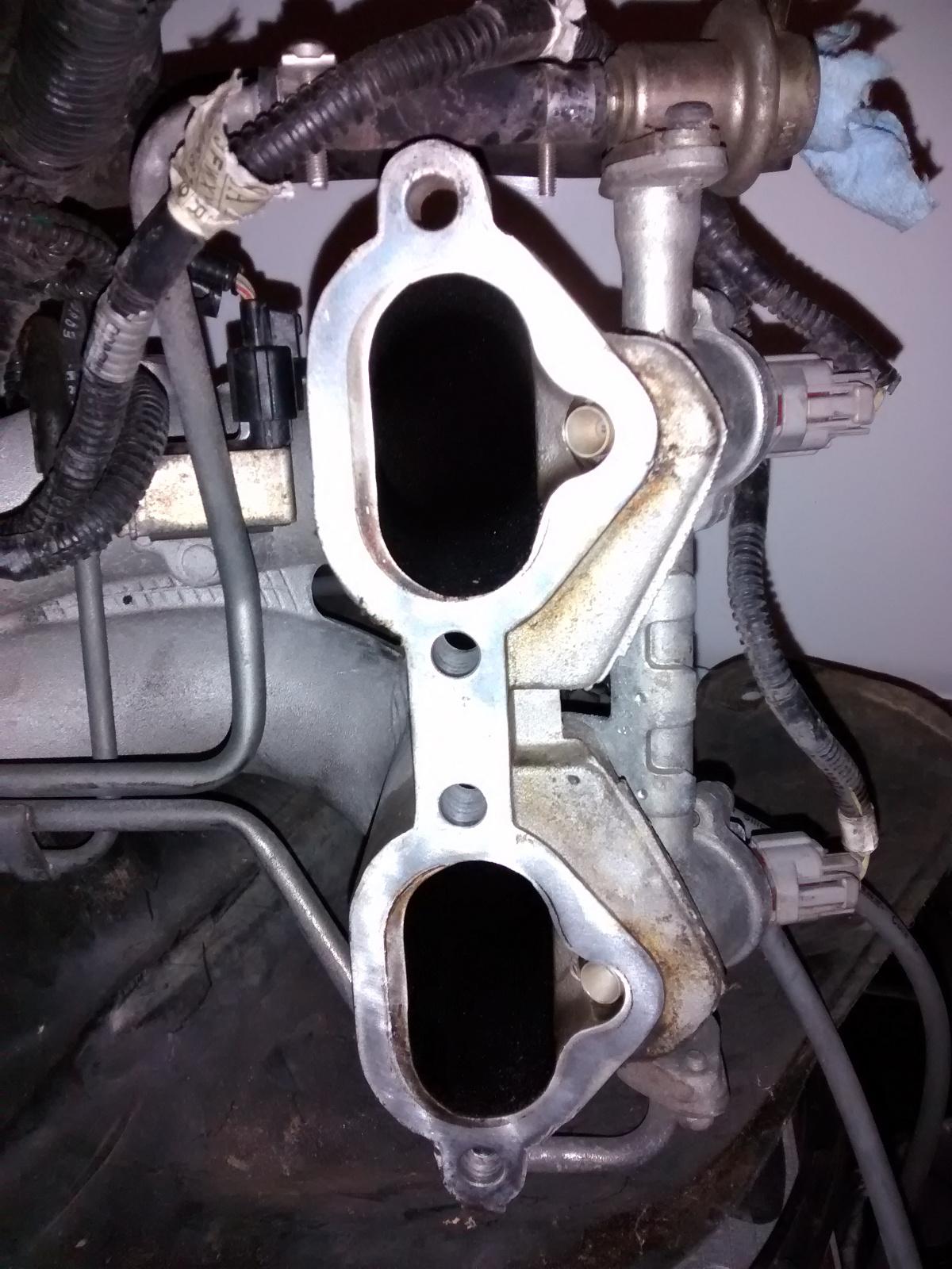

Here's the forester:
post-61972-0-43996100-1456463139_thumb.jpg   post-61972-0-39027100-1456463181_thumb.jpg

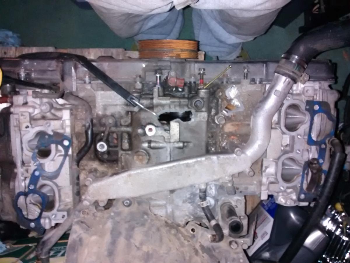

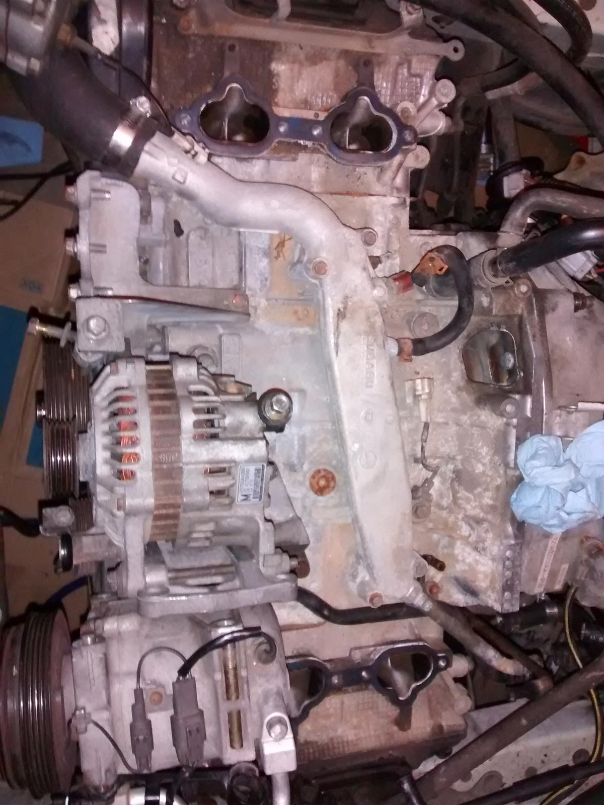

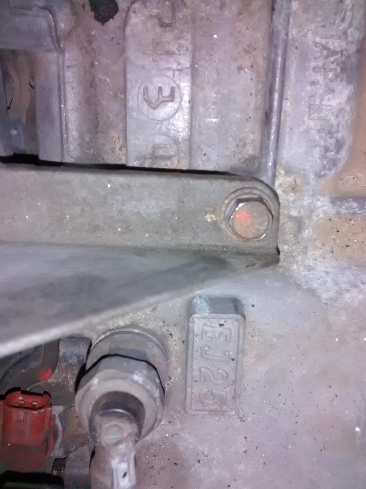

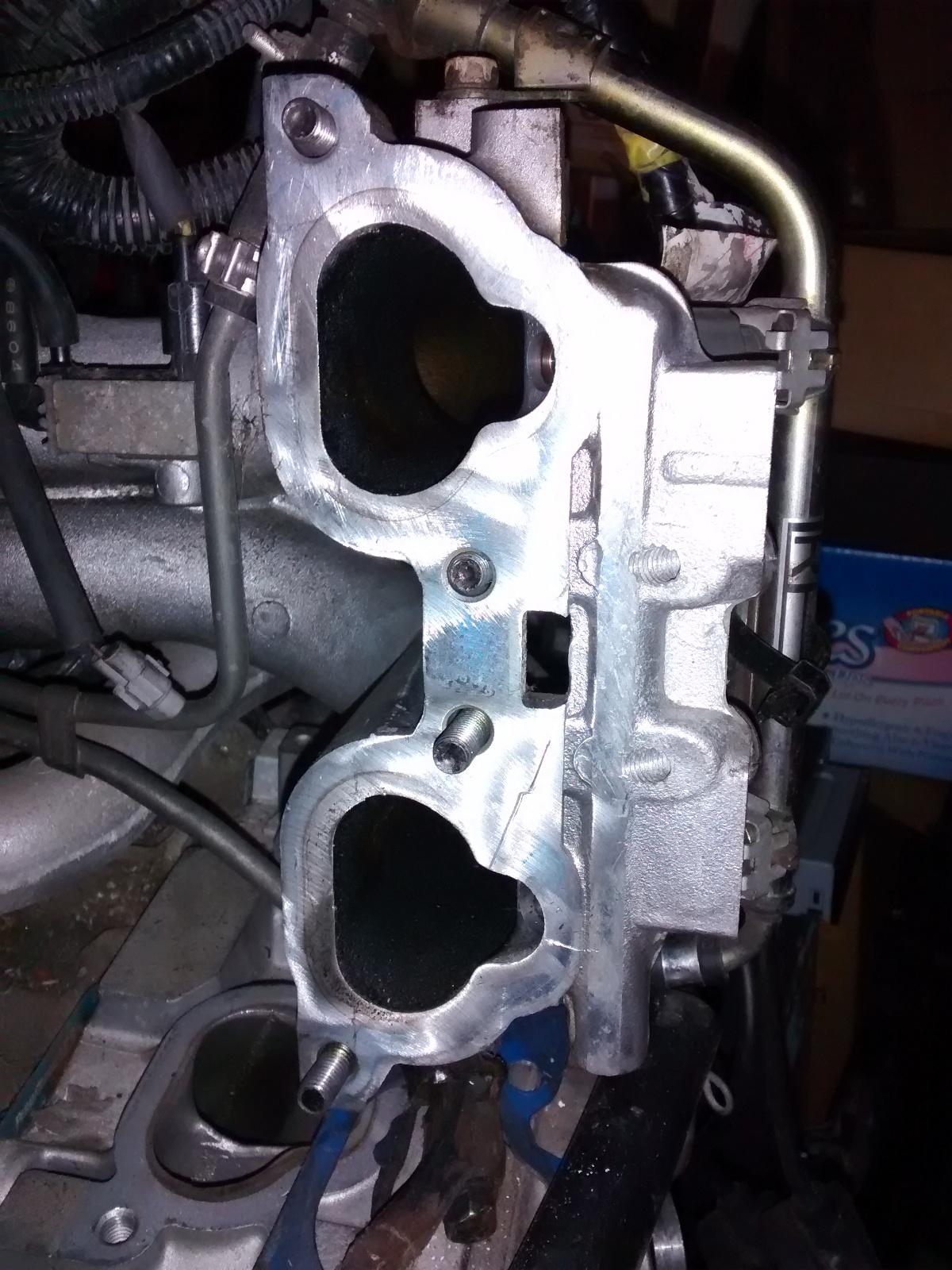

Here's the outback:
post-61972-0-27885900-1456463158_thumb.jpg   post-61972-0-77613700-1456463169_thumb.jpg
That's a 1999 Forester engine - not a 1998.  So it's Phase II and not compatible.
