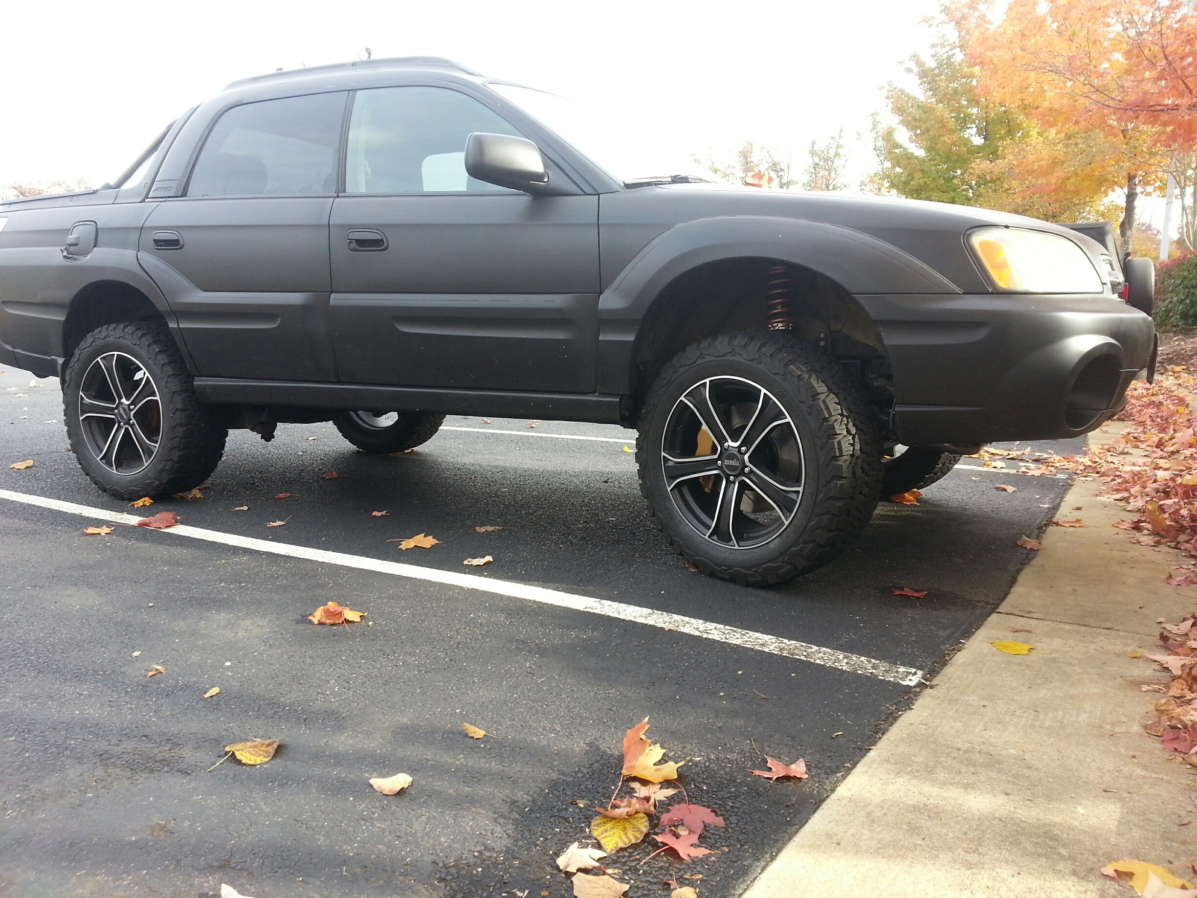

BF Goodrich AT K0-2's and I can't say enough about how wonderful they are in this size (255/55/R18), they behave like low profile performance tires on-road and are top notch off-road in snow, dirt, gravel, and shockingly good in mud.

I complete forgot about your rig...I've been using your tire calculator many many times over the last few days. Did you ever try those tires with stock struts? or just the coilovers?
Do you know the width/offset of those wheels?

18x8 48mm offset, and BTW on clearance sale now for $109!
They clear STi brakes with 20mm spacers and look like they would clear them without the spacer but I never tried. I also never tried them with the stock struts, but if it helps I would measure from the inner tire edge to the wheel well or some other reference point so you could check strut clearance.

Cool. With your 20mm spacer, your backspacing at the tire works out to be pretty close to the setup I'm looking at (I have a set of 17x7 +48s, and looking at 235/65r17 A/Ts). Ditto on the outer diameter. Due to the shape of the spring perch on the strut, I'm not sure there'd be a way to accurately measure it. I've measured the clearance from my existing tire to the perch, and it looks like it should work, but it'll be close.
Are you looking at ATs or AT K02s? I have used the older ATs and these new K02s are light years ahead of the older technology. If you do run into clearance issues you can always go coilover, they are much more compact in the perch area.
