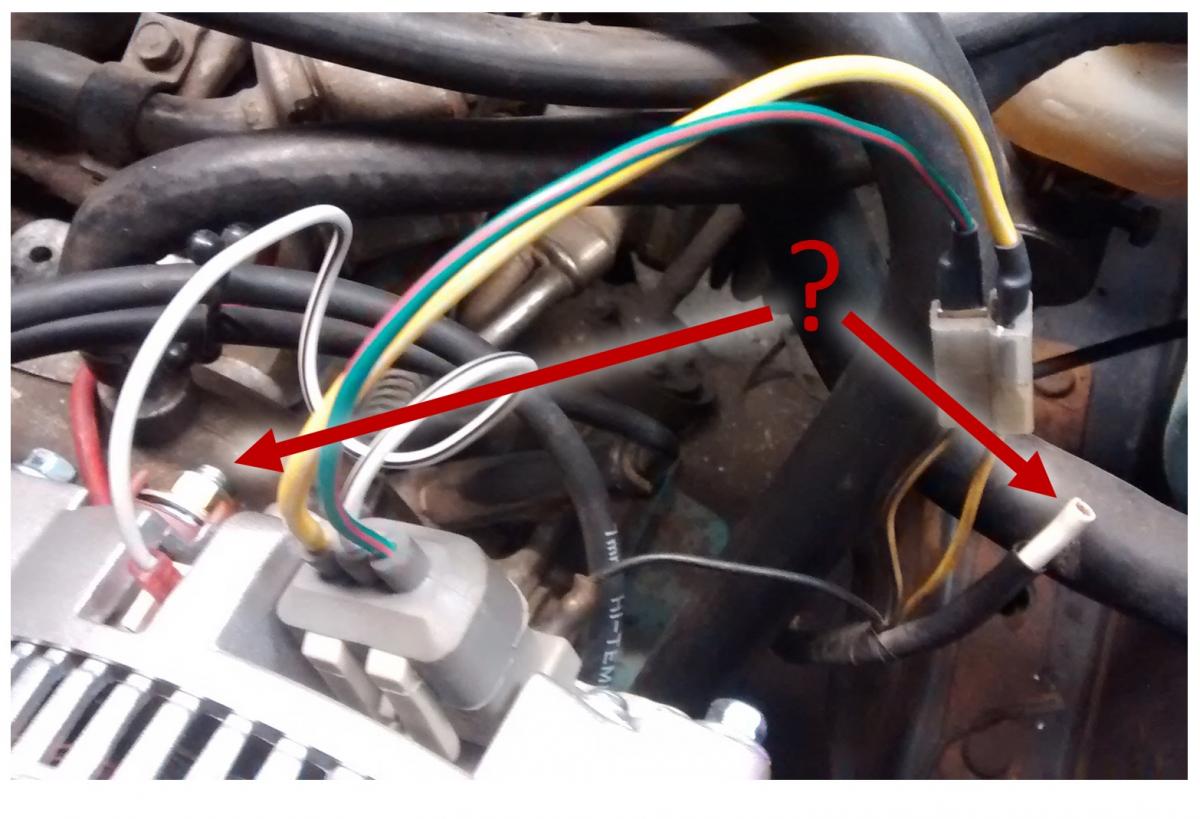

I searched and found plenty of info on Altima and GM swaps. Most are so old though, the pictures (link) are dead... But nothing on what wire is for what. And yes. Google returned some images that confused me even more. (But that's for a different forum.)
The first thing I noticed, the Subi's alternator has a bolted on wire and a plug for 2 wires. Also a separate ground wire. The new alternator off the Ranger has a plug for three wires, another plug for 1 wire and big bolt on wire. I can guess that the bolt on connections & ground are the same. But what colored (old) wires go to, what connection? And it appears I'll be a few wires short...

You will need a new heavier output wire, the stock one is too thin, and the fusible link will blow out. Those pictures look like some sort of aftermarket high output add on. To even try to figure out the control wiring, I'd need the Spec sheets with schematics and or schematics of the original vehicle it came stock in.
Lets start with the basics then; How heavy wire and fusible link do i need?
Also by the diagram in the first post it looks like (there) green wire could just hook to one of the subi's wires... Yellow or stripped?

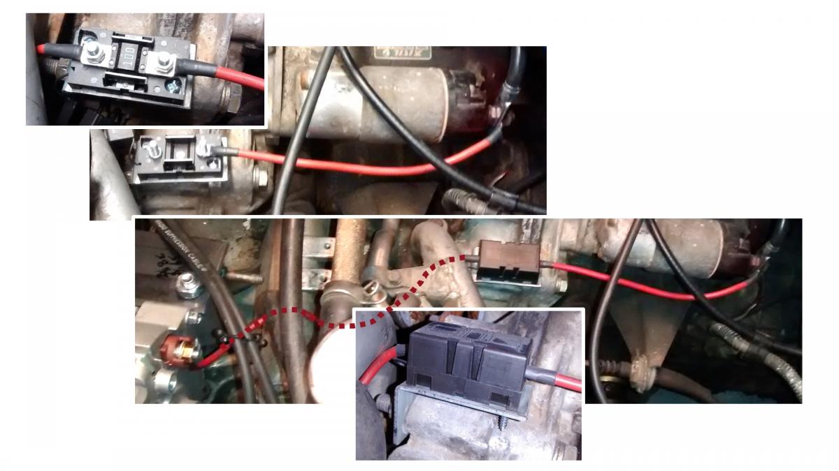

What you need to do is grab your hands on a MIDI Fuseholder and suitable amperage fuse for the output of the unit. The Midi fuses are good because they are high current handling and also the Fuseholders mount flat on a panel, and the cables are bolted down to the fuse, ensuring a good mechanical connection.
From the B+ terminal on the back of the Ranger Alternator, run an 8B+S Cable cable to the Midi-Fuseholder, then from the other side of the Midi-Fuseholder to the Battery Terminal on the Starter Motor Solenoid.

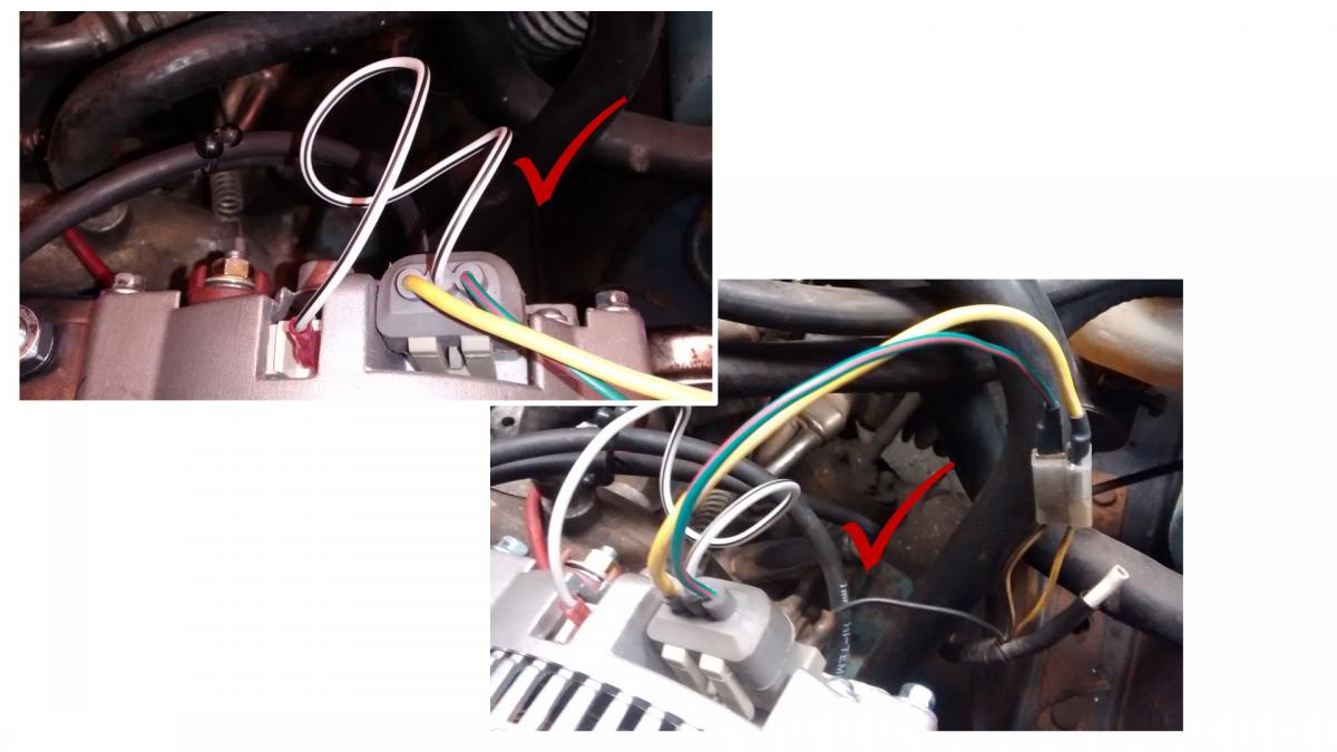

The S Terminal (Phase) needs to pick up off of one of the Stator Windings, so loop it back to the Phase Terminal as shown in the picture you uploaded.
The A Terminal (Sense) needs to be connected to the Positive Battery Terminal, not to the B+ on the back of the Alternator. The A Terminal is a Sense Terminal, and its function is to increase Voltage Output of the Alternator to Compensate for Voltage Drop down the Charge Lead (The cable from the B+ Terminal to the Positive side of the Battery). The IC Regulator won't do its job to full efficiency if you loop it to the B+ terminal, and the result could be a Battery which is undercharged, and with you guys in the Northern Hemisphere coming into Winter, that is something you don't want.
Your original Subaru Alternator has a Sense Terminal, labeled as an S. The S Terminal in the 2-pin Plug is the top of the T. So join the "A" Terminal on the Ranger Alternator, to the "S" Terminal of the Subaru Plug.
The I (Warning Lamp) Terminal needs to go to the Warning Lamp Circuit in the Subaru. The Subaru Alternator also has this in its Factory 2-pin Plug, and it is the Bottom of the T. Join the "I" Terminal on the Ranger Alternator, to the "L" Terminal of the Subaru Plug.

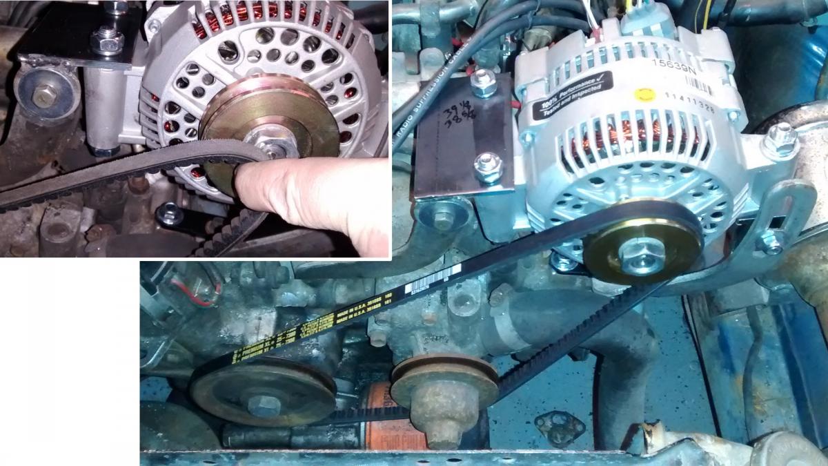

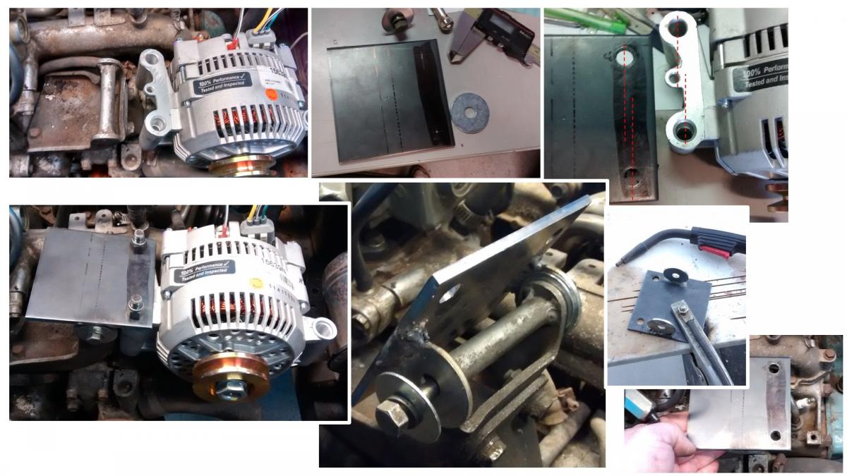

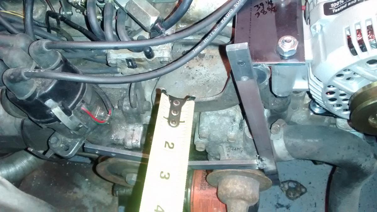

I found a steel plate at the local hardware store. It looks to be the base of a wrought iron fence. After some measurements I laid out the necessary holes on the plate. I learned that a line threw the hole centers on the alternator is not perpendicular to the pulley. That would have made it too easy. <_<
What you don't see in the attached image is; I made a jig that sat on top of the crank pulley and water pump pulley. It came up so I could measure from the pulley center-line to the Subaru mount. Then I made a guesstimate of where I wanted the plate to sit and welded 2 thick washers to it.  :D
A few washers for shims on the stock pivot bolt to help with fore & aft adjustment, a couple large bolts to mount the alternator, and it has a new home. Just by chance, the bolts for the lower control arms were laying on top of the radiator and I needed large bolts to mount the alternator... They fit perfectly.  Temporarily of course.

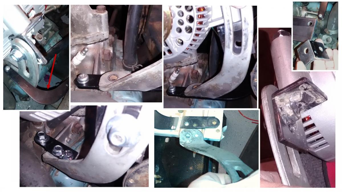

On to the alternator adjuster bracket:
Two things had to happen here. Since the new mount pushed the alternator a little more outward, I had to make an extension for it. Yes, that's the... Was the "L" shaped bracket that attached the garage door to the opener. :rolleyes: It was late and I was determined to get this thing done.
Secondly; The adjuster doesn't mate to the alternator. I had to make another bracket with along bolt to go through the alternator and a short bolt ninety'd to go through the adjuster bracket.

Thank you for sharing your experience. May I ask how is the Alignment of the Belt?

Thank you.
The alignment appears to be spot on. I fired up the motor, gave a few revs and the belt didn't jump-off... yet.
It took some time to figure out but the jig I made allowed me to square-up the crank pulley and water pump pulley to the alternator pulley. Then I made LOTS of measurements.

Oh, and because the alternator is now a bit outboard of its original location I had to get a new belt. 2 trips and 8 belts later I found that 38 5/8 inch was a tight fit but the best option.
Got it; and made an easy "L" bracket to mount it to the trans bell housing...
Ok. I'm not sure what "8B+S" is but my guess, that's 8 gauge here. Found some left over from a previous project. Done...
Easy: done...

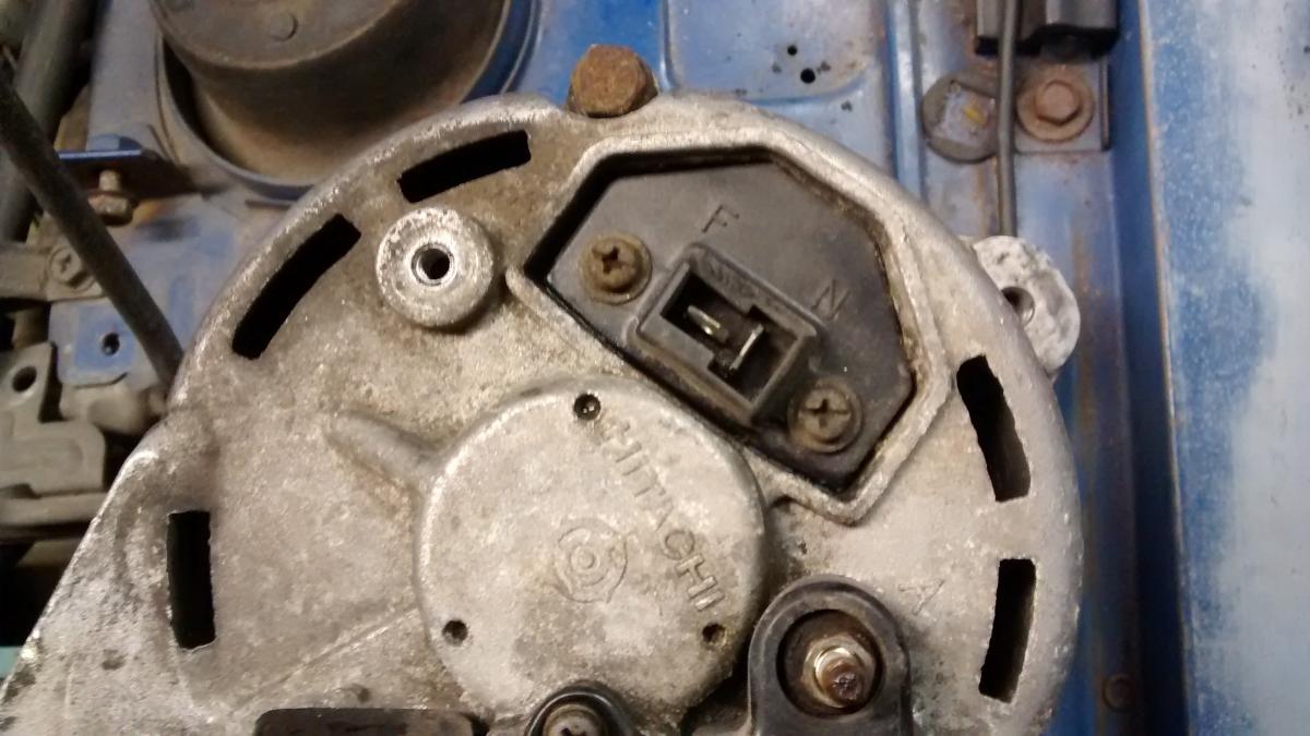

Wha? That's odd. :huh:  Mine's labeled differently than that. Top of my "T" is "N" and the bottom is "F".
Oh well. Easy enough. Done and done.

I didn't even consider for a minute that you had the External Regulated alternator, which the wiring is slightly different.
I personally havn't had an E/R Alternator on any of my Subarus so I can't give you any insight...can you please take a photo of the wiring arrangement on the External Regulator?
As the other fellas here have pointed out, there is a Fuel Pump Saftey system that is built into these cars that relys on an Induced Pulse Signal, from my experience it has been from the Negative side of the Coil, in your situation, it seems to be pulled out of a Phase of the Alternator.
I'm pretty sure I have worked it out in my head what needs to be changed, but I want to see the wiring to the E/R first so I can get it right so you don't go cursing my name as you let the smoke out of the wires...
