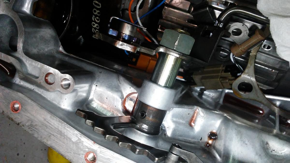

One on the right is a cv joint pin. Which someone forced into a joint that was misaligned on the stub shaft.
On the left may be a pin for the shift rail selector lever inside the trans.

I have some bad news.  I think you are right about the smaller pin
That's an automatic, he's working on a manual
Ah that's why the fluid looks red!  I thought maybe he was using some red MT fluid or something.

No that's on an automatic.
